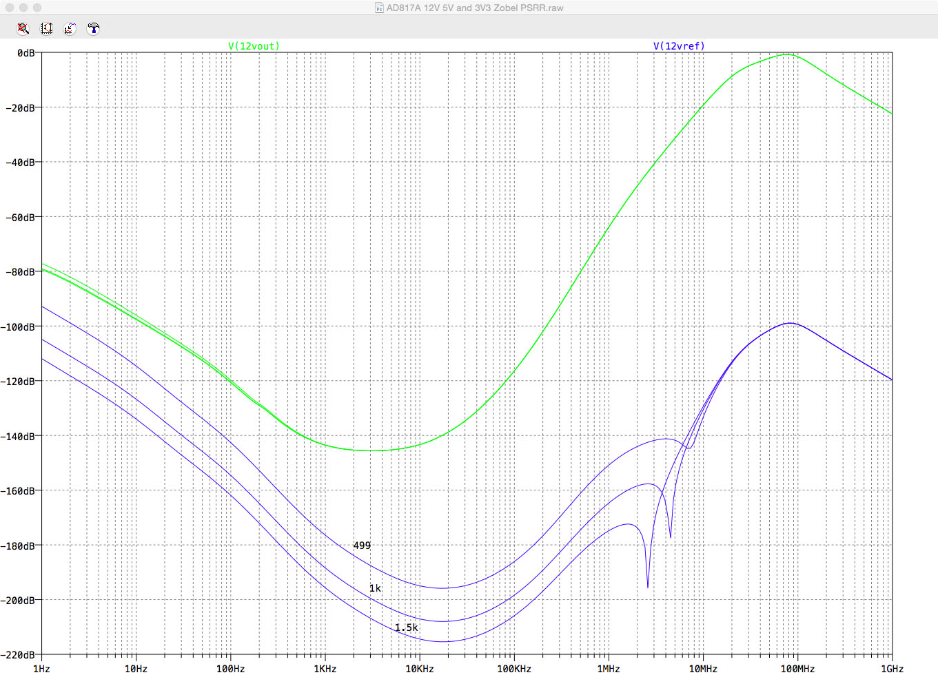

I will have a quick look at my model to see if this lay thinking is at all sensible.
Increasing R10 improves Vref's rejection but there's little flow through to the broader circuit performance.

It's interesting to look at this. Supplying Vref from Vout doesn't do much at all, but powering the op amp from Vout makes a big difference to line rejection below about 600Hz. The way I have laid out the board provides an easy mechanism for Vref and the op amp to be supplied by Vout with a single wire connected between Vout and my 'jumper' R15 (with the removal of R6 and R8). But, yes, that's for later!

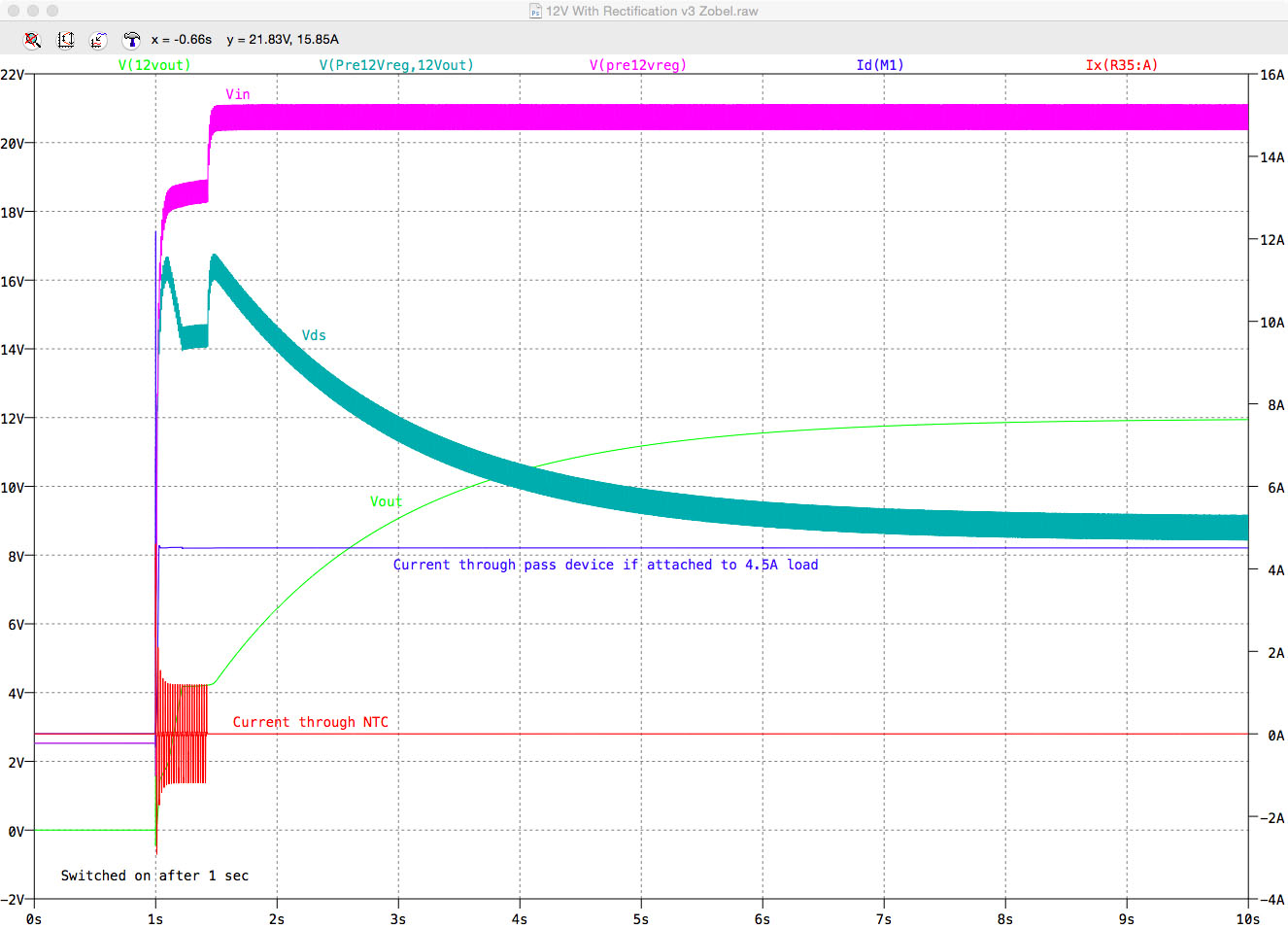

Another thought in relation to Jan's thinking - there's a lot of capacitance upstream of the pass device (much more than is behind it). It takes some time for this to charge to Vin and presumably quite a bit longer than it would take to charge the reg's output capacitance to Vout. So shouldn't Vds rise relatively slowly? The in-rush limiter also reduces Vin while the NTC is working. However if Vds is high the SOA of the MOSFET is a rather low current.
I have never been able to get to the bottom of why Vout in my 'AC-driven' model takes forever to rise - clearly a lot more than in reality. It takes about 10 seconds to reach 12V. It makes looking at these aspects via the model rather difficult. With the slow rise in Vout Vds does hit relatively high levels at peak UK mains - above 16V.

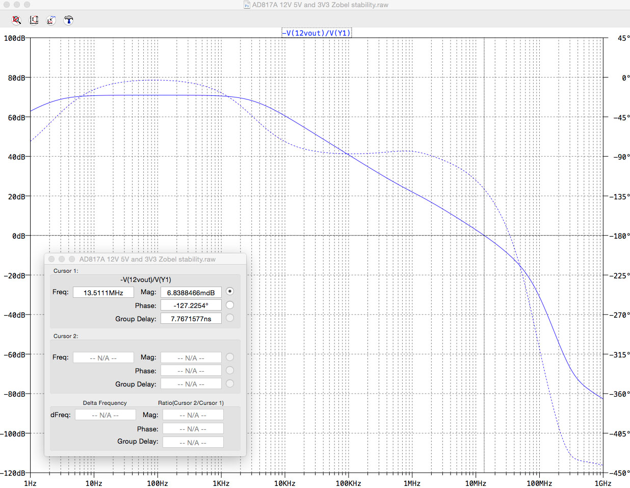

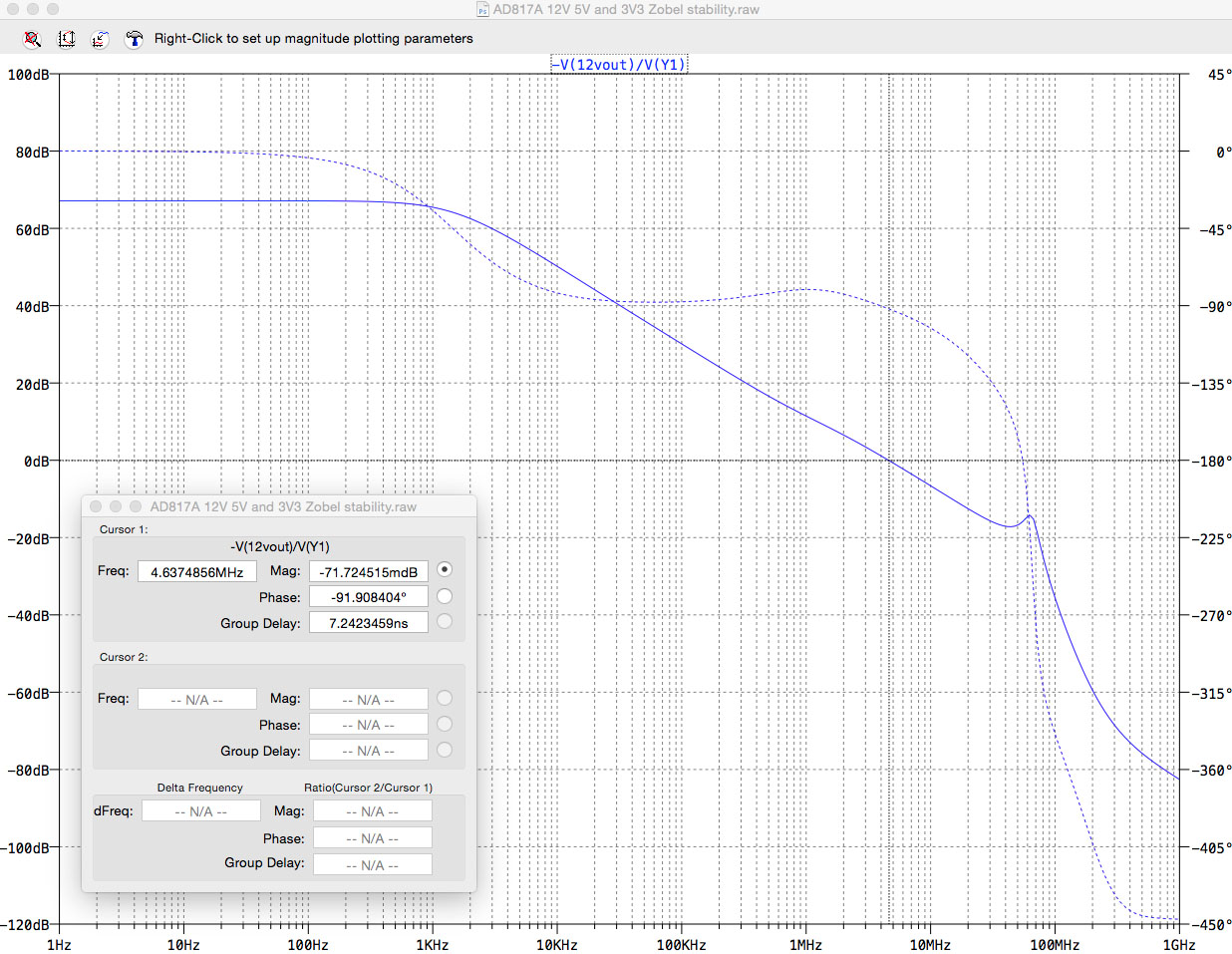

BTW I used a stop watch to measure how long it takes for Vout to come up to its stable level. The sim doesn't lie - it was much longer than I thought. I think I will halve the value of C8 when I can get hold of suitable parts.
Lastly, it's worth noting the impact on phase response and unity gain frequency of shifting the powering of the op amp and Vref from Vin to Vout. See attached.
