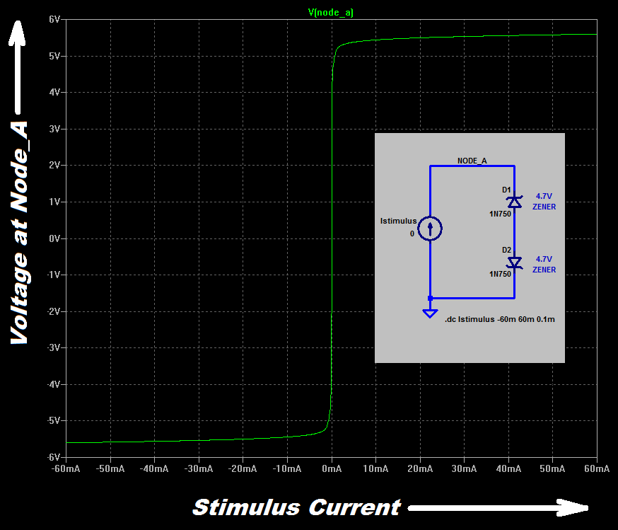

If you hover your mouse on top of the thumbnail image below you can read the filename.
_
Ok I was no thinking bidirectionally (obviously). Thanks.
I will try to work on this some more tonight, including taking Jan's advice re Q3. The zener clamp will likely have to wait for parts (unless I wanted to rig it with LM329s or attempt to use SMD parts).

The zener clamp will have to wait until you get it to work first ;-)Just hang a zener that you have around between S and G. Anything from 5V to 15V will be OK

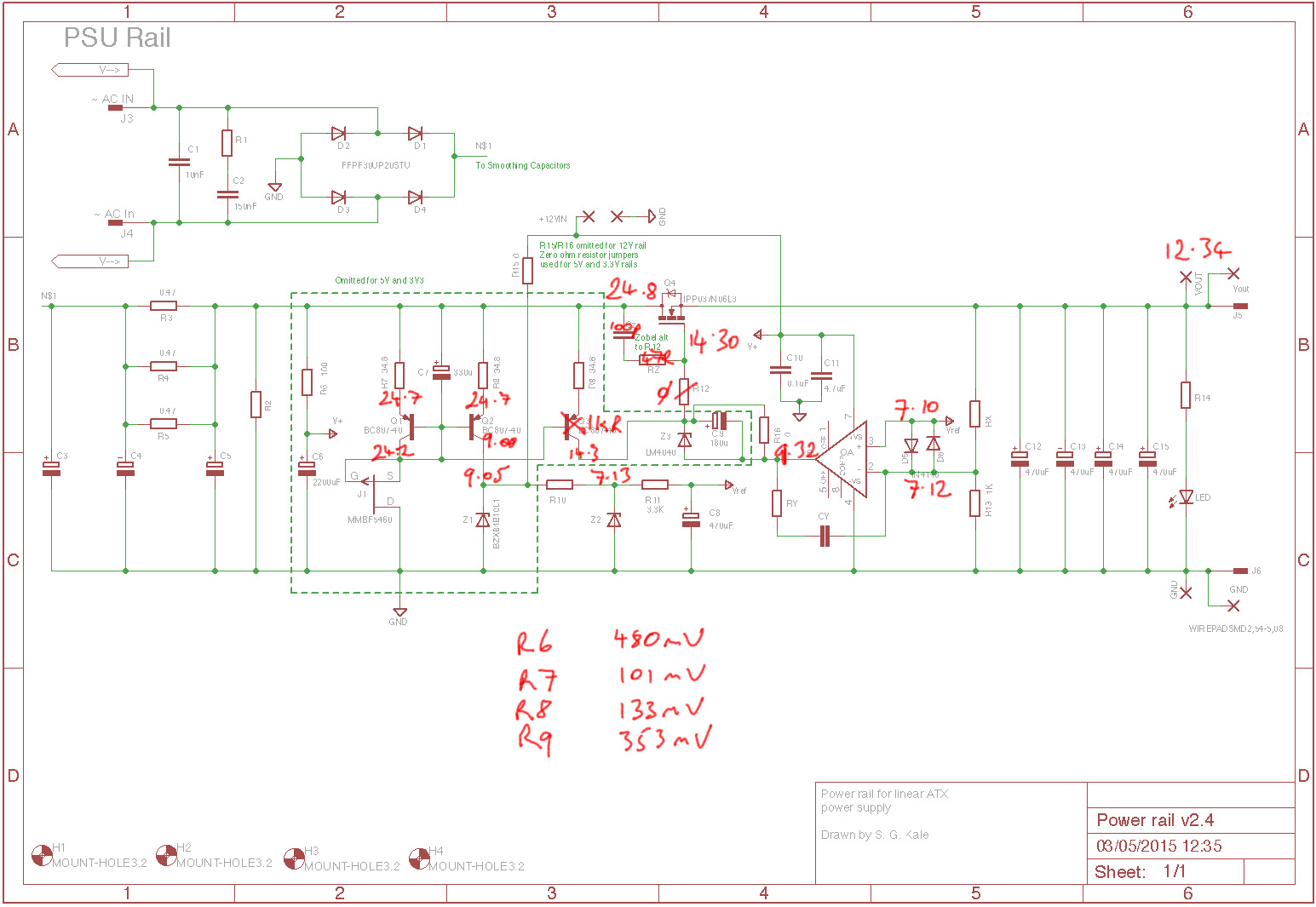

Some progress. I replaced the pass MOSFET, removed Q3 and soldered a 1k resistor over Q3's emitter and collector pads.
Attached is the circuit with voltage readings added. I used my cheap multimeter rather than scope. Note it may be reading a little high as previously I had measured the voltage at the LM329 Z2 and observed 6.95 whereas the multimeter is reading 7.13.
At least I am back to having circa 12V out now. The current source/mirror still doesn't appear to be working to a tolerance I would expect and Z1 is reading lower than expected.

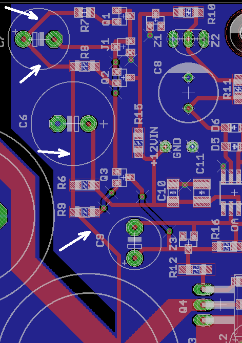

The current source/mirror still doesn't appear to be working to a tolerance I would expect ...
Hmmm, a review of the layout shows that the VIN wire which supplies all three branches of the current source, is in fact a relatively narrow trace (a/k/a copper resistor) with 40-80 squares of resistance (thus 20-40 milliohms). See white arrows in attached image.
The voltage drop along this resistor is pretty small, and does not account for all of the mismatch. If there's 5mA per leg, plus 10mA for the opamp leg (R6) that means the upstream piece of the 1:1:1 mirror {namely R9+Q3} has a half millivolt to a full millivolt more supply.
But still I'd widen it on the next revision.

With Q3 lifted there's just the Q1/J1 current source and its mirror Q2 - resistors R7 and R8 are much closer to each other than is R9.
The trace is 24mil in 2oz. I'm rather hoping not to have to do the boards again but will make the amendment if I do. ;) I would also wonder if there are benefits to using a single IC with multiple PNP transistors in the one package...
When I laid out the board, I was hesitant with regards to the routing of J1's gate and source to each of the bases of the PNP transistors, C7 and the collector of Q1. Anything wrong there or something might be improved?
Well the reg seems to work fine now, well done!
(Aside note: why no supply the opamp and the ref from Vout instead of Vin? Much cleaner supply.).
Anyway, lets now tackle the other stuff.
[And don't get distracted by the output cap - the only negative effect would be too high transient trough the *** FET at switch-on, so for the next tests you may want to lower it to just one of the caps shown.]
TBH can't see anything wrong with the current mirror stuff. The idea is that Q3 carries the same current as Q1, right?
Now that it all works, why not try to insert Q3 instead of the 1k and see what happens? But do lower the output cap value to save the FET.
