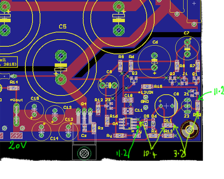

Yes it appears that despite your use of a groundplane, a sufficiently big oscillation on the pass transistor's gate can produce quite a bit of delta-V between GND_at_lower_left and GND_ar_right_near_opamp. Picture 3 of post 398 confirms.
So it seems that you will have to connect scope ground clips to the little post northeast of the text "C11", to see what's actually happening on VREF. Previous waveforms were corrupted by hash on the croc clip "ground" over at lower left.
It's beginning to appear that VREF will probably turn out to be clean, and not the source of troubles. {which makes sense, because it's the same VREF whether the load is zero or 1.5 amps}. It's beginning to look like the feedback loop containing the opamp, pass device, and other contrivances... is probably going to turn out to be the sole culprit. This will be messy to probe because you'll want to connect your scope ground clip to one place when probing the MOSFET source, and to another place when probing all other nodes around the loop.

I agree with the conclusions of post # 400. It smells like VREF is ok and what is needed now is to probe each node with respect to its local ground. For the VREF network, that's the opamp GND pin or the little post 2cm away.
I don't think you'll learn anything useful by probing the rectifiers but if you want to, I'd put the ground clip on the D2-D3 GND and then go looking around. Set the probes on 10X and start at 20V per division to protect the amplifiers. Then ratchet the gain up to make the scope trace taller.

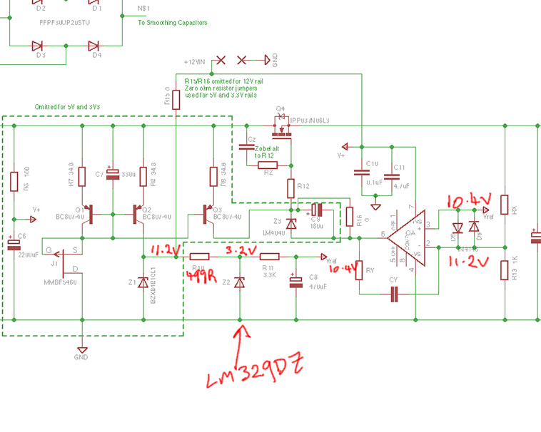

It seems the LM329 may have been the problem. See attached for measured voltages at various points in the circuit. With the LM329 in trouble, I don't see the oscillation previously witnessed on the output. Maybe the LM329 is the cause?
Before I replace the LM329 I want to double-check the pin configuration and its resistor value. R10 is 499 Ohms and my LTspice model suggests that this will mean 6.5mA through the LM329 which seems to be straight down the middle of its operating current. When looking at the board, I have the middle pin connecting R10 and R11 and the top pin going to ground.

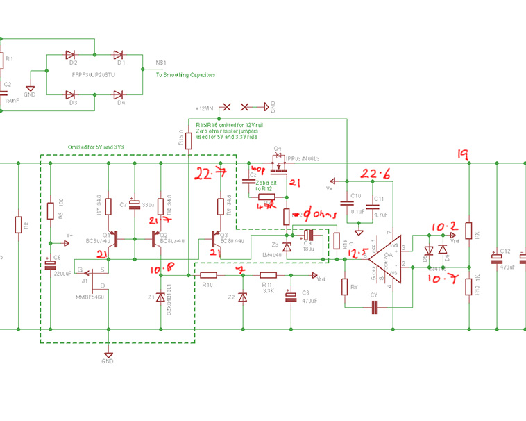

I'm going in circles with this. I swapped out the op amp to AD817A but still have the problem noted in #406 and so can't progress from there. Circuit with quick RMS voltage readings attached hereto.
Note the difference between the voltage at the +ve input terminal of the op amp (10.2V) and at the LM329 Z2 (7V). Also the difference in voltage at the gate of the MOSFET (21V) versus at the output of the op amp (12.5V); this difference should be 5V not circa 8.5V.
I presume Z3 is problematic but I replaced it earlier and hence I'm running out of confidence that this is indeed the issue. Before I try replacing it again, should I be checking other items? (Other than replacing virtually everything in one go...)

It sounds like your PJFET doesn't match (this datasheet)
Using the red numbers in post #413 we can calculate the current in R8. Then if we temporarily assume that Q1, Q2, R7, and R8 are 100% functional parts in good working order, we can calculate the current in the PJFET. It does not match the IDSS for MMBF5460. Maybe your vendor shipped the wrong devices? Maybe the PNP current mirror subcircuit contains some broken parts?
I'd remove the 1.5 amp load, get rid of the oscillation, and go probing the DC values. Compare against a simulation at the same conditions. Compare against your idea of how things OUGHT to work. Maybe when you slipped and shorted some pins, that damaged the board or some components on the board. Go looking. Trust nothing.
Q3 had failed, although in getting to this conclusion I also replaced J1 and Z3. I'm now back in business, so-to-speak. With the AD817A installed the oscillation witnessed previously is no longer there (1.5A load). I can now resume my load and transient testing. At least I am smiling again.

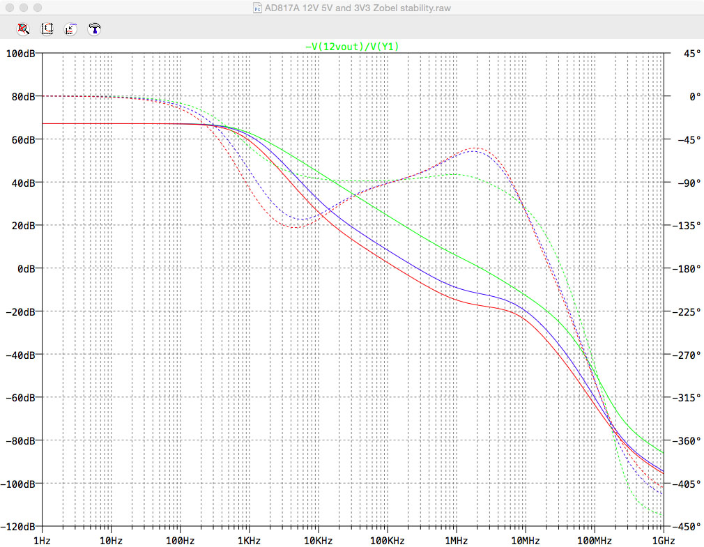

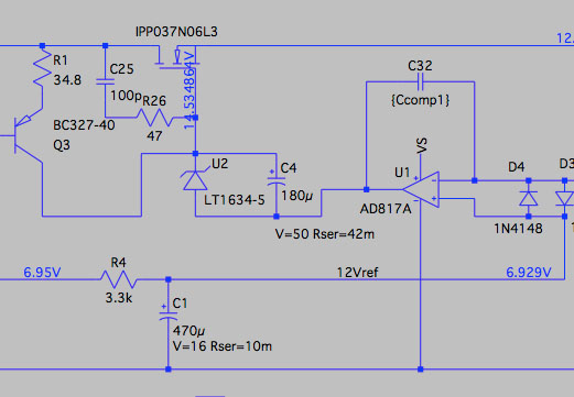

What values of those components bring the LTSPICE simulated unity gain crossover frequency down by a decade?
Question regarding this: What if lowering the unity gain crossover frequency doesn't increase phase margin?
Attached is a Spice run varying the compensation capacitor from none (green trace), to 47p (blue) and then 100p (red). Unity gain crossover frequency falls but there's little if any phase margin gain (although gain margin improves).

You are discovering that electrical engineering encompasses more than running SPICE.
I think it might be a good exercise to ask yourself "What would I do if I had to solve this problem all by myself?" Formulate a plan of action, execute that plan, and see whether you make forward progress.

With the PSU circuit board, I believed the problem had something to do with the current source/mirror - at the moment I have next to no voltage drop across R7-9 (as opposed to before when there was excessive voltage drop) - and the pathway from Z3-Q3 and Z3 to the gate of the pass transistor. My LM329 is delivering 6.95V but Z1 was down around 9V instead of 10. However, replacing the FET J1, PNP transistors Q1-Q3 and Z3 wasn't helping. I went back to the board itself. No obvious damage - pads and traces ok. I went back to my board layout file...
There's a schoolboy error with respect to Z3. I plonked down a Zener diode in SOT23 package just as I had for Z1. For Z1 it is fine/correct. But while the LM4040AIM3-5.0 components I have been fitting are a SOT23 package, the pin layout is different. I had basically connected the cathode to the op amp output and left the anode floating. Luckily it would seem that I can fix the issue by rotating the part on the board.
I'm still thinking about whether this is the full extent of the problem. Quite frankly, I'm baffled that I got 12V output at any moment previously. Currently, without Z3 repaired I have circa 14V RMS output from the op amp but 23V RMS at the pass transistor gate to collector of Q3 trace which suggests to me that more has gone wrong (perhaps because of the error with Z3) and rather likely Q3. (Annoyingly I have already blown through a very large proportion of my PNP transistors as I purchased only 10.)
Where I am particularly unsure of myself is whether I can repair things incrementally by which I mean correct Z3, test and proceed from there. Or is it likely that if other parts have failed (e.g. Q3) then leaving them failed will damage, for example, the new Z3 and hence I go round and round in circles. At the moment I think I can go incrementally.

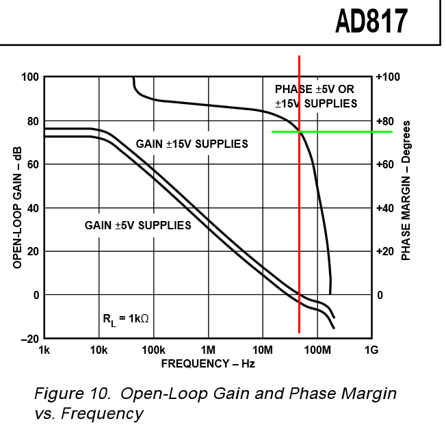

With regard to my question in #417, I presumed the idea behind the suggestion was to 'detune' the circuit so that there was a very large phase margin, get it going and decide whether to push the boat out from there. But when I looked at the model it seemed like there wasn't a cushion to be gained. Of course if the model is wrong/incomplete then it's all a crap shoot anyway and most likely detuning things at least won't make matters worse.
