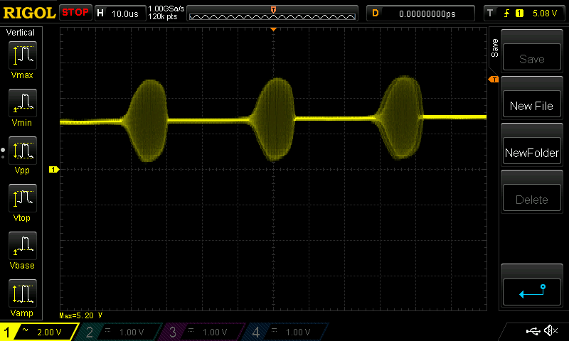

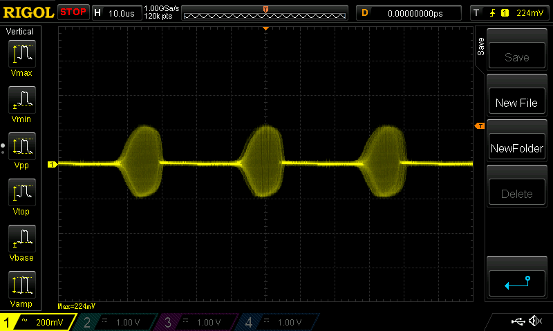

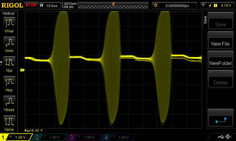

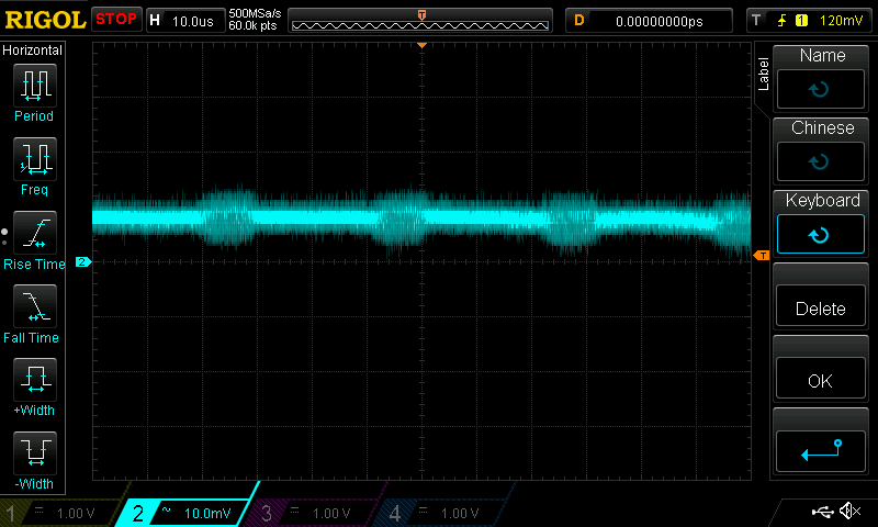

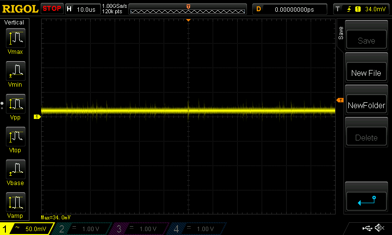

2) looks somehow OK, that is input ripple + some noise.
1) is strange completely
To be honest, I never seen such implementation … OUT from OP trough precise reference to GATE 🙂
Why you didn't change reference voltage on +IN of OP, or change FB divider at -IN of OP?

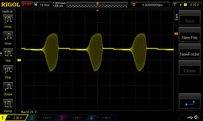

Yeah I'm sure there are many ways to skin the cat. For now I would like to troubleshoot my existing board before I give up and move to another typology.
Touching the right (input) side of the op amp, Rx and R13 seems to remove the oscillations when measuring at the input to R11.
I'd start by putting my finger on various nodes inside the regulator, while watching the scope traces.

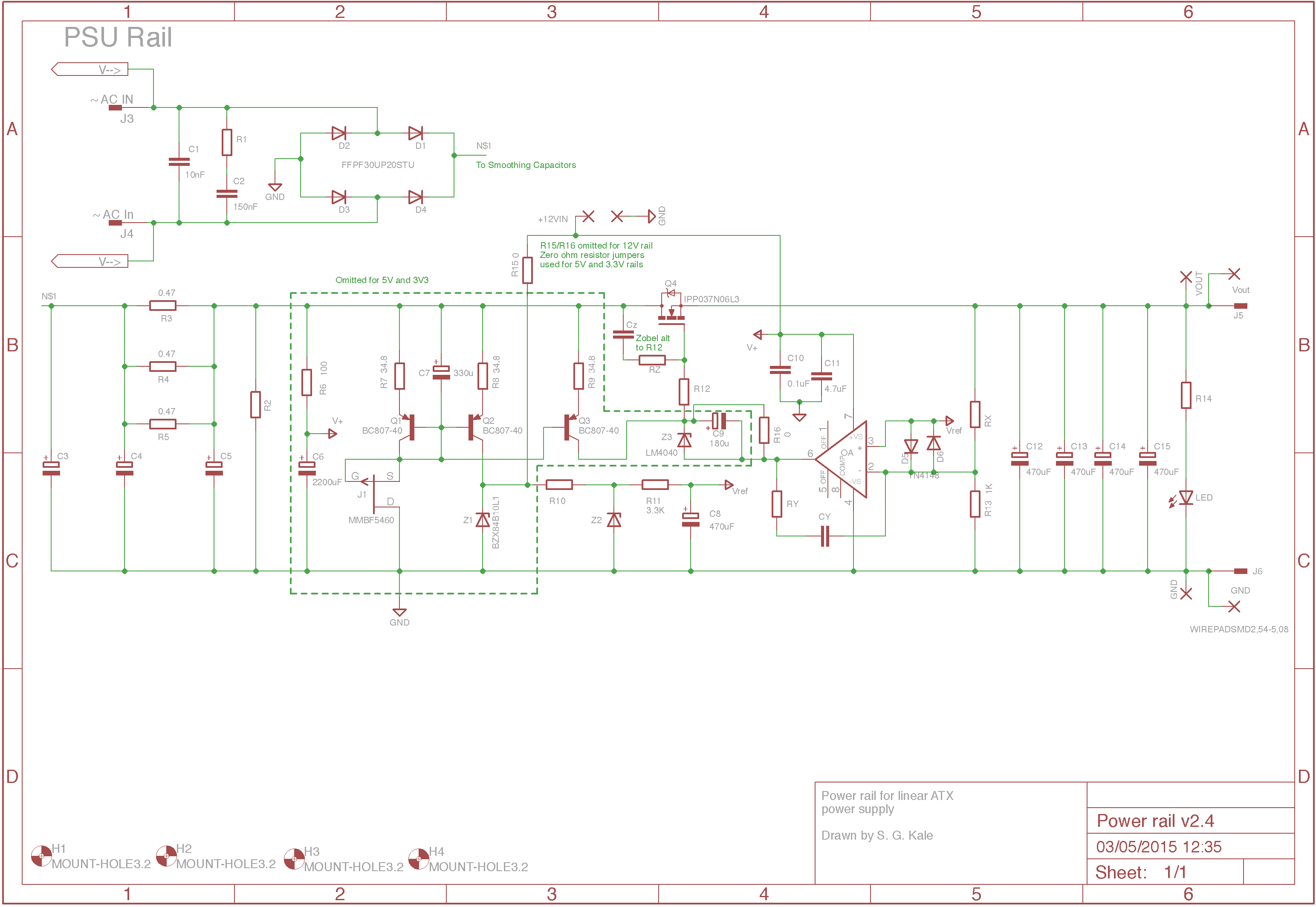

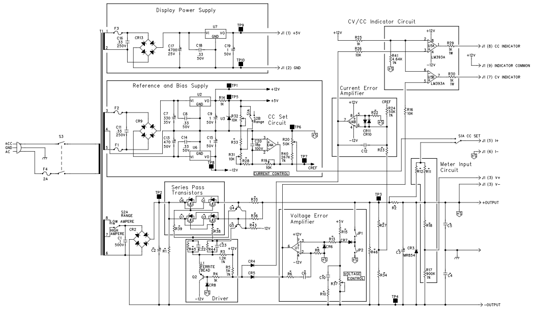

Readers don't know what Rx , R13 , and R11 refer to. Readers don't have the physical PC board sitting in front of them. Maybe the schematic from post 346 has the designators you're speaking of??? Copied below.
When tracing the VREF network, I would first look at the collector of Q2. If it is polluted with noise, perhaps that means that the R15 options (for low voltage operation) are installed incorrectly.
Then I would compare the left terminal of R10 against the right terminal of R10. Which has greater noise amplitude? This tells you whether the noise "flows" from left to right or from right to left, and helps you form an opinion about where the noise originates.
Maybe the integrated circuit superzener Z2 really wants to have a capacitor across it? (even though the datasheet doesn't demand it). Remember the good old TL431 integrated circuit superzener, its datasheet DOES show you the zone of instability. With some capacitances the TL431 oscillates and with others it doesn't. Maybe you're seeing that here. Lick your fingertip and put it on the cathode of Z2. Does the noise disappear? Aha?
It is a great mystery how there could be any AC waveform at all, across the terminals of C8. Do you suppose that C8 is not really in the circuit? Bad solder joint, failed component, etc? If C8 were good then touching it with a fingertip should change nothing. But is that what really happens? etc.

Yes - thanks (and apologies to anyone following along)
R15 is not populated in this board - it is a placeholder for a zero Ohm jumper on the 5V/3V3 boards to bring 12V to their op amp and Vref. (I needed a way to open circuit this part of the 12V board else Z1 and V+ would be connected. R16 is a zero ohm jumper for the 5/3V3 boards for when the level shifter components Z3 and C9 are not populated.)
Re R10, there's much greater noise upstream of R10.
Re Z2 (LM329) I can't reach the cathode but I suspect the answer to the previous question makes this less relevant.

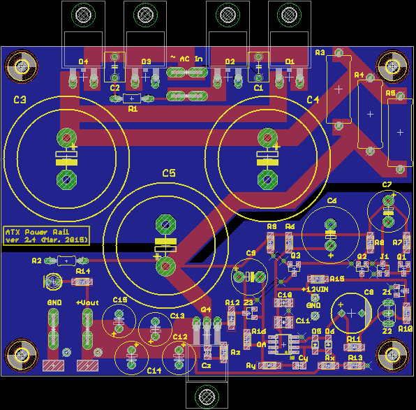

Here's a link to a high-res photo of the area of the board under question (note taken prior to realising my error re C6 and replacement of R6.

It sounds like the 10V zener diode Z1 may be the culprit. Perhaps it is being operated at a wildly incorrect current. You could measure the DC voltage across R8 to infer the bias current in the zener. Double check the resistance of R7, R8, and R9 with the ohmmeter -- maybe wrong parts got soldered in those locations. Also doublecheck the pinouts of the PNP transistors, perhaps they are connected incorrectly on the board.
You'll want to replace Z1 with one of your spares, just in case you've got a bad diode or a bad solder joint. While doing so it may be worthwhile to first solder a high value (100nF??) SMD capacitor to those pads, and then solder Z1 onto the capacitor, taking advantage of the wraparound terminals on the cap.

Check the PJFET pinout too. If it's backwards it'll squirt a firehose of excess current that gets mirrored into the zener and into the opamp output pin.
Does my routing between J1 and Q1 work? It was considered valid in Eagle. The base and collector of Q1 are tied to C7 via the gate and source of J1 rather than each directly. Only thing I can think of re the board itself.

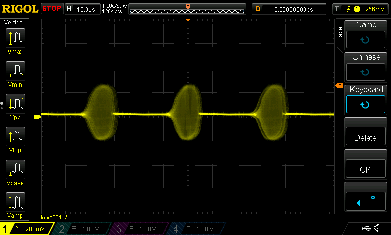

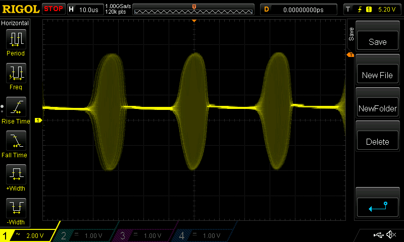

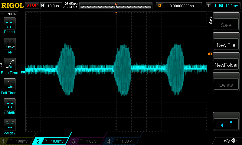

So I did the work above and the issue was still present. I decided to swap out the op amp (I will likely need the soldering practice anyway). No change. I'm wondering if the issue is much further up the chain or some sort of ground loop issue (although I'm clearly way out of my depth trying to figure this out). Here's a few pics:
1. -In of the op amp (or right side of Rx)
2. +In of the op amp
3. GND pin of the op amp
4. Top side of R9 or drain of the pass MOSFET transistor
5. The GND pin hole in the middle of the lower right quadrant of the board
All taken with the scope probe crocodile clip attached to the GND pin at the output caps.

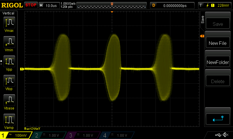

I just realised that when I switched scope probes I had the probe at 1x and not 10x when doing the prior tests.

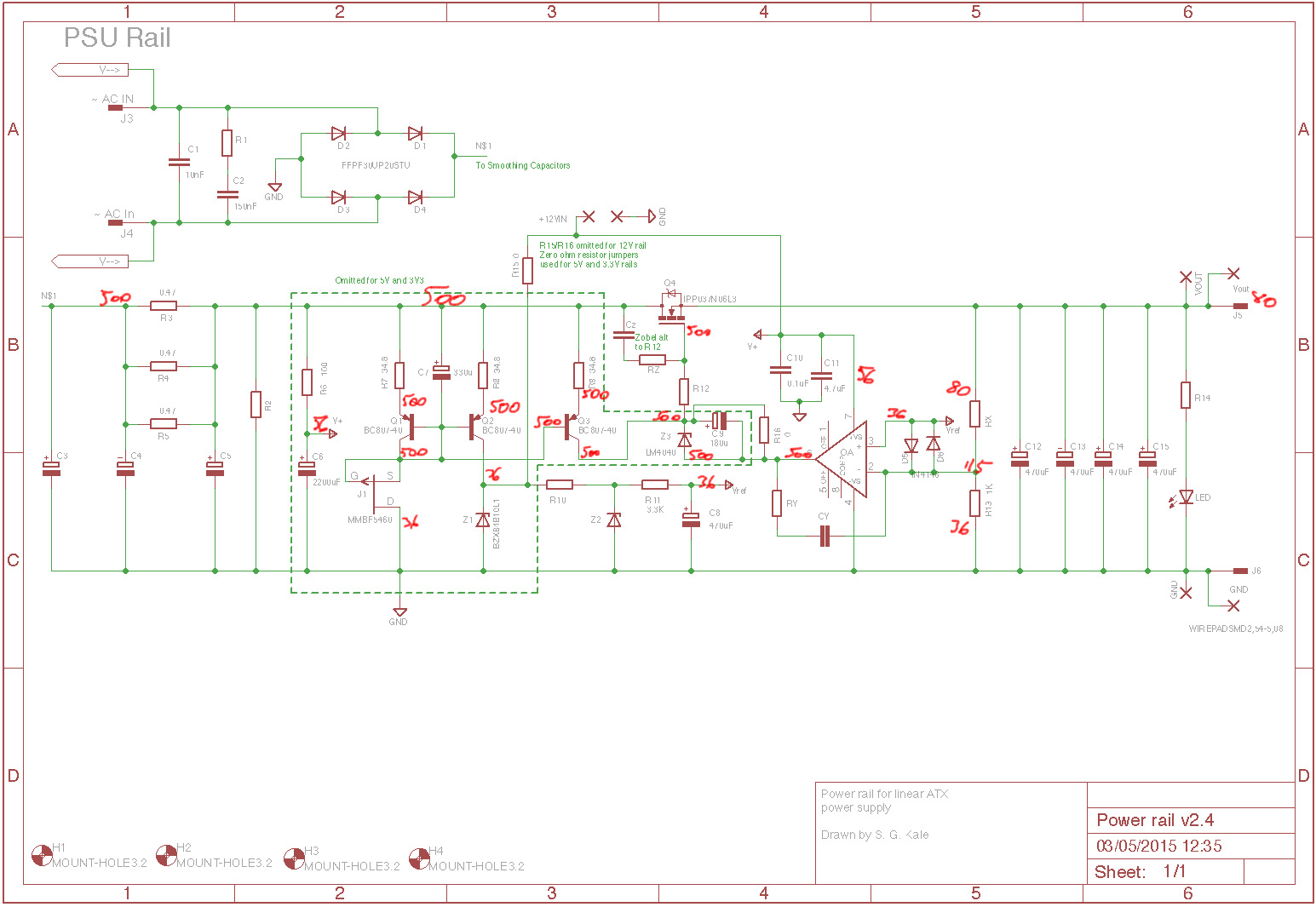

I also tried to do a quick 'heat map' using the scope to take quick max voltage (AC coupled) readings at various points in the circuit. Of course, there was a lot of variance at various circuit points and points of time. So "500" (mV) was anything between, say, 430 and 540. These were quick measurements with the probes alligator clip at the output GND test pin. I'm not sure if these are helpful but it would seem Vref and Vs to the op amp are functioning ok and the PNP transistors don't seem to be the source of the problem.
What's the correct way to probe the rectifier diodes?
