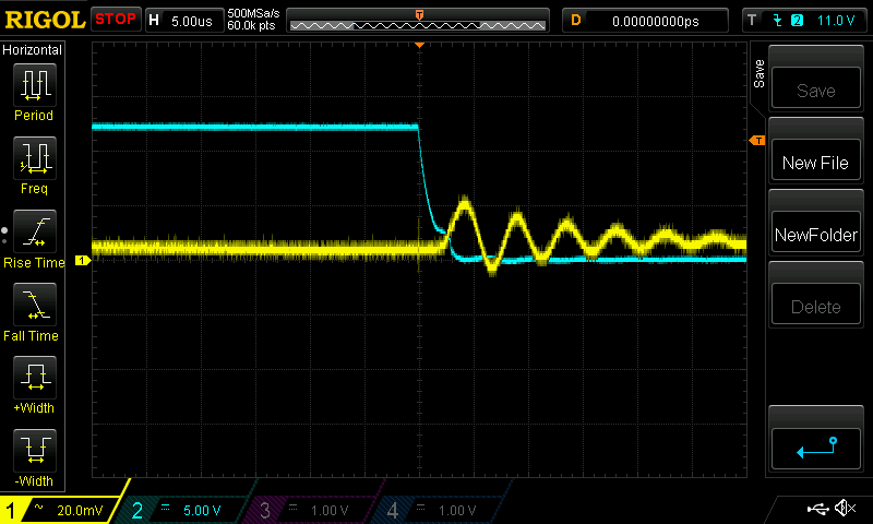

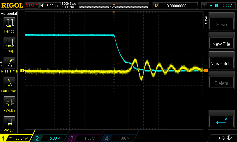

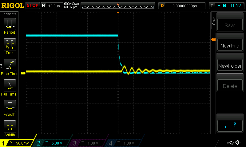

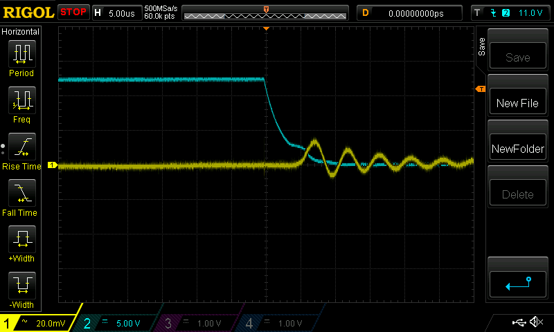

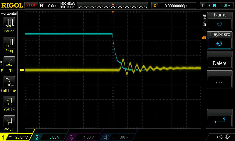

So.... I added the pot between the gate driver and gate of my chop chop box. I dialled in enough resistance to visually slow the rise/fall of the gate voltage to 5us and later 10us. (I was probably a little light on the former. There's probably some function on my Rigol scope that would compute and display this info more accurately.) Also, I perhaps should have tested a more extreme difference between the two.
Nonetheless a new set of scope shots. All falling edge as that was most pronounced. All taken at the output of the regulator (pads under the fasten connectors). First pic is c5us fall time shown at 10us per division; second pic at 5us per division. Third pic is with the gate voltage falling over circa 10us shown at 10us per division, 4th at 5us per division.
I estimate the frequency of resonance to be about the same in both cases (I get circa 260kHz). Adding more resistance in the gate stopper increases the damping. If this is the chop chop box I ought to be able to relate the frequency back to typical component values for R and C at least...

A net increase in resistance for the total circuit ought to increase the dampening of the RLC resonance.
FWIW I realised I was making a mistake when estimating the frequency of resonance above. I now estimate circa 215kHz which agrees more with Mark's initial estimate.
I also realise that when looking at the stimulus rise/fall time I'm looking at Vgs of the STP27N3LH5 of my chop chop box. A very good portion of this movement doesn't alter the current flow in the circuit because it is still more than enough to allow 1.5A to flow. So I haven't slowed the rate of change in current anywhere near as much as initially thought.
