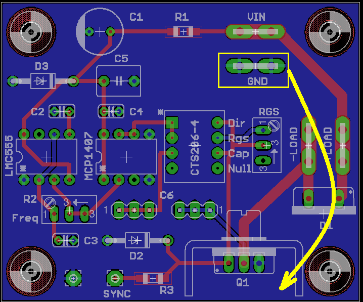

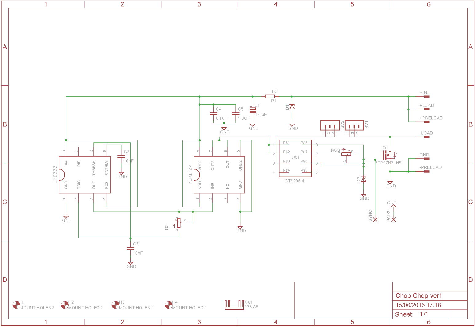

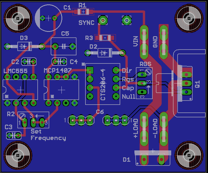

FWIW I decided to spend an hour or so laying out a small (5x5cm) board for the chop chop circuit. I added a dipswitch to be able to opt-in a trim resistor for the MOSFET gate and / or a cap from drain to gate. It is still powered by the supply under test. I added protection diodes for the supply to the LMC555 and MCP1407 and MOSFET gate. Images of first draft attached. Any comments/suggestions welcome.

Yikes! D1 is on the wrong side of the series resistor. If VIN > Vzener then Infinity amperes will flow in the zener. This protects the rest of the circuit but only until the zener melts. If you move D1 so it is in parallel with C4, now only (Vin - Vzener)/R1 amperes flow.
You might also consider using an LM7809 series pass voltage regulator instead. This bumps up the component count from 2 (zener, R1) to 3 (7809, input cap, 1.5K load resistor to guarantee 6mA min). I'll bet your MOSFET's Rdson is plenty low with a Vgs of "only" 9 volts.
Or you might consider using a 9V battery. The fewer wires between PSU_under_test and chopbox and BigLoadResistor, the less thinking and circuit analysis you have to do when you see the oscillatory ringing. Hmmm, is the inductance of the Vsupply wire significant? Must I model it? Hmmm
edit- maybe your load resistor is inductive or maybe the wires to it are inductive. maybe this might create a flyback pulse when the MOSFET switches off. maybe you might want flyback protection. as I recall, Elvee's chopbox used a super high VDS rated MOSFET and a rather high voltage MOV lightning arrestor to ground, to protect against flyback without polluting the supply under test.
Oops. I shuffled the series resistor and filter cap around at the last minute and missed shifting D1 also.

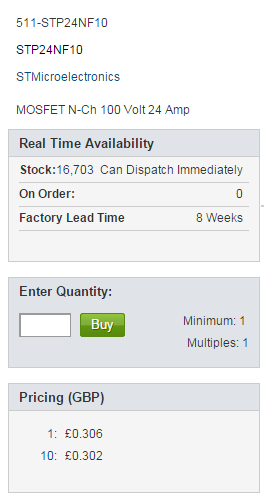

You could explore TVS diodes to ground as alternative flyback pulse swallowers, they seem to be optimized for incredibly fast turn on and incredibly high peak currents, at the expense of loose tolerances. Mouser part number 576-SA33A might be a good place to start looking ... it will take you to the TVS subsection of the site, where you can browse all their offerings. Guaranteed 54V clamping, guaranteed 9.6A surge current ought to be plenty good enough to protect a 100V MOSFET driving 5A into an inductive load.
This MOSFET gives similar performance at VGS>6 but has greater VDSmax, so it can tolerate a bigger inductive flyback pulse.

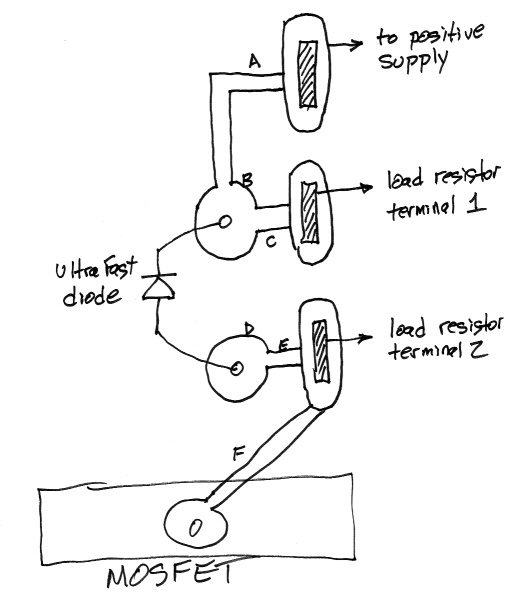

Or you could use the standard Ultrafast Diode To Supply circuit design and just perform careful PCB layout such that the flyback current loop is small and tight, whereas the current path from load resistor back upstream to PSU board is longer and less enticing. {like a Kelvin connection} Either PMEG45A10EP (SMD) or BYV10X-600 (thru hole) would be good diode choices.
Or put on belt and braces & do both. High VDS MOSFET and low Vclamp diode across the load resistor. Now you don't have to ramp up to speed on Transient Voltage Suppressors or Metal Oxide Varistors.

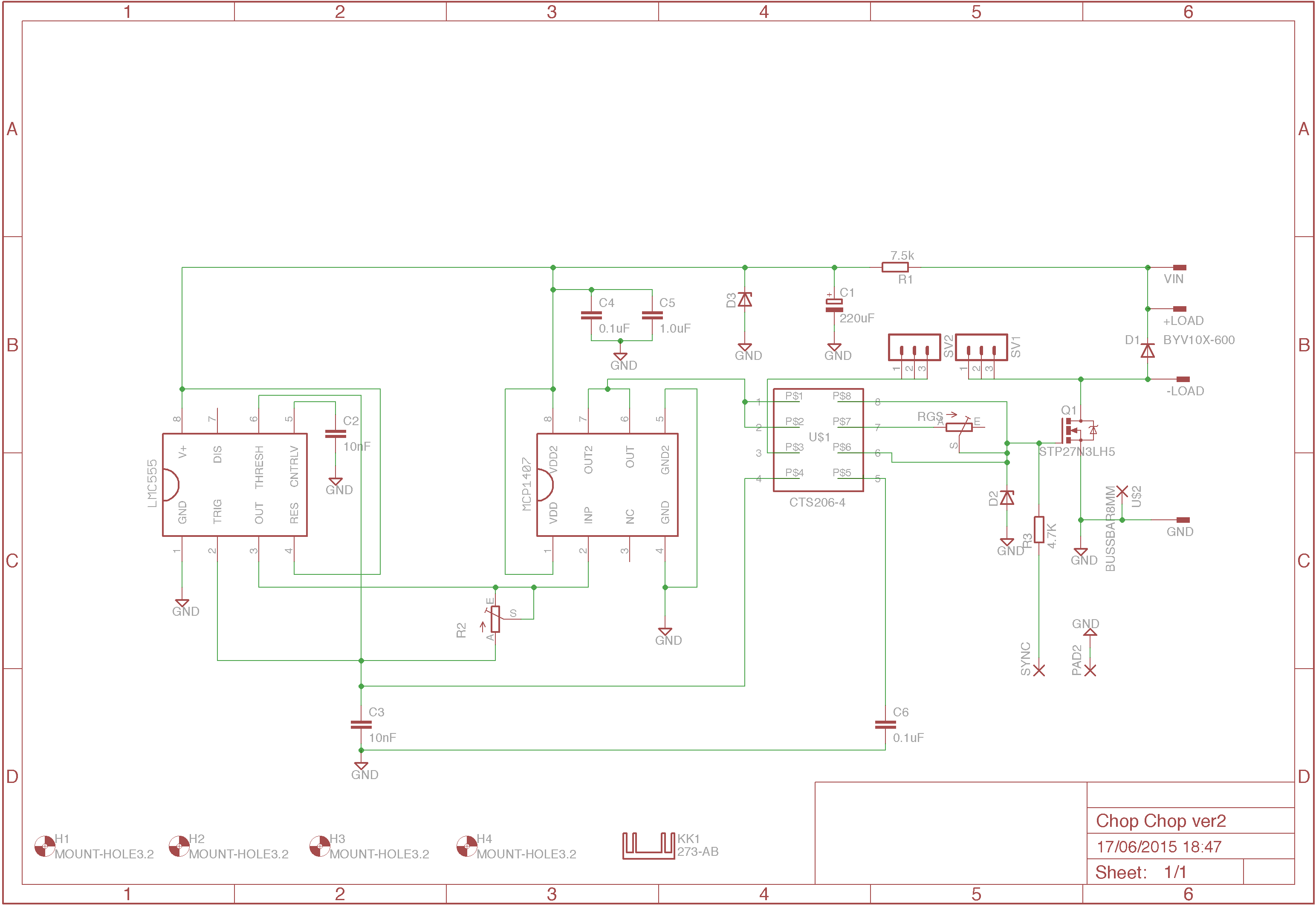

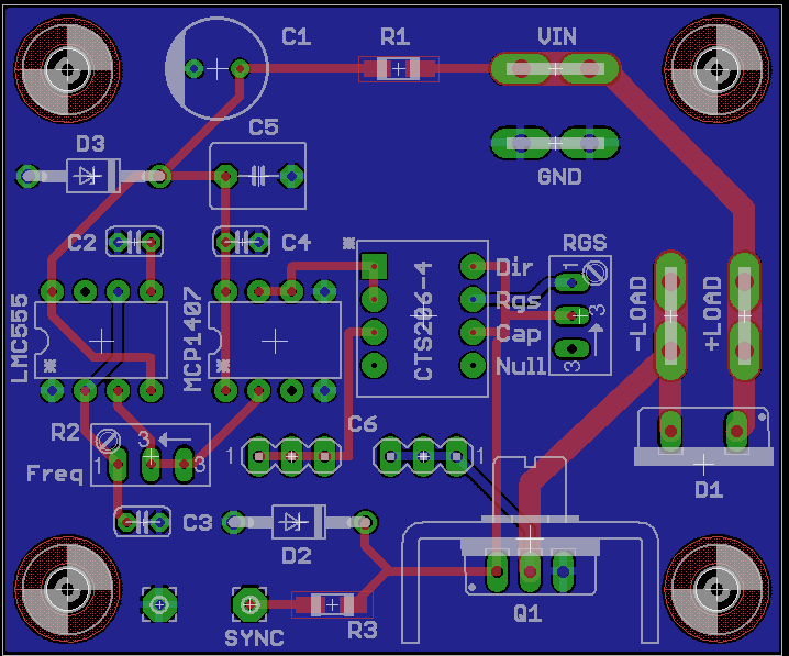

Thanks a lot. I guess if I am going to take the supply to the board I may as well power the board from it. How does the attached look? Would the diode need heat sinking?

Revised version. I added a GND polygon on the top layer from FET to I/O gnd. This is in addition to the path on the bottom gnd pour. I'm wondering if it is better to reduce the size of the bottom pour (pull the right boundary left) so that the top polygon is the only path from FET to I/O gnd. (The bottom gnd pour has thermals but the smaller top polygon does not.)
EDIT: position 4 of the dipswitch might even be used as an on/off switch...

I suggest you give serious thought to creating a PCB "footprint" of a one-terminal component called "BussBar001". This goes on the non-component side of the board between the FET source and the GND connector blade. It is a pad .195" wide and just the right length to almost reach from FET source pad to GND pad. Then wire them all together with a big fat trace / GND fill.
Why is it .195" wide? So you can solder a great big ole bohunker piece of copper braid to it. The copper braid is .145" wide, giving .025 surround (margin for placement error) on either side. During fabrication, apply much much solder and turn that braid from copper colored to solder colored. BFMI. (brute force massive ignorance)
Here is a Mouser link for the copper braid: (Chemtronix rosin core desoldering braid)
NOW calculate the impedance from FET ground to I/O ground. Is it less than 200 microohms?
Do you want to put another BussBar002 on the topside as well? Be sure to avoid the heatsink.
Suggest you use the 4th dipswitch to add another 100nF in parallel with timing capacitor C3, reducing the oscillator frequency by 11X, similar to Elvee's original Chopp Boxxx.

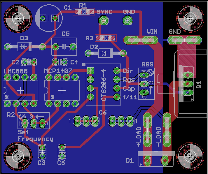

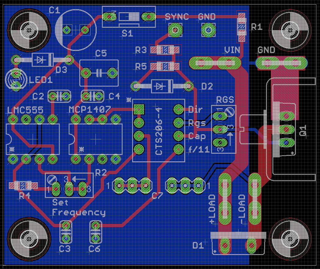

Clever. Revision attached. I added a large SMD pad for the braid. (It doesn't show up well in the image but you can just see the hash markings.) By my calculations there doesn't need to be one of the top layer (I will use 2oz copper) to get below 200uR but I may as well pour a thick copper trace to match on top as it's free.

That layout is very nice! Good idea to connect to the FET before making the plane. It appears there is room in the vicinity of LMC555 pin 8, to install a two-pin header which connects or disconnects +Supply from the 555 and thus enables/disables oscillation. Pin1 and Pin2 form an SPST swich. When a shorting plug is installed, the switch is closed.
Another place for a supply-disconnect header that you may like even better is just below R1, which would remove +supply from everything. This connection guarantees that the MCP1407's output certainly is not high when the header is pulled and the thing is supposed to shut off. Wanna 100K across D2 for even more peace of mind?
Just choose a place that is NOT between the bypass caps and the MCP1407 supply pins -- that's a 6 ampere current path.
Some people would advise you to paint the bottom edge of the heatsink with nail polish, just to provide another layer of protection against shorting to the top layer of the PCB after the heatsink eventually rubs away the soldermask insulation. You could also apply one sided foam tape to the PCB, to act as both an electrical insulator and a mechanical barrier + vibration damper. Maybe like THIS, sorry for the USA product link.
Finally I recommend you double check your calculations for the dynamic power dissipation of charging and discharging the MOSFET's gate once per cycle of the oscillator. MOSFET datasheets now specify total gate charge Qgtot, and by the definition of current {amperes = coulombs per second}, Iavg = (Qgtot * frequency). That is likely to be the single largest component of the summation which gives you the total current drawn from your zener diode shunt regulator. The worst case max current occurs at the max oscillation frequency. Maybe your series resistor value is drastically, embarrassingly too small. Or too big. Or maybe not.
ok I will look supply disconnect options. Regarding the heat sink, it is actually elevated some 4mm above the PCB. The bottom of the heat sink is level with the bottom of the case of the pass transistor but the latter is elevated due to widening of its pins near the case.
Oops! If f=1/(1.4 x R2 x C3) with C6 switched out and the low end of range of my 100k trim resistor is 2 Ohms max (if this is the definition of end resistance) then the frequency could be absurdly high. With a max Qgtot of 41nC then Iavg could be as high as 1.46A (?) Feels like I should have a series resistor with R2, say 68k, to set a sensible upper level for the switching frequency? (As well as correcting R1) Or have I screwed up my maths...

Revised chop chop box board and schematic attached. I have settled on a value of 1400 Ohms for R4 and 1100 Ohms for R1. My rationale was as follows. R4 implies a maximum oscillation frequency of 51KHz (50x the upper bound of Elvee's box). Surely this will be more than enough. If I ever need more I can adjust the board's component values.
I then solved for R1. If R4 is 1400 implying a max freq of oscillation of 51kHz then Iavg = Qgtot x freq = 2.1mA when maximum Qgtot is 41nC. So the circuit will need at least 2.1mA. To provide for headroom I used 3mA and solved for R1 when Vin is at its lowest 3.3V, i.e. R1=1100 Ohms.
If the PSU-under-test FET blows and Vin goes to 25V then I believe things will still be inside the ability of D3 (1.3W) and its series LED (30mA max DC fwd current) to protect the chop chop board.
