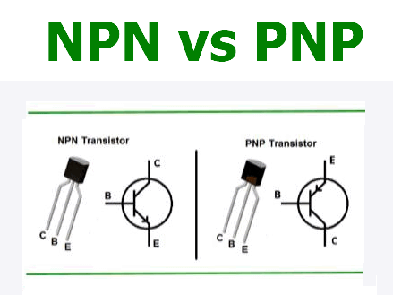

The schematic in post 56 is correct.The transistor is a PNP type.See attached
pic.
Reactions: rongon
The schematic in post 56 is correct.The transistor is a PNP type.See attached pic.
Thanks. I had a feeling I didn't know all of what's going on there, which was why I was questioning myself in that post. I'm not very experienced with solid state stuff. NPN transistors are easy for me to conceptualize, but PNP transistors still confuse me a bit. Taught myself electronics by working on tube amps (guitar amps first). A little Dunning-Kruger effect at work here, I'm afraid -- 😳

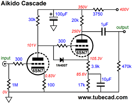

What do you think about this circuit? 6SN7 based.

The problem with too much gain is that it will almost always introduce too much noise.
It's best to choose the right amount of gain so that you don't invite extra noise from employing too much gain and just burning it off with a resistive voltage divider of some kind.
2x gain is 6dB.
3.2x gain is 10dB
5x gain is 14dB.
10x gain is 20dB.
20x gain is 26dB,
A 12AU7 has mu of about 16, which means typical gain of 8x to 12x, which is actually a lot of gain. Far more than needed.
A 6SN7 has mu of 20, which means typical gain of 12x to 15x, which is even more gain. Far more than needed.
You could use negative feedback to reduce the gain, decrease distortion and lower output impedance. All good things, yet many people feel negative feedback is the devil's work. Oh well.
A 6V6 wired triode has mu of about 10, which means typical gain of 6x to 8x. See https://www.diyaudio.com/community/threads/6v6-line-preamp.102352/
A 12B4A triode has mu of about 6.5. which means typical gain of 4x to 5x. See https://www.diyaudio.com/community/...the-12b4-better-than-the-grounded-grid.68267/
Reactions: Painkiller
Sounds like will have to explore other circuits and other tubes yes.
