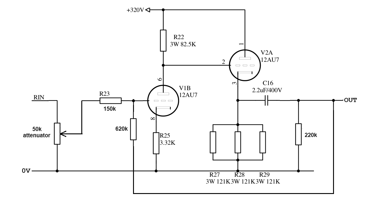

There's a 50k shunt attenuator on the input. Can I add a feedback resistor without adding an extra series resistor on the input?

Is the 50k shunt attenuator something very different from a rotary potentiometer? For adding the NFB loop, negative feedback should still work with an attenuator at the input, like this:
The junction of R23 (the series resistor) and the 620k resistor from the output (the feedback resistor) forms a 'virtual ground'. So a volume control that's outside of the feedback loop won't affect V1B.
The input impedance of the circuit is R23 (pretty much), so the 50k volume control's 12.5k ohm output impedance is working into roughly 150k ohms. That should be OK.
If the 50k attenuator is something very different from what's shown above, then all this may not work.
I'm not saying the above is anything like a fully optimized circuit. It's just an example adding on to what I believe may already be built.
For discussion's sake.
I tried this with 100k+432k input and feedback resistors. It works fine. Output level is reduced, but hiss is still somewhat audible in listening position. Could I reduce the value of the feedback resistor even further, or would that put too much of a load on the tube?

As a cathode follower per design offers low output impedance, 470 kΩ isn't a noticeable load to it. You could even decrease it to, say, 100 kΩ if you want.Could I reduce the value of the feedback resistor even further, or would that put too much of a load on the tube?

I've never tried this kind of feedback loop with the shunt resistor lower in value than the series resistor.
In theory, a 150k shunt resistor with a 150k series resistor should result in unity gain. But perhaps because the 12AU7 has such limited open loop gain, the shunt resistor value will need to be actually -smaller- than the series resistor value to get the circuit to unity gain (gain of 1x).
But then, isn't a cathode follower a better unity gain buffer?

I'm starting to think a cathode follower with unity gain would be better for me. But I honestly would prefer a kit of some kind. Don't want to go through the whole process of routing pcb's again.
Something like the Aikido 6SN7 buffer would be perfect. Aikido cathode follower
