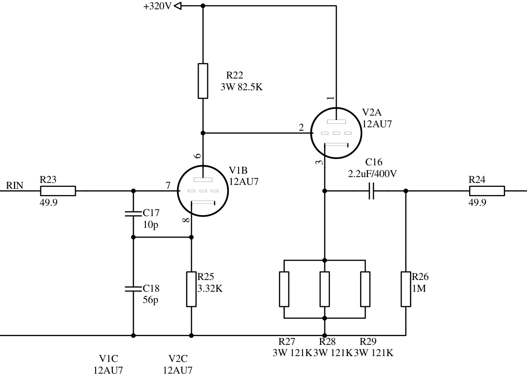

It isn’t outside the feedback loop. It is part of the input impedance. There is nothing that magically separates it from R23.So a volume control that's outside of the feedback loop won't affect V1B.

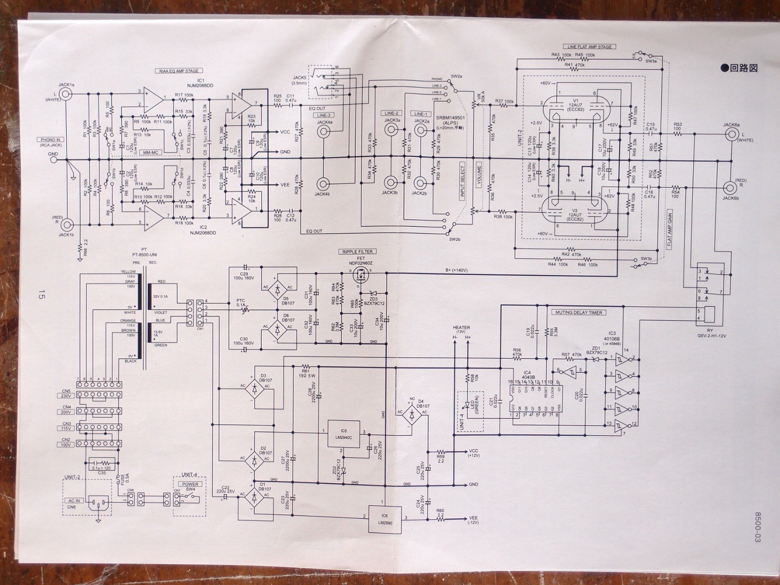

Thanks. I had a feeling I didn't know all of what's going on there, which was why I was questioning myself in that post. I'm not very experienced with solid state stuff. NPN transistors are easy for me to conceptualize, but PNP transistors still confuse me a bit. Taught myself electronics by working on tube amps (guitar amps first). A little Dunning-Kruger effect at work here, I'm afraid -- 😳The schematic in post 56 is correct.The transistor is a PNP type.See attached pic.

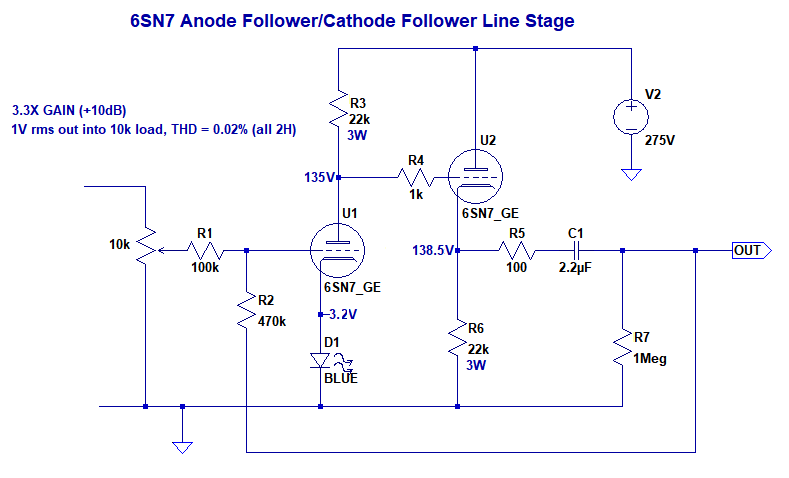

This was hashed out years ago in a thread about anode followers. In practice the effect of putting a volume control on the input is pretty much negligible as long as the volume control has a much lower output impedance than the series resistance. In this case, I was thinking the series resistor would be 150k ohms (shunt feedback resistor 470k ohms). The 50k volume control in front of it shouldn't change the feedback ratio by very much at any point in its rotation. Changing the series resistor to 100k degrades that a bit.ejp
25k in relation to 150k isn't negligible. In any case it is still totally incorrect to say it is 'outside the feedback loop'. and 'won't affect V1B.' It isn't, and it will. So will the output impedance of the source.In practice the effect of putting a volume control on the input is pretty much negligible
In fact you contradicted yourself. If R23 is part of the input impedance seen by the source, which it is, the volume control has to be part of the input impedance seen by the valve. You're having a bob each way here.
I don't know what a "bob" is, but you're right, the volume control is part of the source impedance, which does affect the feedback loop, but you'd need to pick a really big resistance value for that to make any difference at all.

What do you think about this circuit? 6SN7 based.

Again the question becomes, "How much gain do you need?"
Answer that question and you'll be able to pick a circuit that will work well in your particular situation. Don't answer that question and there will be some trial-and-error ahead.
Gain 5 to 20dB. But minimal noise. I think that thr gain was not really the biggest problem, but the noise.I could have lived with the original circuit, but the hiss was annoying.
The problem with too much gain is that it will almost always introduce too much noise.
It's best to choose the right amount of gain so that you don't invite extra noise from employing too much gain and just burning it off with a resistive voltage divider of some kind.
