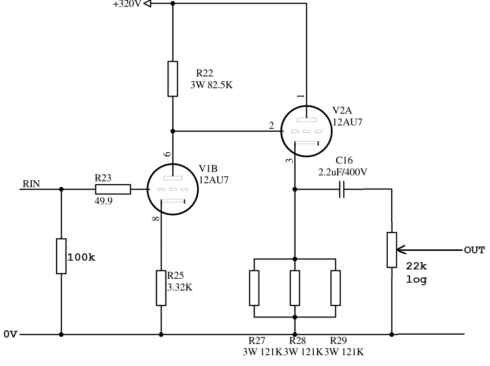

C17 and C18 should not be necessary. I would remove C17 and replace C18 with a proper cathode bypass capacitor of 47uF or so (high quality electrolytic rated at 25V DC or higher). Or you can leave C18 out as well, which will reduce the gain from V1B.
The second stage is a cathode follower. The output signal comes from the cathode of the cathode follower, not its plate.
"Yes, both channels hissing." - That might be caused by the lack of any grid leak resistor. As has been pointed out, either you need a grid leak resistor (V1B grid to ground) or you can make use the steps above to make this circuit an 'anode follower' buffered with a cathode follower and the NFB will create a virtual ground, fixing the problem of the floating grid on V1B.

- Replace R23 with a 100k ohm resistor.
- Take a new 470k ohm resistor. Connect one lead to the junction of R24 and R26. Connect the other end of the resistor to the grid of V1B (the first stage 12AU7). The gain of V1B is not very high (probably about 12X) so the 470k/100k voltage divider will likely result in an overall closed loop gain (with NFB) of only about 2.5X gain. You could increase the value of the added 470k feedback resistor to 560k or 680k to increase the overall closed loop gain, if needed. Adjust à ton goût.
- R24 is a 'build out' resistor which can suppress oscillation when circuit is used to drive an interconnect cable and load input with capacitance. I'd leave it there. It might do some good, and it doesn't do any harm (it's only 50 ohms. not enough to raise the output impedance in any meaningful way).

A 100k resistor allows use of a 470k feedback resistor, which should not present an onerously heavy load on the 12AU7 cathode follower.
If adding a 100k resistor doesn't agree with you, you can use a 51k resistor instead, and a 240k NFB resistor. This will place a heavier load on the cathode follower, but the high frequency bandwidth will be a bit wider and a 51k resistor will make a little less noise than a 100k resistor. However, adding these parts will at least make a circuit that should work reasonably well, and would accomplish the goal of roughly 3X gain closed loop.

Putting a pot on the output of a gain stage makes the gain stage worse.Probably one decent solution is to insert a pot of, p.e., 22 kohm, in output instead to use the feedback as shown
But it is my opinion
The stage will be getting the full amplitude signal at its input, and then you put a voltage divider at its output.
Because the stage will be getting the full amplitude signal at its input, all the time, it will have higher distortion in its output (THD is proportional to level in a triode stage).
With the pot at the input, you're reducing the signal level to the input of the gain stage, so signal levels are lower in general. Being that THD is proportional to level, there will then be less THD in the output.
I mean the pot on out of the circuit not gain stagePutting a pot on the output of a gain stage makes the gain stage worse.

Do you mean put the pot (volume control) after the cathode follower? Like this?
That amounts to the same thing.
Let's say the signal source is a phono preamp. It will be playing with its full output. That could be up to 1V rms.
V1B will amplify that by about 12X, so there will be 12V rms at the grid of V2A and something like 11.5V rms at its cathode.
You will then use the 22k pot on the output of V2A to attenuate the signal back down to 1V rms or less.
However, V1B will still be putting out 12V rms, no matter what position the 22k pot is set to. That's a lot of signal, so there will be a lot of THD.
If you make the 100k grid leak on V1B a pot, now 1V into the pot will be attenuated to 1/12th of a volt (83.3mV), amplified back up to 1V at the plate of V1B. That's a much smaller voltage swing for V1B for the same amplitude at the circuit's output. V1B will be operating with 1/12 of the THD compared to having the volume control on the output of V2A.

As for the negative feedback...
1) What kind of power amplifier is this preamp circuit driving? One of these new-fangled Class D things? If so, those have input impedance of around 10k ohms.
2) You can't use really small values of resistance for the NFB voltage divider, because those appear in parallel with the load. You risk loading down the cathode follower pretty badly, which might not sound so good. If the NFB series resistor is 27k ohms and you want about 3X gain, the NFB parallel resistor will probably need to be about 120k ohms. That's going to be in parallel with the load impedance (which might be 10k ohms) and the NFB series resistor, so 27k // 120k // 10k = 6.5k ohms. That's going to be a pretty heavy load for a 12AU7 or 6CG7 cathode follower.
If you use the 100k and 470k I was suggesting, you'd get 100k // 470k // 10k = 8.9k ohms.
Maybe that's not a big enough difference to worry about. Neither are optimal.
This will work better if your power amp is a tube amp with high input impedance, or a solid state amp with 47k ohm input impedance. But if your power amp is a contemporary design with 5k ohm or 10k ohm input impedance, this circuit is going to struggle.
