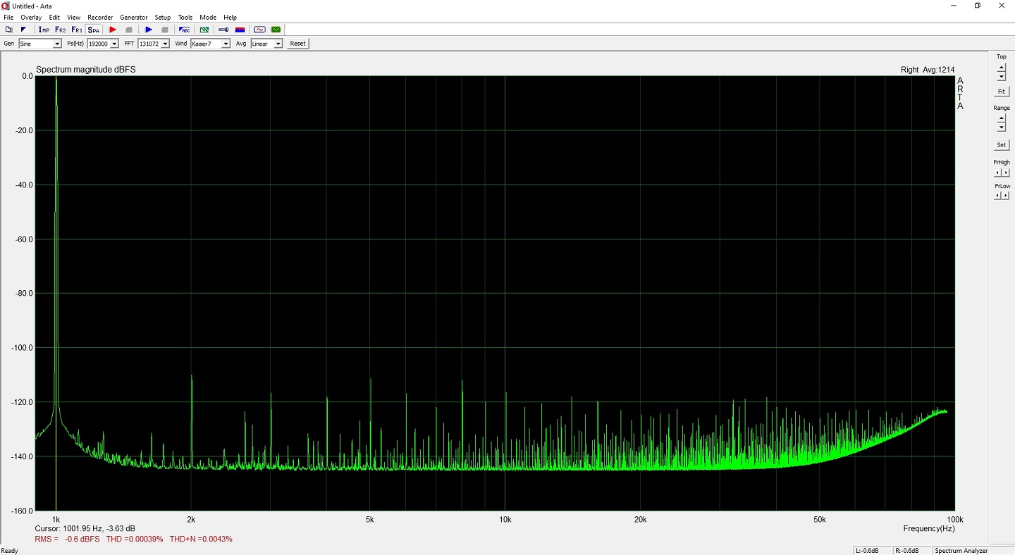

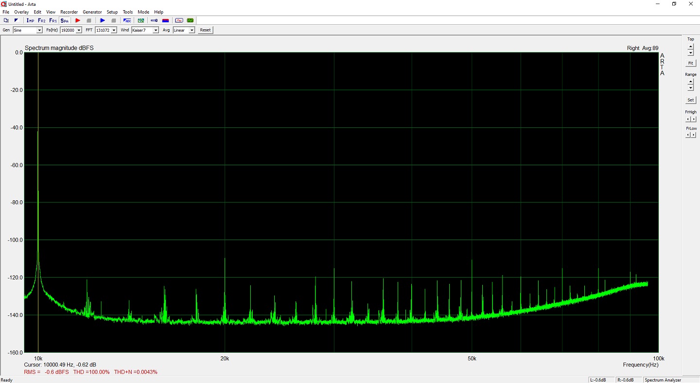

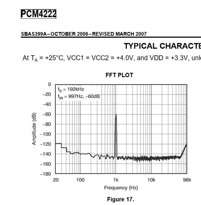

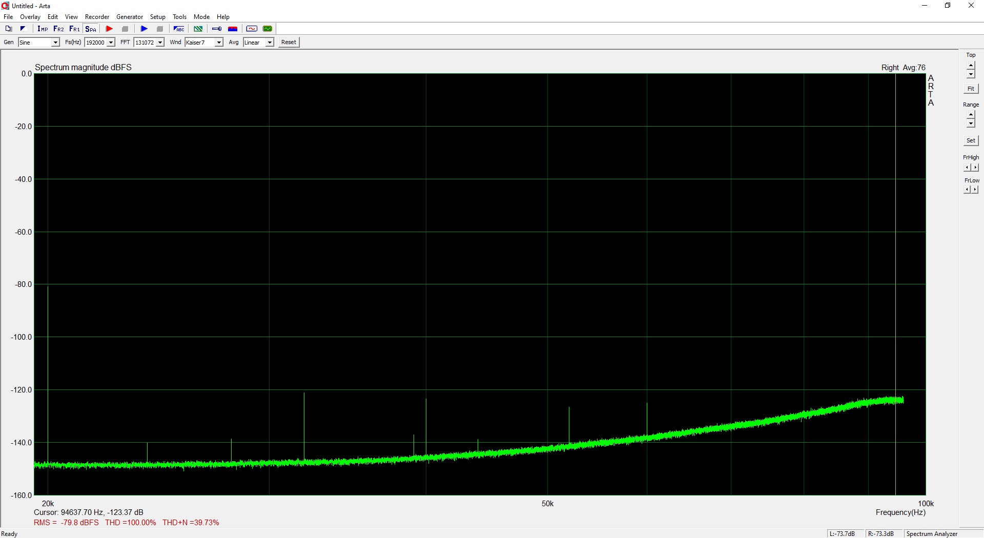

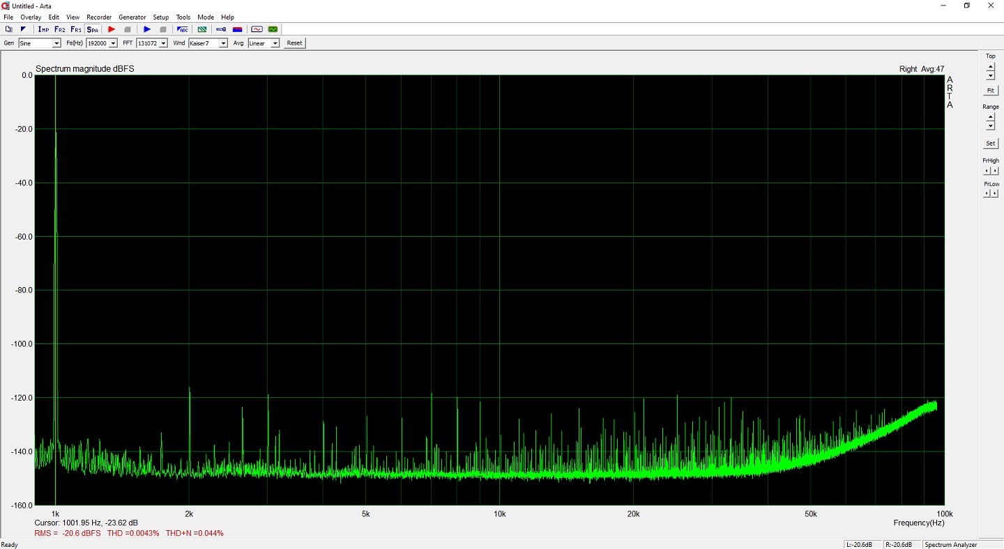

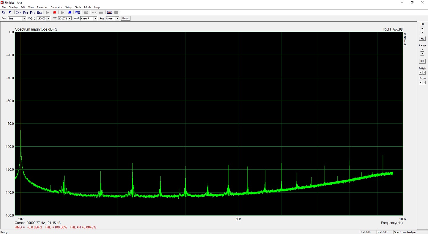

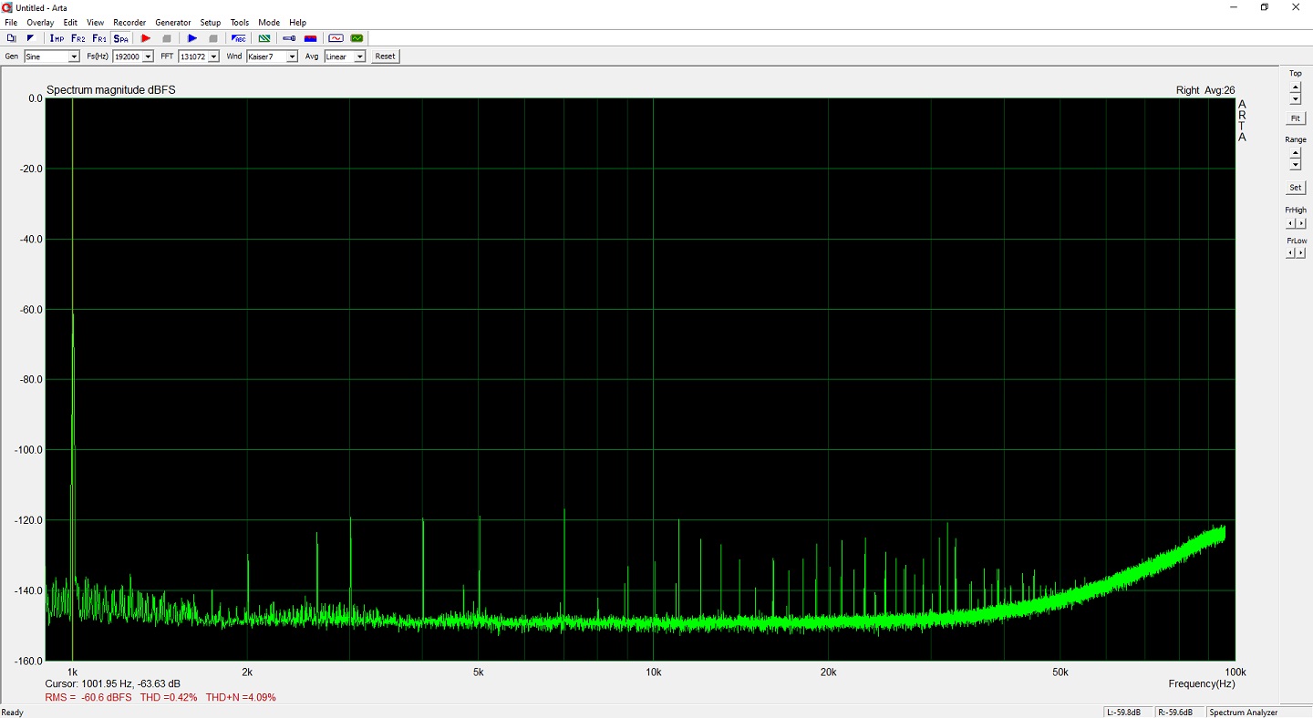

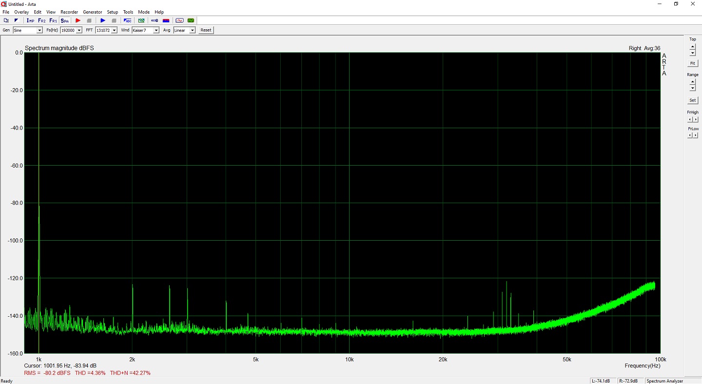

The AK5572 @192KHz sampling rate, same Slave mode (the XMOS is the master), I2S streaming.
Not too bad, the noise floor rises past 50k and never exceeeds -120dBFS. In fact, it is strikingly similar to the TI PCM4222 @1KHz/-60dB (not sure how the PCM4222 is performing at higher frequencies). Distortion numbers are actually a little pessimistic, I would think, but there's not much I could do unless I decide to put everthing on a properly shielded PCB. I find also remarkable that the performance doesn't degrade significantly with frequency and input level.
I would not use the AK5572 for measurements/metrology, but otherwise it appears to me it is an excellent ADC for strict audio applications.
Input opamps are LME49710, 0dBFS=10Vpp.

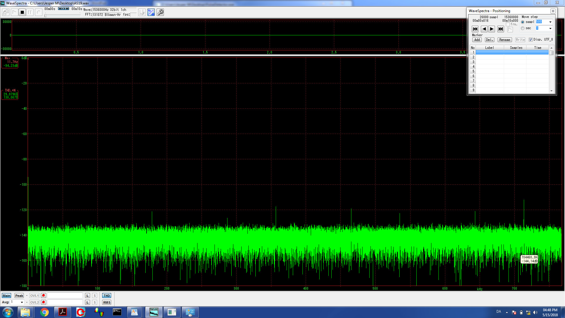

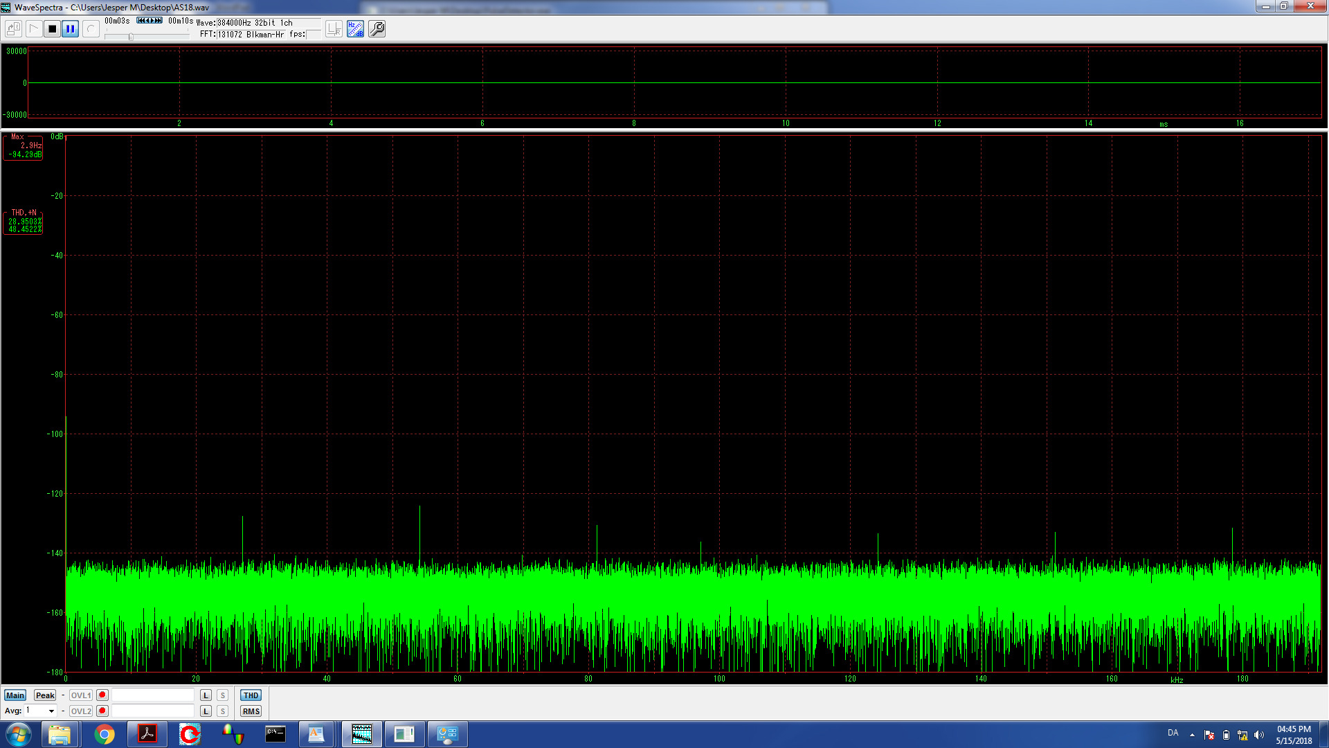

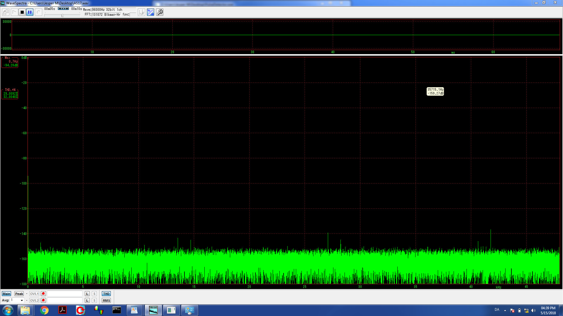

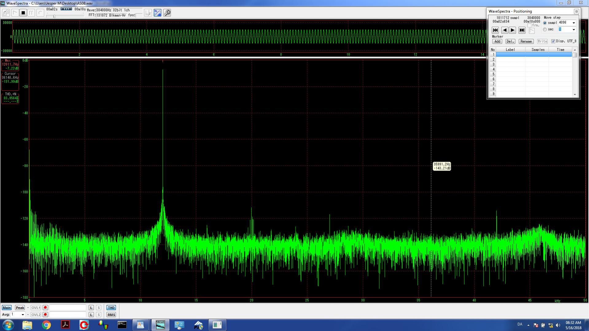

I have been following this thread "on the side" as I'm currently deeply buried in another project. However, I have noted that you are interested in how SAR ADCs perform in the high frequency region. To this end I (and two more fine programmers) have been investigating the LTC2380-24 at up to 1.536 MHz sampling frequencies.
FYI I have attached a couple of screen dumps of what the LTC2380-24 looks like at various sampling frequencies (inputs shorted & a 12 kHz Viktor oscillator).
I don't consider the 12 kHz measurement to be "final" - I think that altogether the input circuitry was not optimal so I'm quite sure that the ADC is capable of better performance.
All data sampling was carried out in a custom made FPGA setup/program that these two programmers kindly helped make. The spectra was then generated in WaveSpectra which I happened to find out could handle 1.536 MHz files.
FYI during my tests with the LTC2380-24 I have not noticed any significant rise in HF noise. I have also tested the AK5572, however, since I am interested in high frequency sampling (1.536 MHz etc.) I did not do much more with that ADC (I do use it for measurements, though, as it is simpler with I2S).
Jesper
