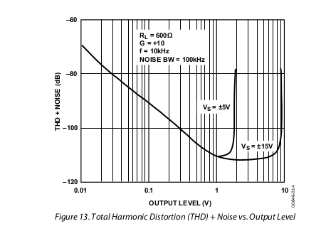

Below is thd chart for AD797. Plus, ad797 specified at +-5 and +-15V, and to interface it with +5V adc, RC network must be customized in order to prevent damage of the adc . What I'm driving at, thd-3 harmonics has to be present on 12 kHz thd chart.@MagicianT:
Oh, oh ... it's been a while so my memory on this is not entirely updated - but if I'm not mistaken I used either two ad797s in a "pseudo-balanced" buffer configuration or just fed Viktor's 12 kHz oscillator directly to the inputs of the 2380 (with resistor and capacitor input network). Also everything was placed on the table, unshielded, and wiyh quite long cables. The slightly "curvy" 12 kHz response seems to be associated with Viktor's oscillator (unshielded) as I have seen a similar response with the ak5572 and the ad7760.
Cheers - Jesper
Driving differential adc directly from single ended oscillator is also has obvious fingerprints, in strong thd-2/4 harmonics.
For myself, I feel more confident when I see all line thd2 - 11, and missing some harmonics could point on mistakes in hardware or software processing.
