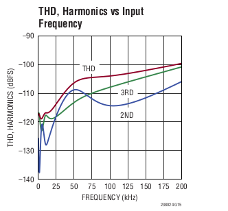

Hi syn08,
I have been following this thread "on the side" as I'm currently deeply buried in another project. However, I have noted that you are interested in how SAR ADCs perform in the high frequency region. To this end I (and two more fine programmers) have been investigating the LTC2380-24 at up to 1.536 MHz sampling frequencies.
FYI I have attached a couple of screen dumps of what the LTC2380-24 looks like at various sampling frequencies (inputs shorted & a 12 kHz Viktor oscillator).
I don't consider the 12 kHz measurement to be "final" - I think that altogether the input circuitry was not optimal so I'm quite sure that the ADC is capable of better performance.
All data sampling was carried out in a custom made FPGA setup/program that these two programmers kindly helped make. The spectra was then generated in WaveSpectra which I happened to find out could handle 1.536 MHz files.
FYI during my tests with the LTC2380-24 I have not noticed any significant rise in HF noise. I have also tested the AK5572, however, since I am interested in high frequency sampling (1.536 MHz etc.) I did not do much more with that ADC (I do use it for measurements, though, as it is simpler with I2S).

Quote from page 17.
It's impressive, I don't see thd-3 at 36 kHz. There is thd-2 where it's supposed to be, slightly higher than "typical" value charted in adc's DS. The issue I observed with 16/18-bits 1-2 msps adc (experimenting with AD7988/7984) is not sampling rate itself, adc quite happy with fast sampling, but THD level rising up starting about 10 kHz input and bumping up to -93 dBc at 100 kHz.
LTC2380 seems better, crossing -100 dBc at 200 kHz, but still would be hard to get those values, a lot 'd depend on a adc's front end driver. What OPA you are using?
Oh, oh ... it's been a while so my memory on this is not entirely updated - but if I'm not mistaken I used either two ad797s in a "pseudo-balanced" buffer configuration or just fed Viktor's 12 kHz oscillator directly to the inputs of the 2380 (with resistor and capacitor input network). Also everything was placed on the table, unshielded, and wiyh quite long cables. The slightly "curvy" 12 kHz response seems to be associated with Viktor's oscillator (unshielded) as I have seen a similar response with the ak5572 and the ad7760.
