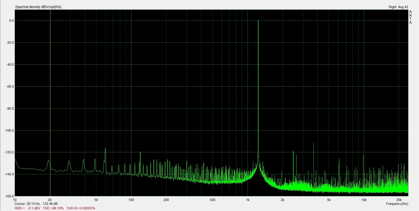

Now that I got a week to focus on development, rather than arguing with the golden ears, here's a quick update: Got the first Arta distortions measurements, using the AKD4499 reference board, an AK5572 board, and the XMOS-AUDIO-216 board.
Both the AK4499 DAC and the AK5572 ADC are in slave mode, running with the MCLK from the XMOS board reference clock, and BICK and LRCK generated by the XMOS chip. The XMOS code was modified to accomodate the AK4499 and AS5572 registers set and required settings. Got around -117dB loopback THD @1KHz, and -110dB THD+N both @48KHz sample rate. At higher sample rates, I can now confirm myself that the AK5572 has the same noise floor increase at high frequency as the majority of audio ADCs on the market, in all high sampling rate modes. So the AK5572 is clearly inferior to any SAR ADC available on the market.
The current XMOS chip generates the LRCK and BICK clock in software, based on the sample rate received from Arta. That's a lot of room for improvement here; currently working on integrating a programmable CDC925 PLL clock generator; the idea is to modify the code to send I2C commands to the clock generator, modifying on the fly the frac PLL and the output hardware dividers and generate an optimal clock structure, for each DAC/ADC mode, up to the max 192KHz sampling rate supported by the Thesycon/Microsoft driver.
Second in the TODO list is integrating a 20bit SAR ADC. Conversion from SPI to I2S is surprisingly difficult to do without using a FPGA (and even with a FPGA is non trivial, if it is to cover all I2S modes). That's because of the I2S specification which requires a one BICK clock delay between LRCLK and DIN/DOUT. It is much simpler though, if it is to cover only the Left Justified mode, since the same I2S specification states that DIN/DOUT should be "valid on the rising edge of BCLK following the falling edge of LRCLK". There is a good TI white paper on this conversion http://www.ti.com/lit/an/slaa449a/slaa449a.pdf and this is likely what was mentioned in this posting regarding a new 20bit R-2R DAC from TI https://www.diyaudio.com/forums/ven...1001-20-bit-2r-precision-dac.html#post6087981 Not sure yet how to approach this conversion issue, to restrict the conversion to Left Justified, and generate the LRCK in hardware, or to go the FPGA route (much more elegant, but hard to justify the cost of a FPGA chip for this fuctionality only). There is a 3rd route, to process the conversion in the XMOS chip software, but this is a hardcore task, not sure if I'm ready for it (and not sure if the results will be good enough to justify the effort).

Attached, the experimental setup (ADC + XMOS, AK4499 DAC reference board didn't fit in the pic, it's huge) and the ARTA loop measurements. -116dB THD @1.234KHz and about -112dB THD+N. Both at 0dBFS which is 10Vpp analog.
Note the point to point clocks wiring, this is a slap in the face to those preaching the MCLK, etc... clock criticality, audible differences between NDK and Crystek, the need for 1pS jitter, clean, etc..., it's hard to imagine a worse clock distribution (both for signal and ground return), though the numbers above are beyond any audibility thresholds. They will of course go down at least 3dB and the spurious noise grass will vanish when using a PCB.

syn08, I think you should make the separate measurement of ADC and DAC, because on this picture you cannot know who produce this harmonics.
To do this you need anlogue oscillator with very low THD ("victor's" , or something else, discussed n the nearby threads

If Syn is using the AKD4499 board then I think it's pretty safe to say the bottleneck here is the ADC.
In terms of raw distortion figures the 4499 is quite a bit better than the 557x series especially when driven near 0dBfs.
I am assuming that the AK4499 evaluation board has been through testing by AKM to ensure datasheet performance.

Yep, already confirmed by measuring independently the AK4499 reference board. Has -127 to -130dB THD @1KHz and -0.5dBFS. About 6dB worse THD+N but that includes the lack of board and wiring shielding.

No need to isolate the ADC THD, I tested the AK4499 independently with my Rohde UPD, the equivalent (in performance) to an AP System 2, and verified the results against a Panasonic VP-7722 (no relevant differences found).

The AP, UPD, VP-7722 already uses a Notch for measurements.
Using your AKM 55xx ADC & ARTA (or any else) requires a notch (minimal 40..50dB notch), so the ADC gets 40..50 dB lower full scale and this would lower/skip ADC THD and you would measure the DAC THD (only). The THD added of the Notch should be known

With notching there's not much need to go for the latest and fanciest ADC/DAC. The fun is to push the THD under -120dB before notching .
A fundamental frequency tracking notch has to be an analog subsystem, and that's not something for the faint hearts at these levels. In fact, I have no idea how to implement such an analog notch with anything like a known/controlled/reproducible distortion performance. I would think it makes much more sense to push the digital performance to -120dB, then apply notching to a set of predefined fixed frequencies, using a passive Twin-T (for example), when the need to measure -140dB distortions or lower occurs.
