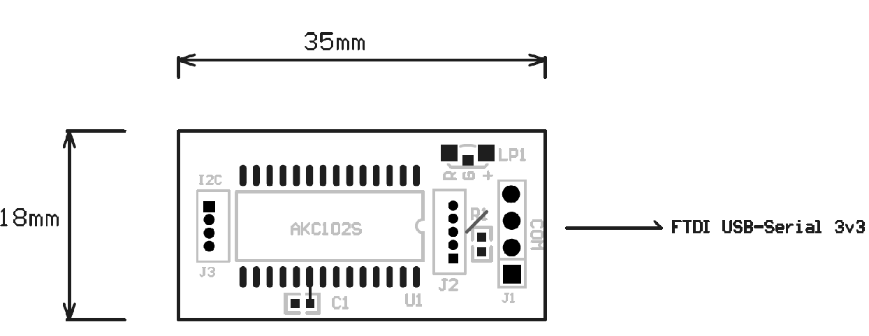

ADC Controller
Something like this:
Basically a general purpose USB-I2C converter. Connect to host PC, run a terminal emulator software like Win Hyperterminal and issue register commands to any connected I2C device.
Not sure if there is anything similar off-the-shelf?
I can do a stripped down version of this controller for this ADC if other options are not favourable.

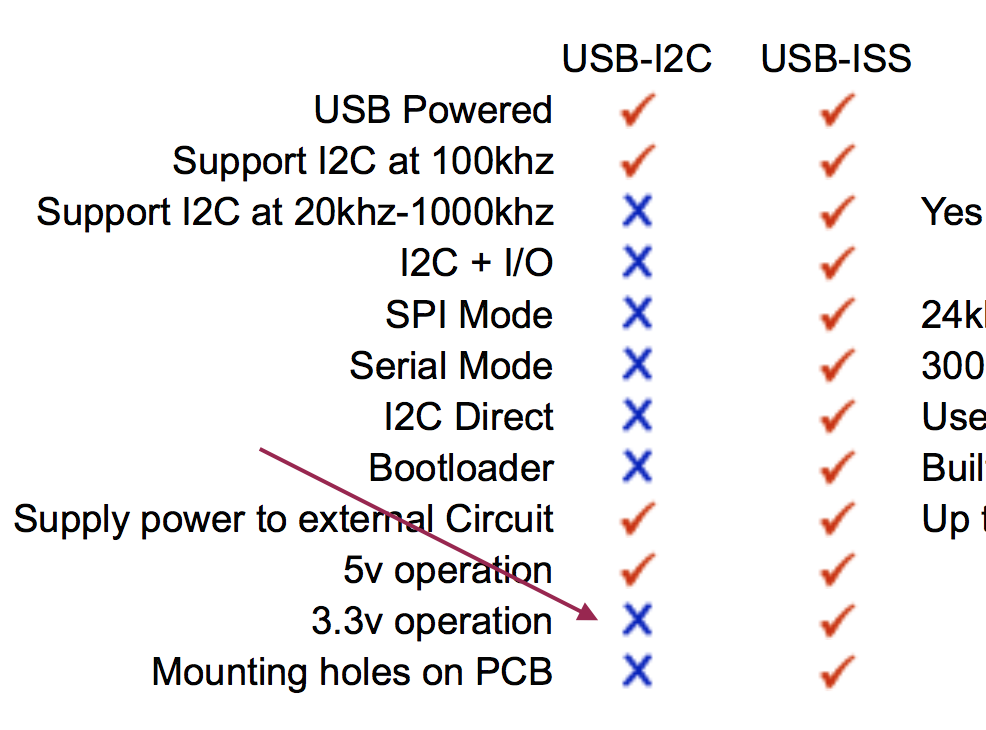

The top one only does 5v for I2C?
Select this only USB-ISS - Enhanced USB-I2C Module (3.3V)
Function I2C ISS
3.3v operation X V
OK?
Looks like it is the case but please check the details before considering.
