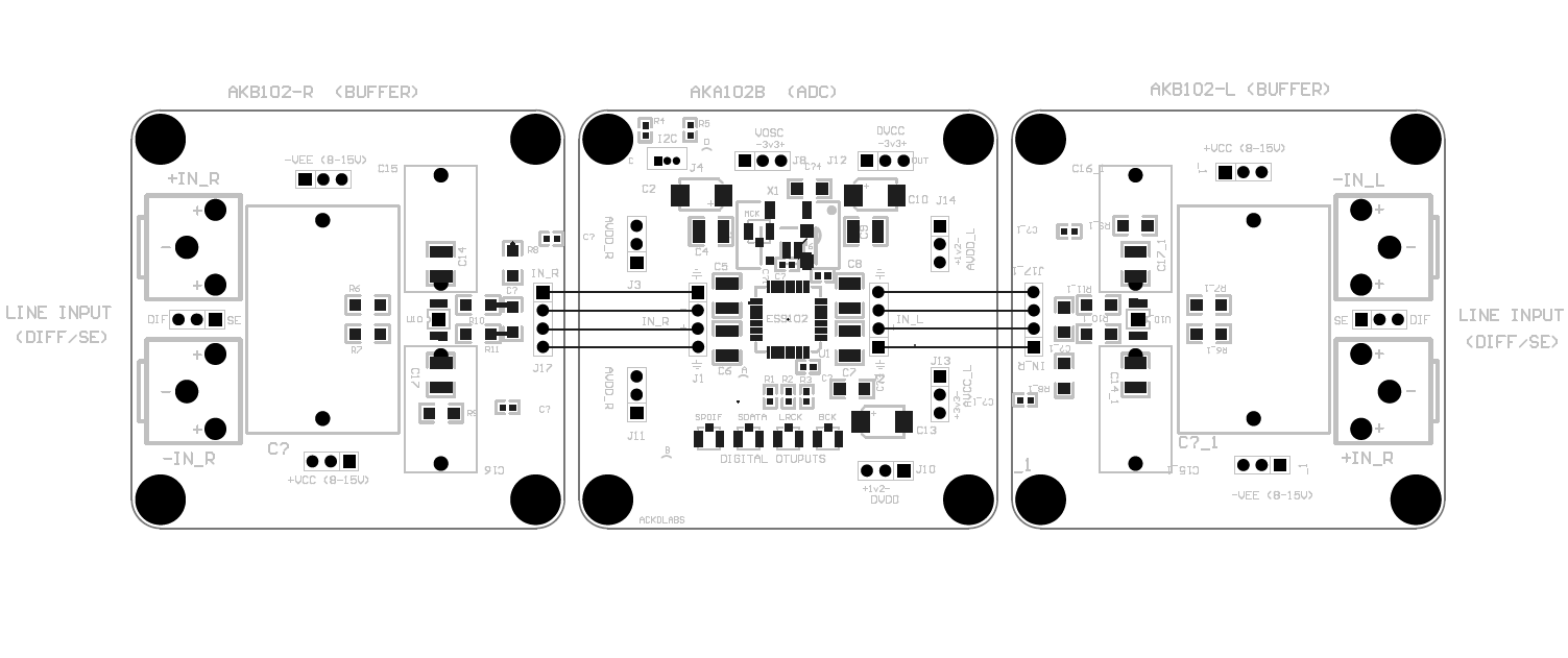

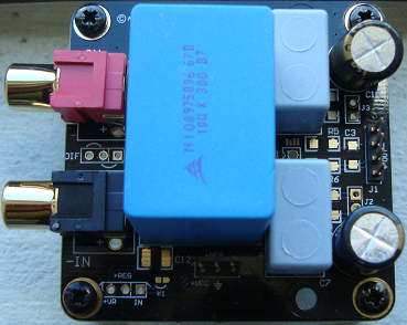

No print indicating + / - on out.... ?
Is that a RCA for In+ and a RCA for In- on the buffer input?
The adjustable gain - how is that accomplished control wise and how is it implemented?
J1 is the output. "GND, +, -, GND" are marked on board and matches the ADC inputs
Input connectors are RCA. Supplied but not mounted. The is also a 2-way header underneath the RCA if this is preferred. For single-ended sources, connect to the Red Input only and set the jumper to "SE". For balanced source connect to both inputs +/- and set jumper to "DIFF"
Buffer Av=1, set by resistor on board with thru hole pads for adding shunt resistors to trim gain (attenuate only) if required to match line levels.
Design is still being reviewed, Adding a few more tweaks to improve performance-being the front end this is critical. All precision components and PP film caps.
There will not be a GB but those who have purchased the ADC boards will be notified when ready for ordering.

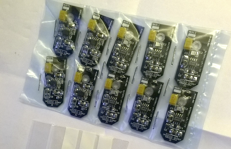

I exchanged 5 (3 1,2v and 2 3,6v) out of 7 stabs on my AKD12P and the results is amazing. The resulting stability of the soundscape and resolution of fine musical detail during busy high level passages is nothing but astounding. Looking fwd using these to build my AD with the same concept using trafo on the input. Nice work Acko!
Excellent! Thanks for the feedback.
See if you can improve the performance further with the tweaks as indicated in the user's manual (for the AKR75-3.6V types)
