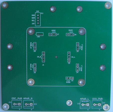

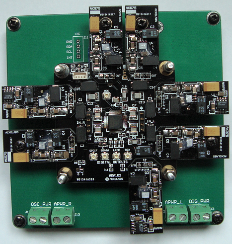

Something to consider if you want to build a neat setup 🙂

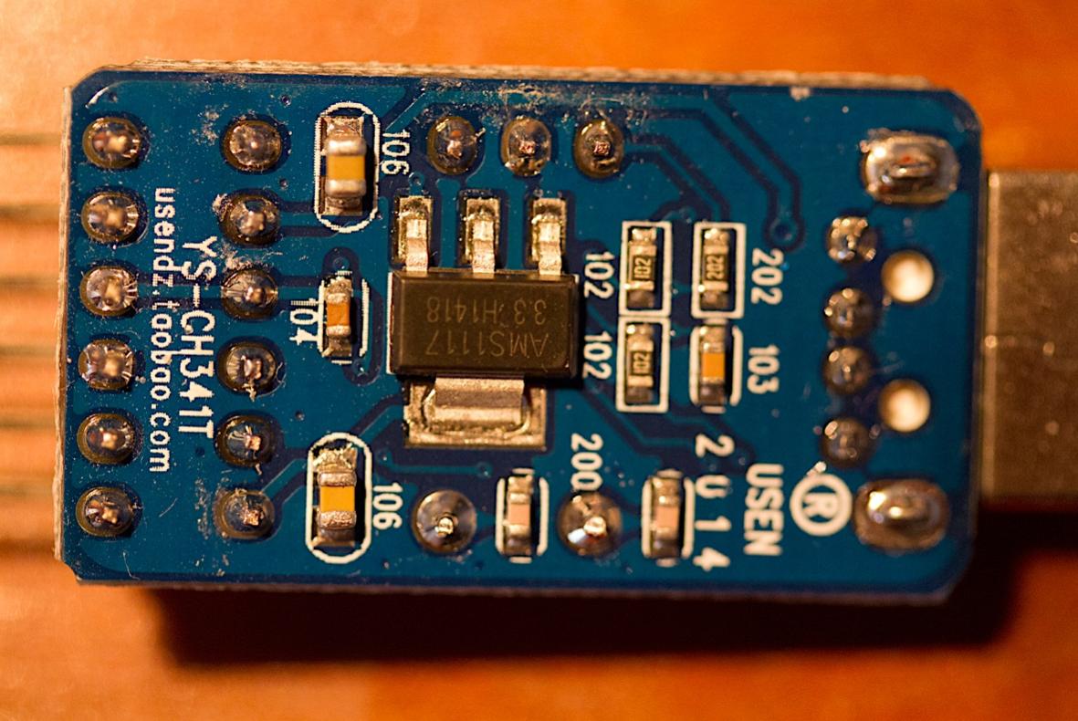

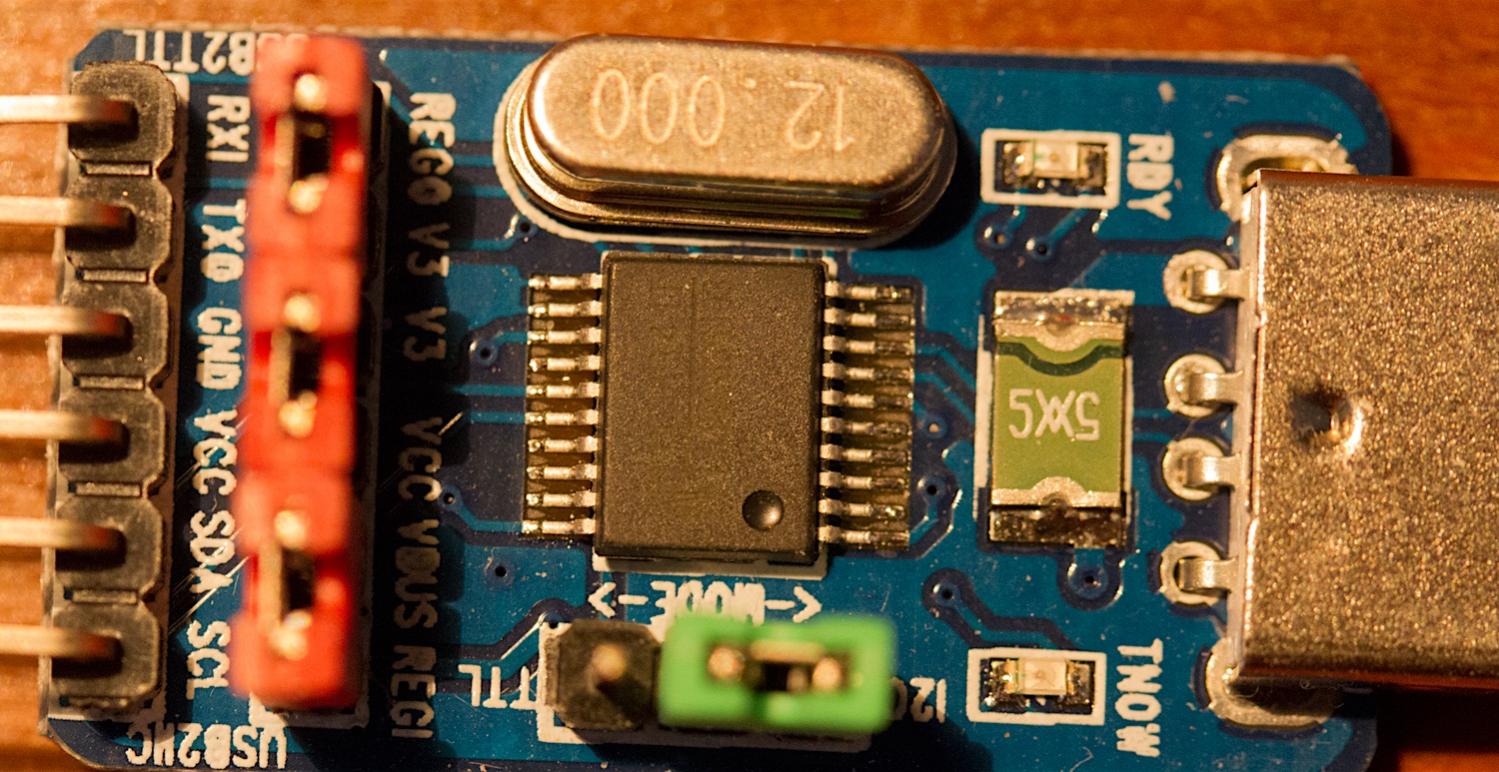

Can you by the aid of these pictures give me a hint on how to connect this? I'm a bit confused around the C and D straps - they seem to control the fs in HW mode. Do they have other function is SW mode? Please explain.
I have already explained the C and D strap connection in the previous post. In SW mode these become I2C points - see Schema for details.
Your I2C module looks compatible for direct connection. I am assuming from the pics there are no pull-ups on this module so you need to ensure ADC module has pull-ups enabled, again refer to previous post.

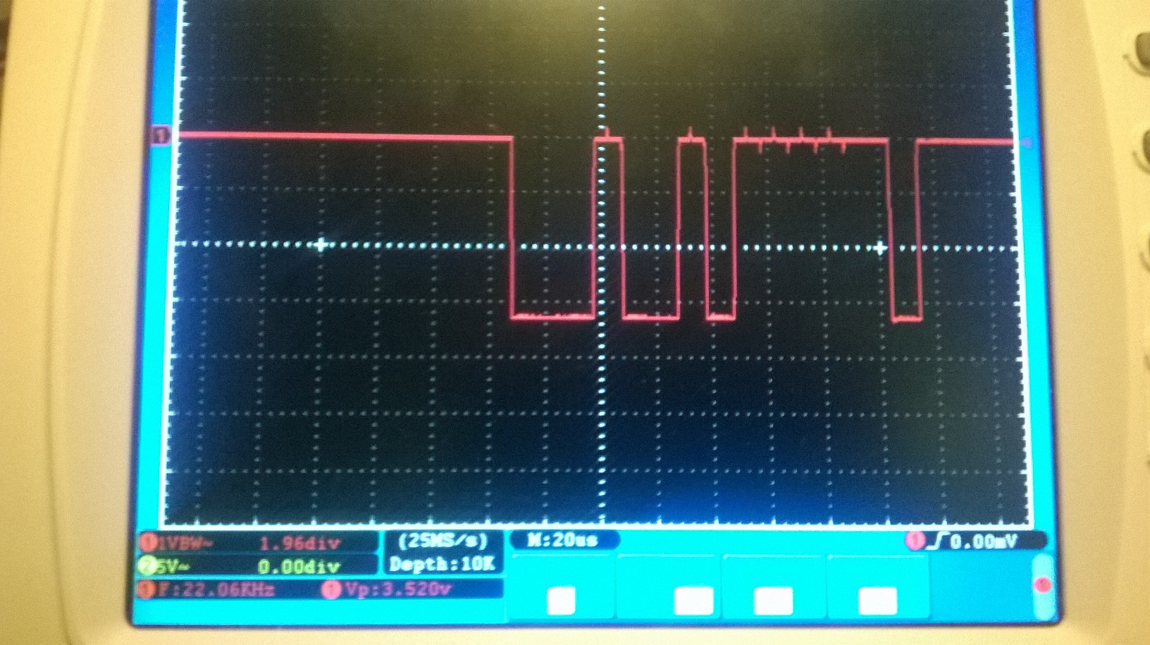

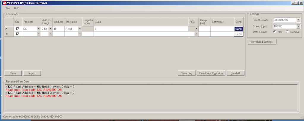

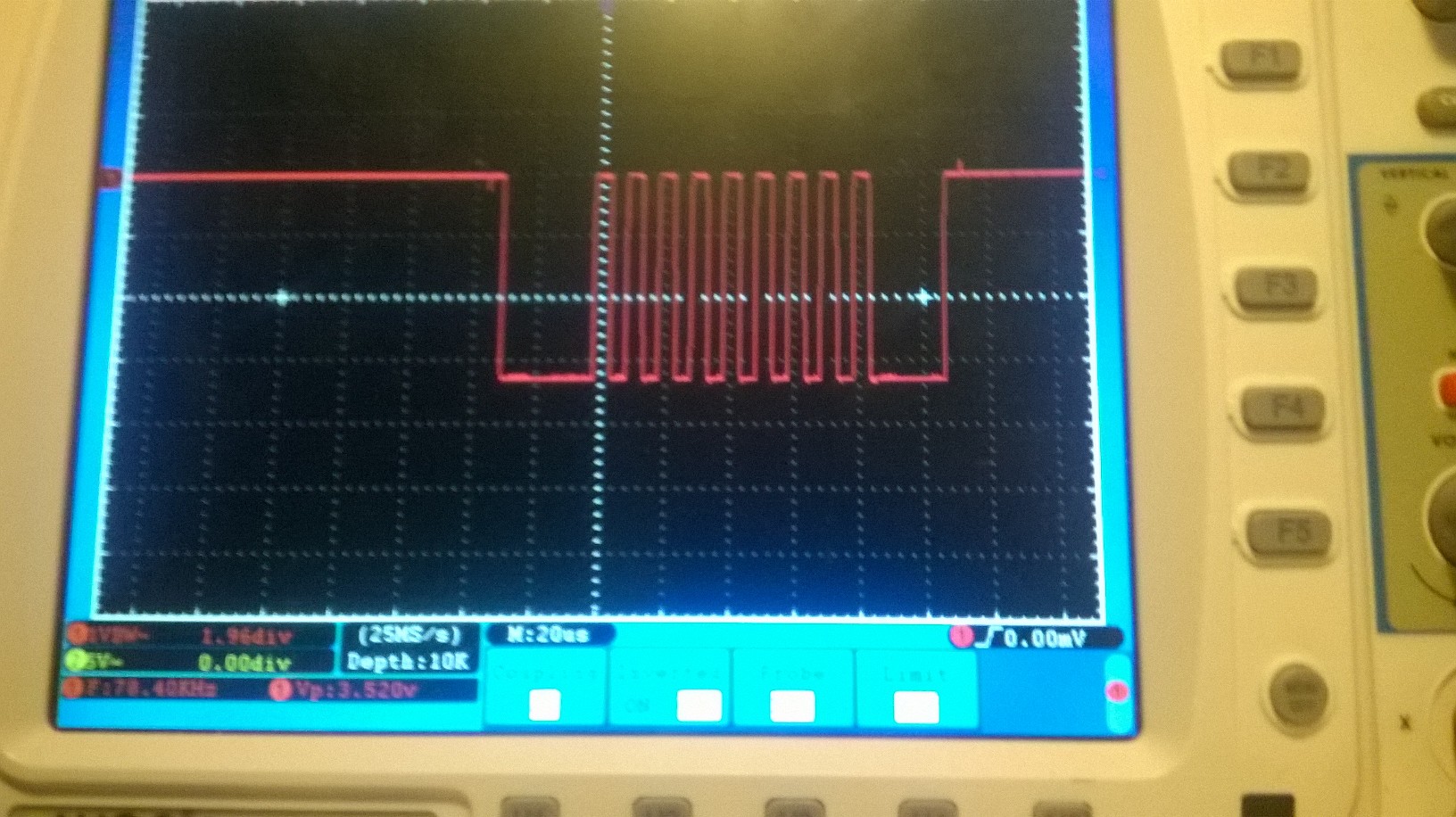

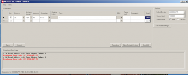

Thanks again for the answer. May I steal som more time from you please... I do see things happening on the SCL and SDA lines as I hit enter in my terminal application but I get read error code.
I'm puzzled how to use the input fields. The field "Data" seem to indicate how many bytes the read operation shall do. Can you see any obvious faults in the settings? SDA and SCL scope shots using one-shot trigger.
Thanks for any help here 🙂
TNT,
I use an Arduino. The device address is 0x4B. Acko used the device address when the pin is pulled high. (The BIII pin is low so it uses 0x40.)
