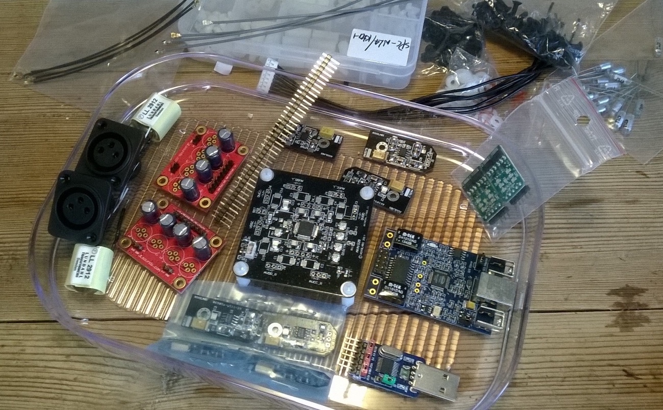

Haven't built mine yet 🙁 but I think I have all the parts. Got a miniStreamer. Chopped off the RCA because it would nit fit my box. This autumn 😉

I'd like to try the Acko ADC, I currently have the 8ch Ackodac and MCU. Will I be able to use this controller to program the ADC as some have done with the two channel DAC MCU?
Will some(all) of the TP trident regs that I use to power my DAC work to power the ADC? Would like to
Experiment with my current hardware to get it working for vinyl rips before a final config.
Also I will try with the USBStreamer, but has anyone tried the usbpal? As it's higher res.
