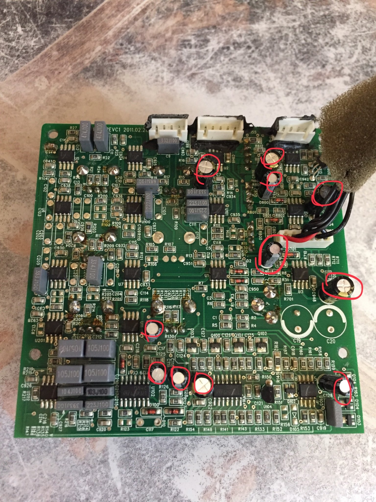

So so so. I solved the problem. The problem was not in the board where the capacitor burned out. There is 1 more scheme. All electrolytic condensers on it had no capacitance. If your speaker is playing quietly, replace all the condensers -> 25v 220mF 1 piece, 25v 100mF 4 pieces, 25v 22mF 5 pieces, 35v 47mF 1 piece.
Then I changed them on the work speaker, because after checking they had 50% capacitance

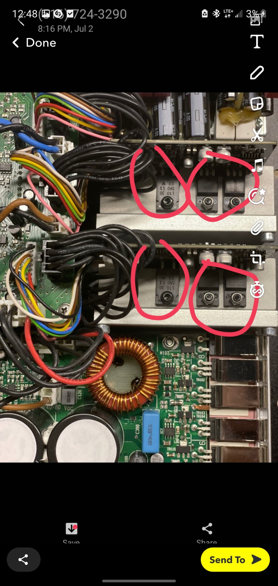

Does anyone know what parts these are on the s3xh motherboard amp section. They need a replacement and they are coded. No way for me to figure out what they are so I can replace with an equivalentGentlemen,

Left side looks like a Vishay LTO 30 resistor for heat sink mount.
Right side transistor type not visible in your pictures.
I read 5 Ohms.
If your serviceman is not able to identify the parts he should absolutely not try to "repair" this.
Even if the part is coded, a serviceman should be able to figure out what it is? I appreciate the infoI read 5 Ohms.

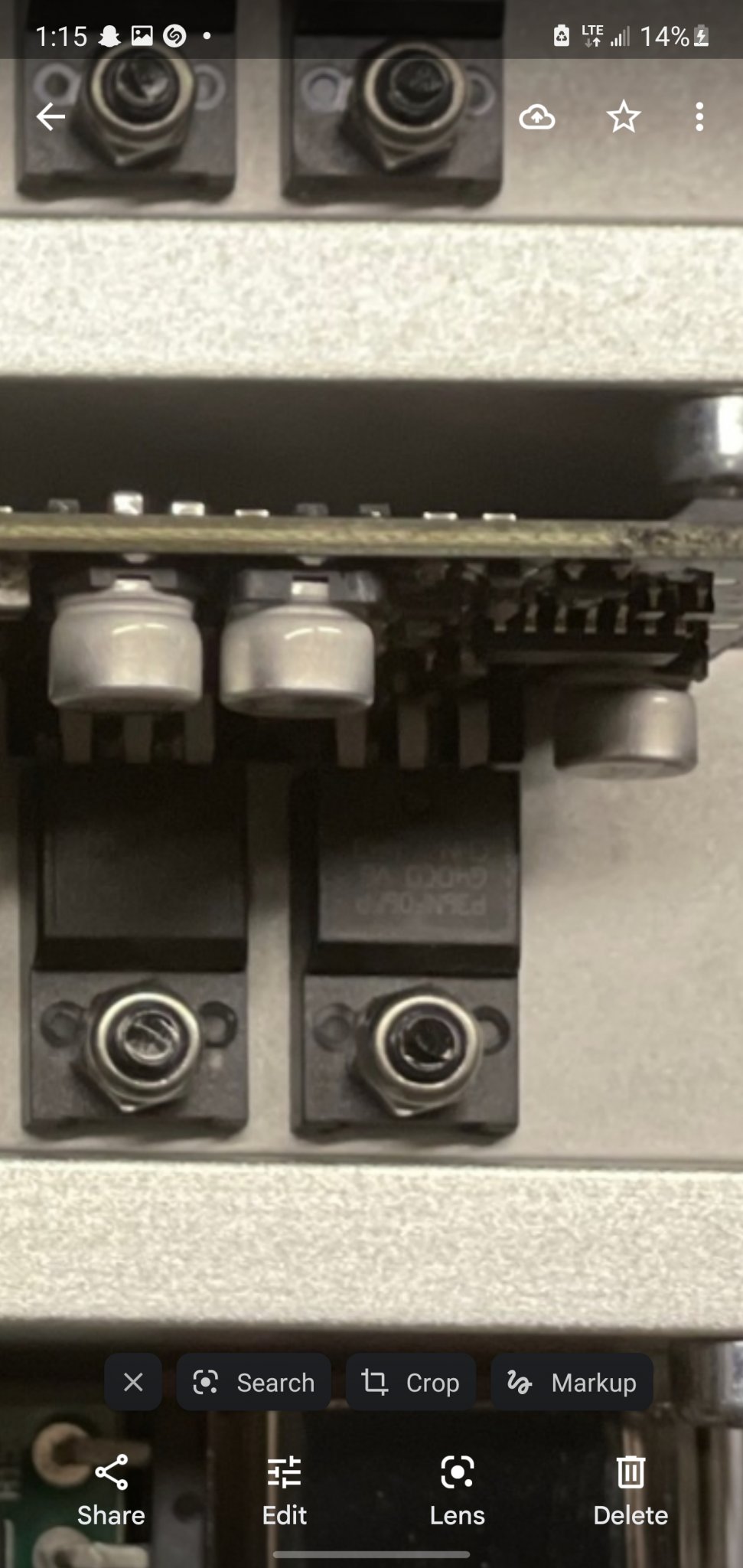

Here is an upclose of the right side transistor. Any idea?Even if the part is coded, a serviceman should be able to figure out what it is? I appreciate the info
Instead of sending blurry pics just read what is written on the parts.
Describe the type of error first, no speculation please.
I do not have the speaker right now the repairman does. As for the error. The speaker had just stopped indicating it was on. The led on front was off and no sound was being emitting through the speakers. Tested the lower supply and got 120v so the power is fine. Repair man said he was reading a short along the circled parts in the picture. Once I get the speakers back I will read the part numbers off to youInstead of sending blurry pics just read what is written on the parts.
From the picture I can see p36nf06.. g40C0 v6 if that helps at allInstead of sending blurry pics just read what is written on the parts.
The error must be in the supply I guess and not in the amp.
How have you "Tested the lower supply and got 120v" ?
"Googling" your type numbers the first one immediately leads to many results, the second one may be in error.
If your serviceman is not able to identify the error location and parts he should absolutely not try to "repair" this.
