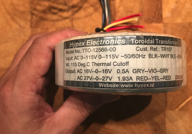

Do you still have the file for the p11a service manual? I'm looking to fix the transformer on one of my units and I'm thinking this schematic will help.
All went well on the p11a- the transformer developed a fault and was replaced by two series linked transformers to step down to the correct voltages - see photo for the voltage steps - Thanks for the schematic

Dear as_audio
What was the problem - open primary? Then I'd guess the thermal fuse went. I can't imagine something sourced from Hypex (even if it was 15 years ago) would have been too inexpensive, that may have been worth finding someone who works on transformers for. Anyway, as long as you managed to cram everything back in there...
BTW, two "series linked" transformers? I assume you mean two in parallel, one for 27-0-27 and one for 16-0-16 secondaries?
