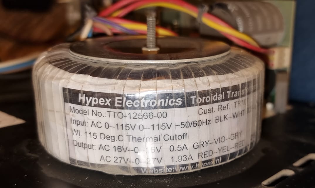

Hello,
I need a toroidal transformer replacement for Adam P22 Active Studio Monitor.
Adam don't have them in stock anymore.
Or maybe someone who can repair this one?

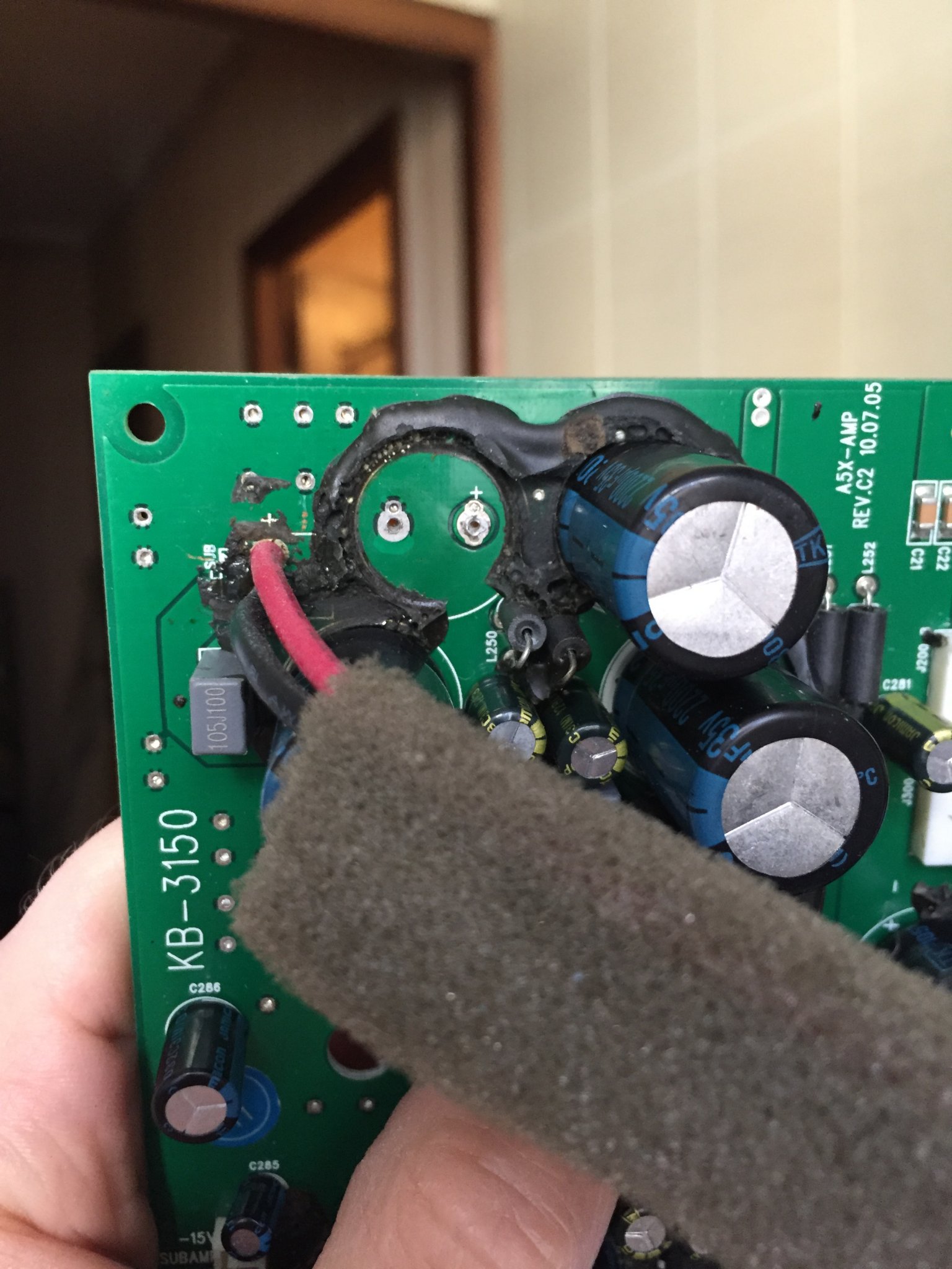

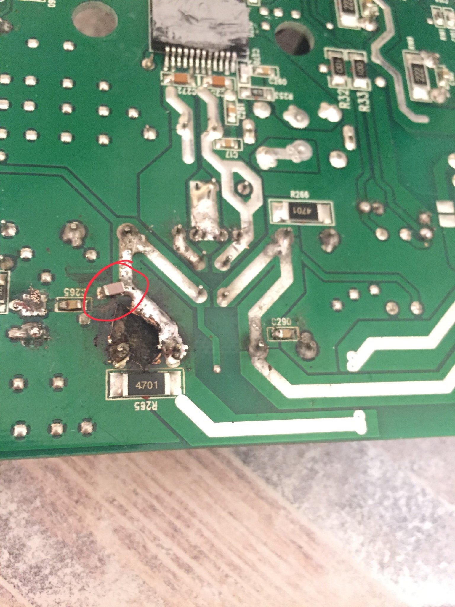

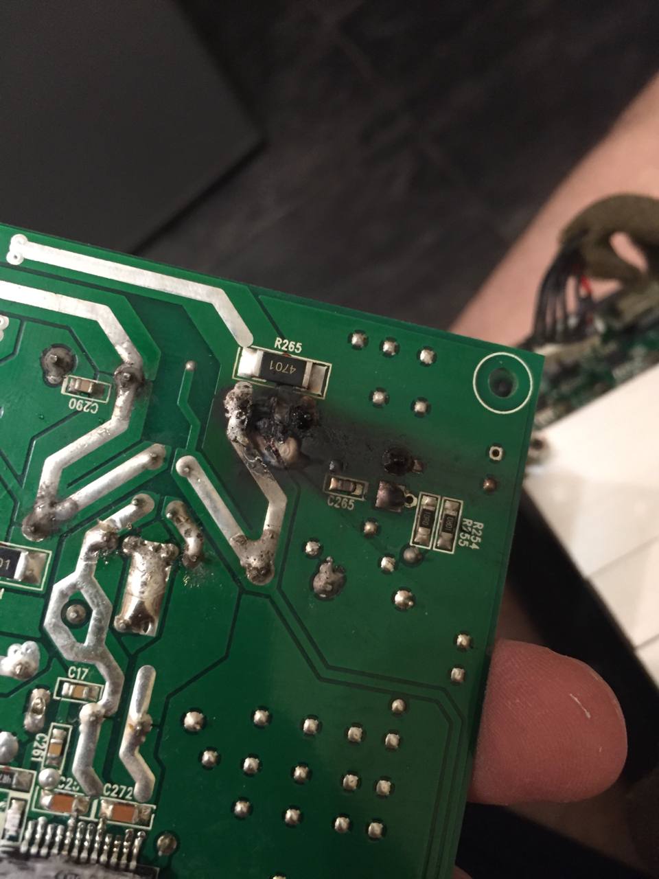

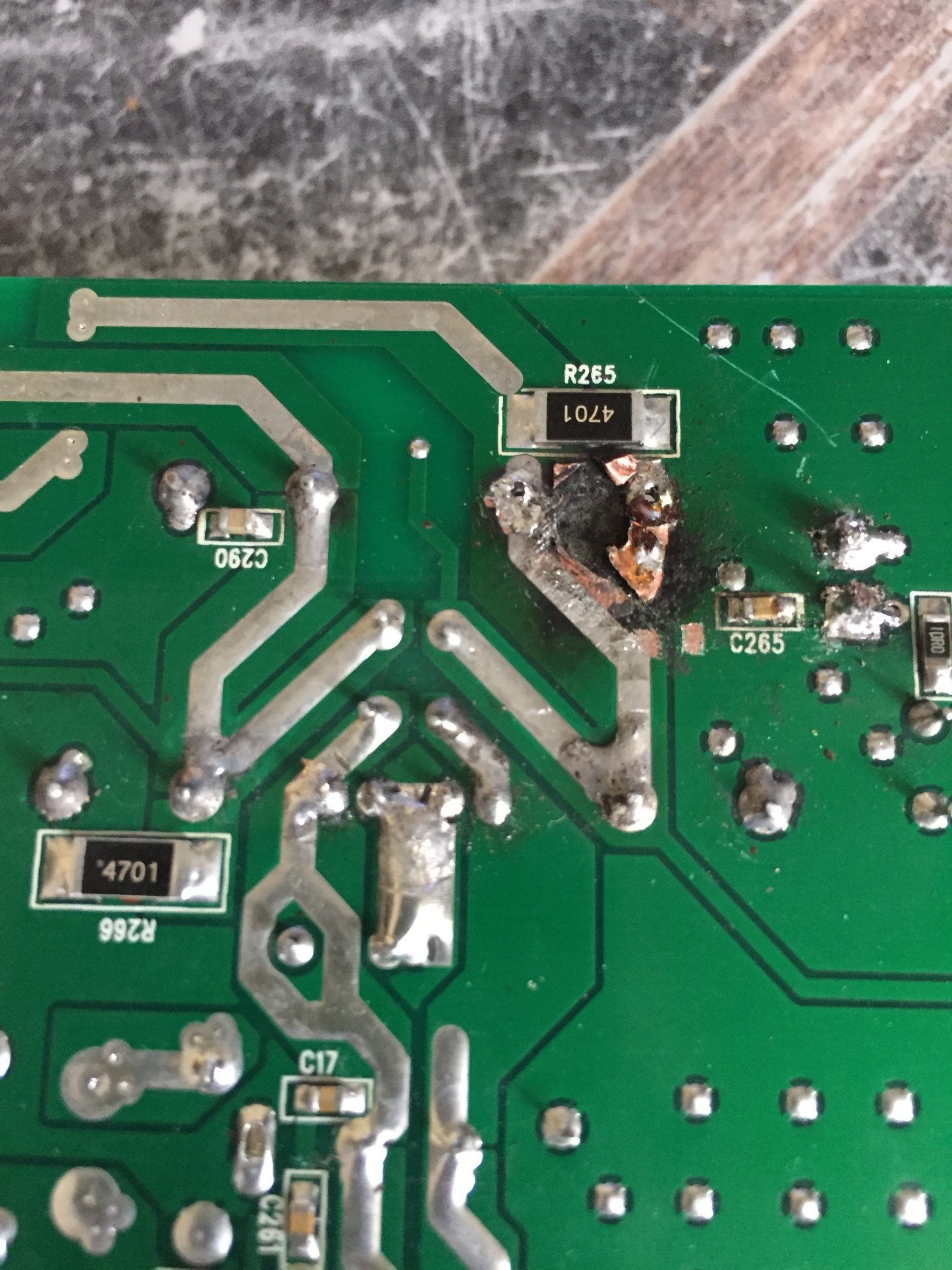

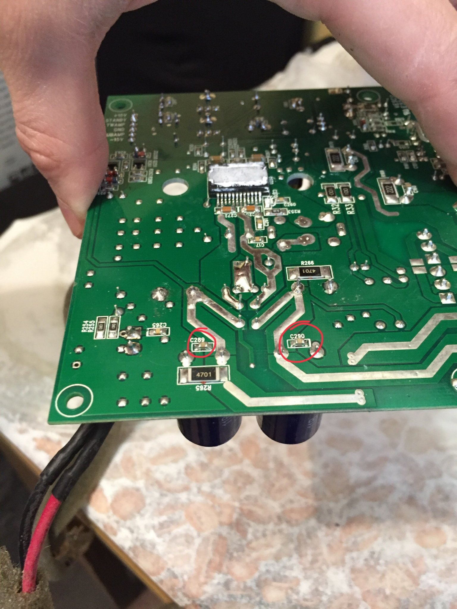

.. of course replace the copper tracks ..
So… Thank you for your advice. The schematic works without a burnt-out condenser… but I soldered it ))
I have a second problem. This monitor plays very quietly. I have a question - why? I changed ALL the electrolytic condensers… And nothing happened. He's still playing quietly!
Help me pls!
Full pictures required. Never recap a working amp.
Soldering may not be adequate, see for instance to the left of C265.
The fact is that the monitor was working quietly before the condenser (С289) burned out. That's why I replaced all the electrolytic condensers. I don't want to change TDM 8920 BTH (working amp)... but maybe that's the problem! What exactly amplifies the sound? (с265 in order)
