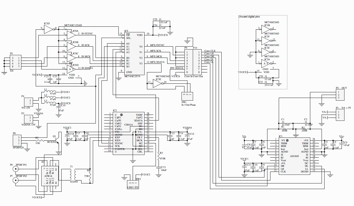

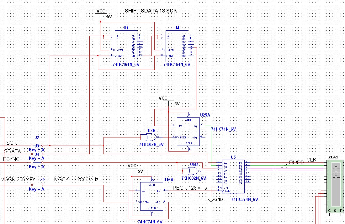

I took the ideas from Eric Juaneda's decoder and this is it (see attachment).Second option is to stop using any compensation and reclock using MCK from your I2S source to put everything in perfect sync. Good example would be Eric Juaneda’s decoder
The MSCK from 8414 which is Fsx256 is divided by two and it's used to latch all signals used by the AD. Everything is in perfect sync now.
As I will do my tests on perfboard I'm not sure the >11MHz MSCK will be happy. What do you think?
Thanks.

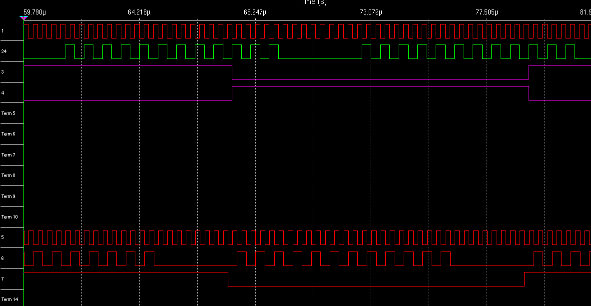

I'm using an evaluation Multisim 11 and the files sampler shared with us in post #233.What do you use to see the digital signals ?
D.

Nice
Run a shielded wire as short as possible from 8414, center pin - MCK, shield - AGND. Connect only center pin at logic side, don't make any ground loops, should be ok then.

It's nice that you removed the TL431 and used a separate salas reg for the analog part of the CS8141. I also like that the psu and dac are on the same boardI have new up dat for AD1865
Even if not asked I will say what I would have done: 🙂
- on DAC side: which is more important, I would have used smds for the CS PLL part (as in CS8416 data sheet) and solder the CS directly to the DAC board.
- on the PSU side: in my opinion, only one Salas reg would have been more than enough for the digital part, or even a simple LT1086. This would reduce board size and costs.

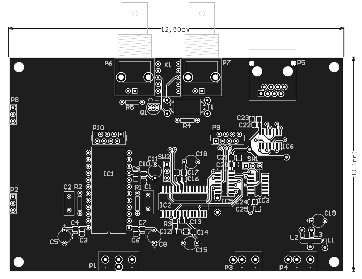

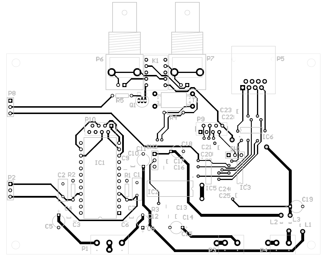

This is not the end yet... I started the PCB design for an I2S capable board. It will have CS8414, I2S shifter with I2S from either the CS or an external source and the AD. This (dev)board will also contain the plain inverter on it to have a comparison base of I2S shifted CS. As I'm doing it in my work time don't expect to be ready on schedule 🙂
After the above board is ready I would like to try to marry the AD with a Pass D1 I/V, but fall will come I believe until I will do that.

DAC v0.5
Hi!
I've been working with a snail pace on a DAC development board based on AD1865. I call it a development board as it contains daughter board connectors to try different AD1865 format converters.
It contains the followings:
- AD1865 using passive I to V conversion as Audiodesign/Quanghao did
- SPDIF receiver based on CS8414
- 2 X relayed SPDIF inputs using BNC connectors
- AD format converter board connectors (see below)
- I2S buffered input using RJ45 connector
- Multiplexer IC to choose between I2S or SPDIF
- Input selector to choose from I2S or SPDIF
- Input selector to choose SPDIF 1 or 2
- Separate supply inputs for analog AD1865, analog CS8414 and a single common digital supply input
- Jumper selector to select CS8414 output format LSBJ or I2S
- Jumper selector to select in phase/out phase data
- Common top ground plane. Although the ground plane is common for analog and digital side I tried to partition the board to have analog ground at the bottom part and digital ground at the top
The daughter board that will be connected between P9 - P10 (in 90 degree angle) might contain from a simple inverter (to match LSBJ signals from CS8414 to AD1865) to a fully featured I2S converter.
As I'm new in high speed PCB design please help me with your ideas about what should be done to have a good DAC board at the end.
Thanks,
Zsolt
