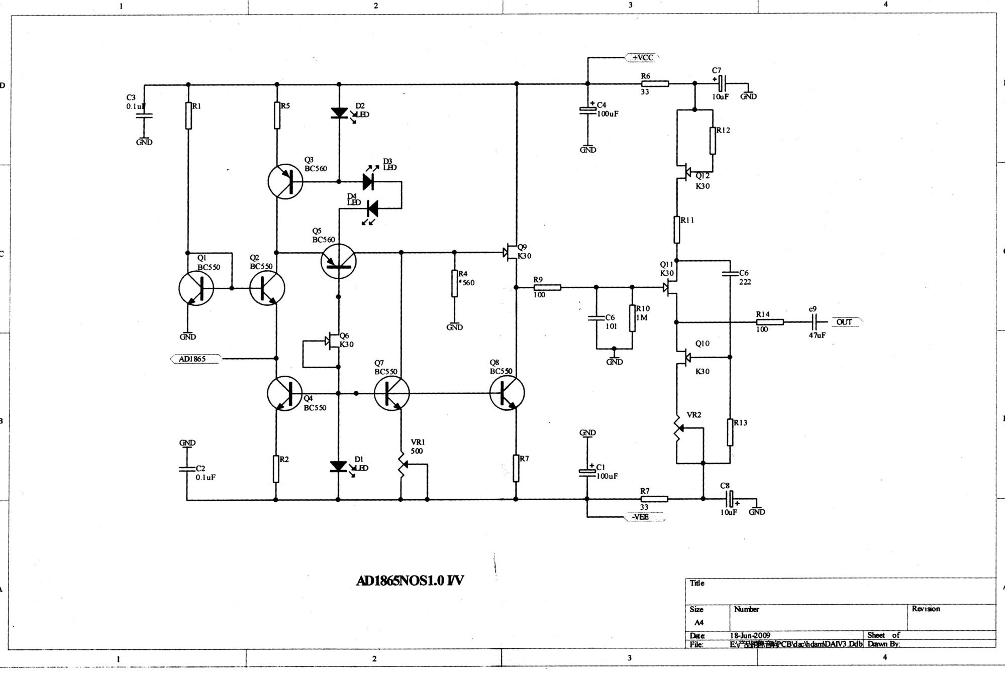

I have these one DAC
And only output stage
Everything working fine but sound is poor, weak, not smooth!
Maybe the somethnig is wrong adj. with those 2+2 h. trimers?
Any suggestion will bi fine!!
Thanks.
Regards zeoN_Rider
schematic
I/V schematic
