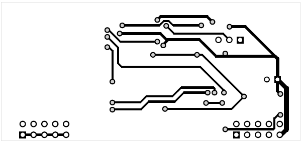

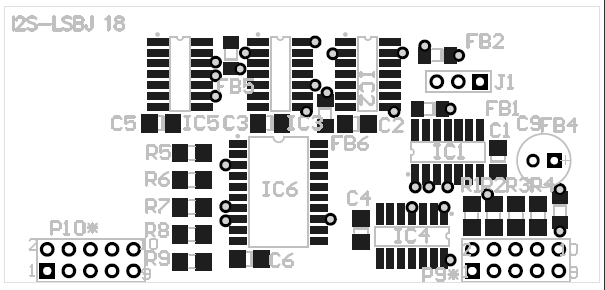

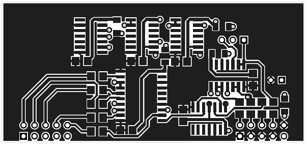

Here comes the "simple" converter from 24bit I2S to 18bit LSBJ.
!!! IMPORTANT!!!
Note that this converter uses a 256 x fS master clock to reclock the outgoing signals to have everything in perfect sync (see post #263 in this thread).
Most I2S out devices (e.g. CS8414 or PCM2707, TAS1020B) have 256 x fS master clock available but the I2S bus specification does not specify this signal.
Would be great if somebody could review the schematics and PCB 🙂
!!! IMPORTANT!!!
!!!! The images are not scaled to the previous DAC images
