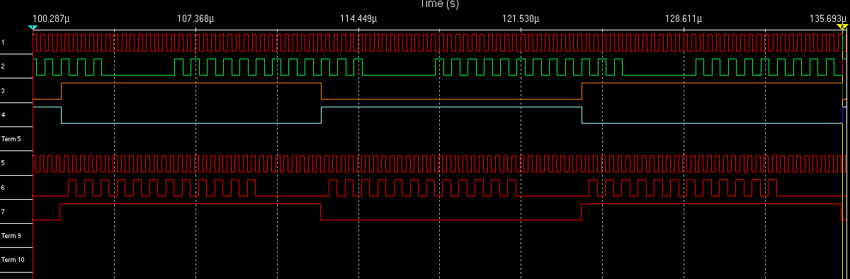

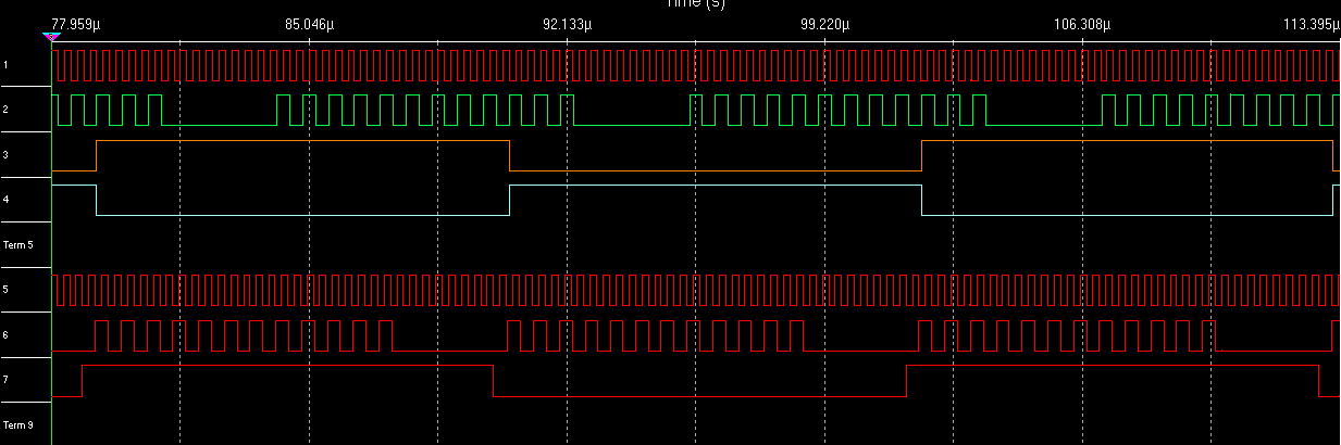

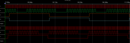

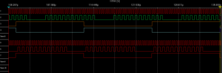

I downloaded an evaluation MS11 and played with sampler's files (thanks!).

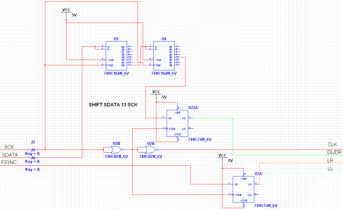

By shifting SDATA with 13 clcks and using the second flip-flop from HC74 I reduced the component count to only 4.
(later edit: ) I realized that I need to shift 14clks if I use the second flip-flop for the LR/LL.
