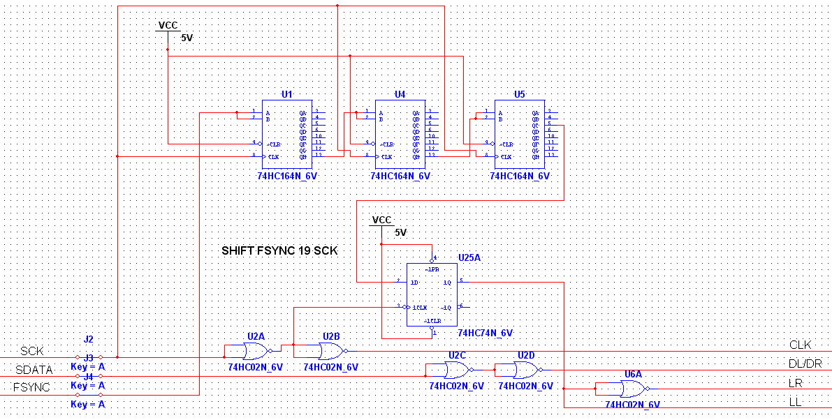

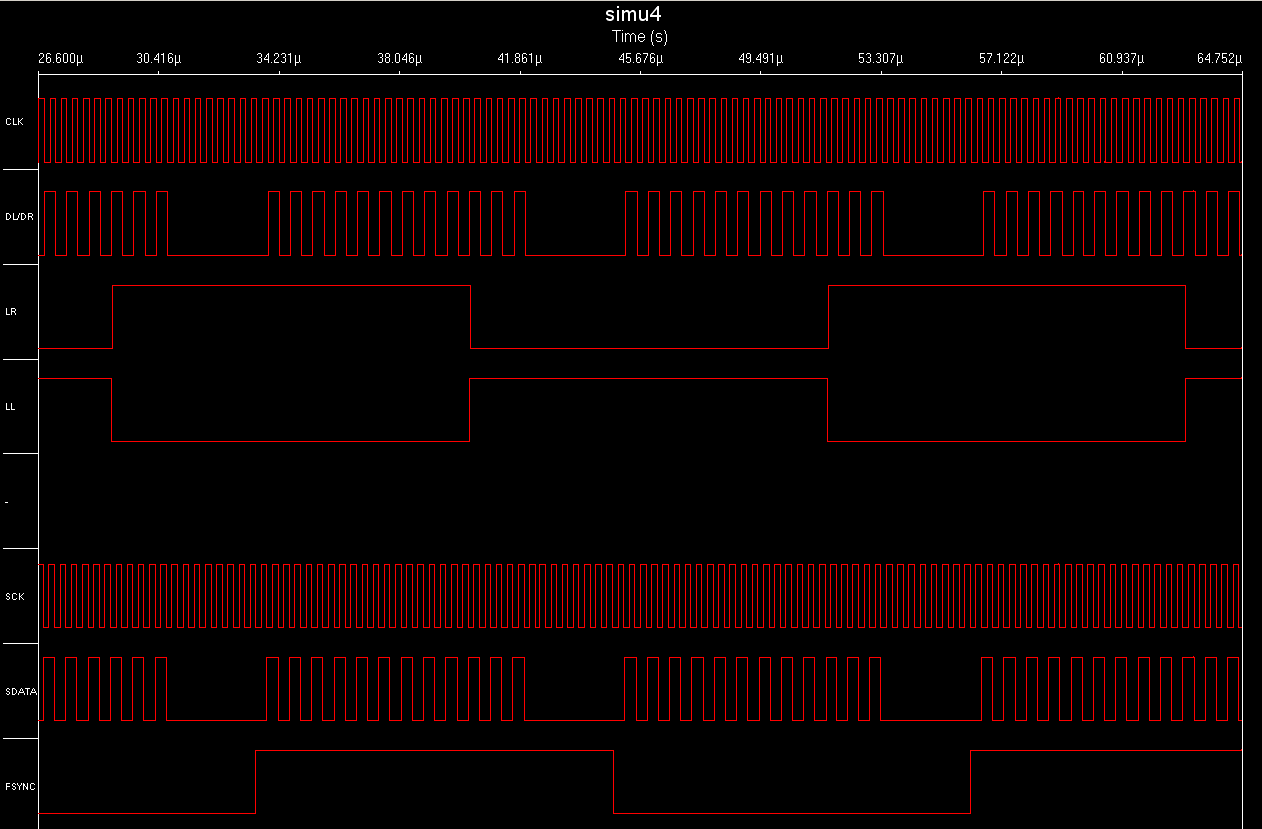

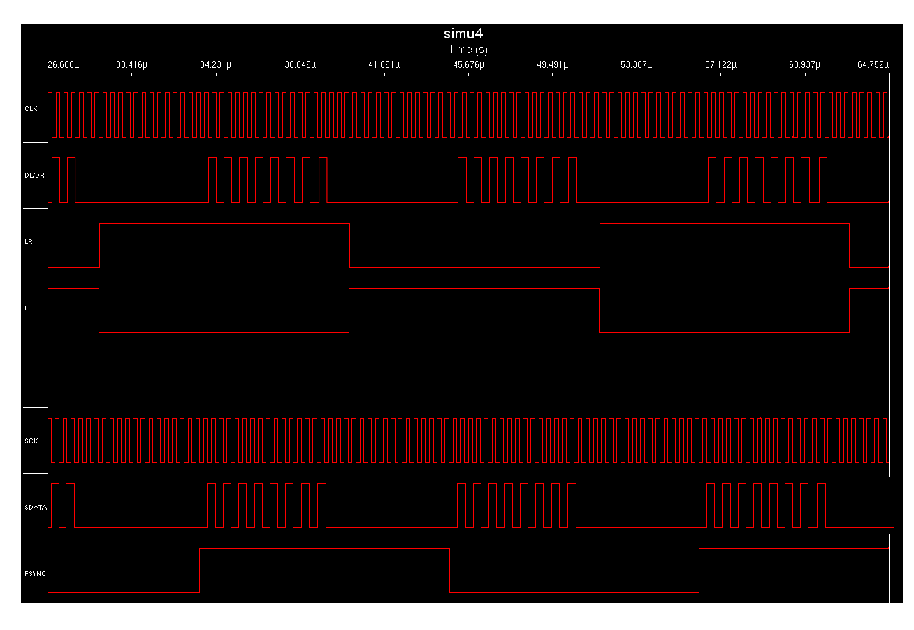

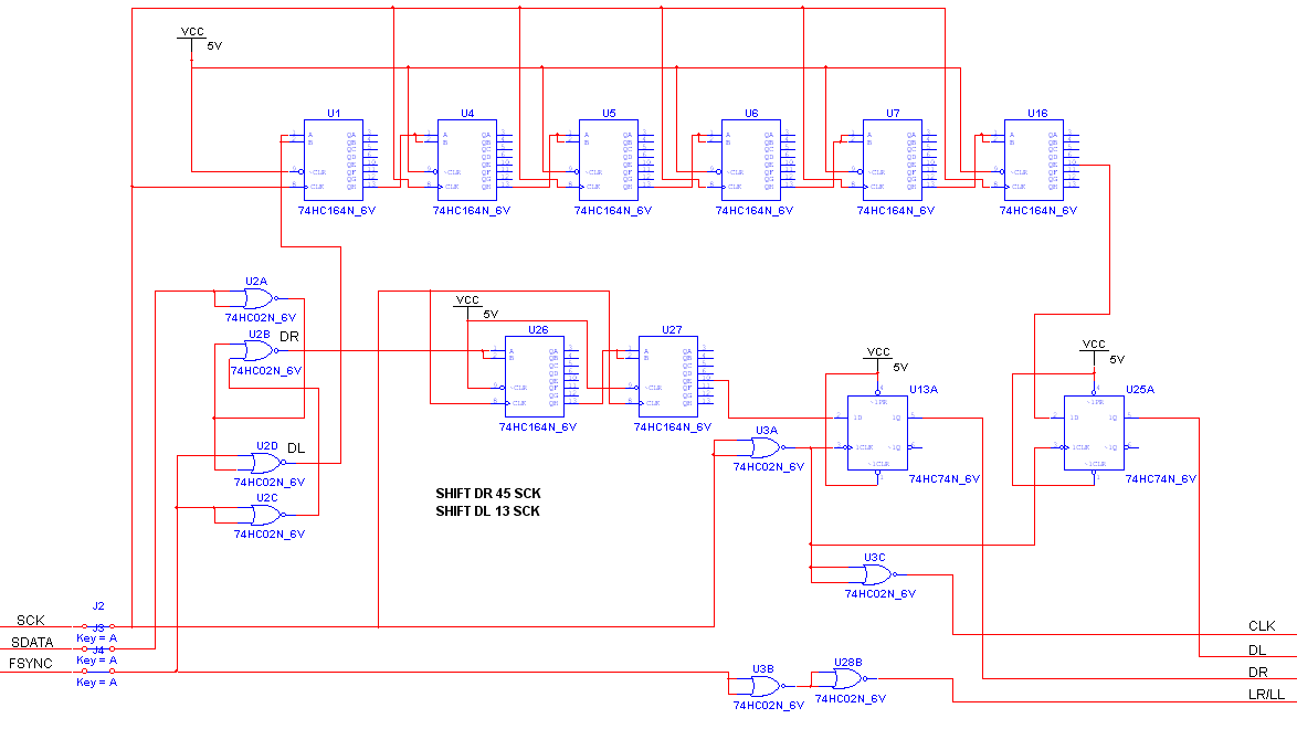

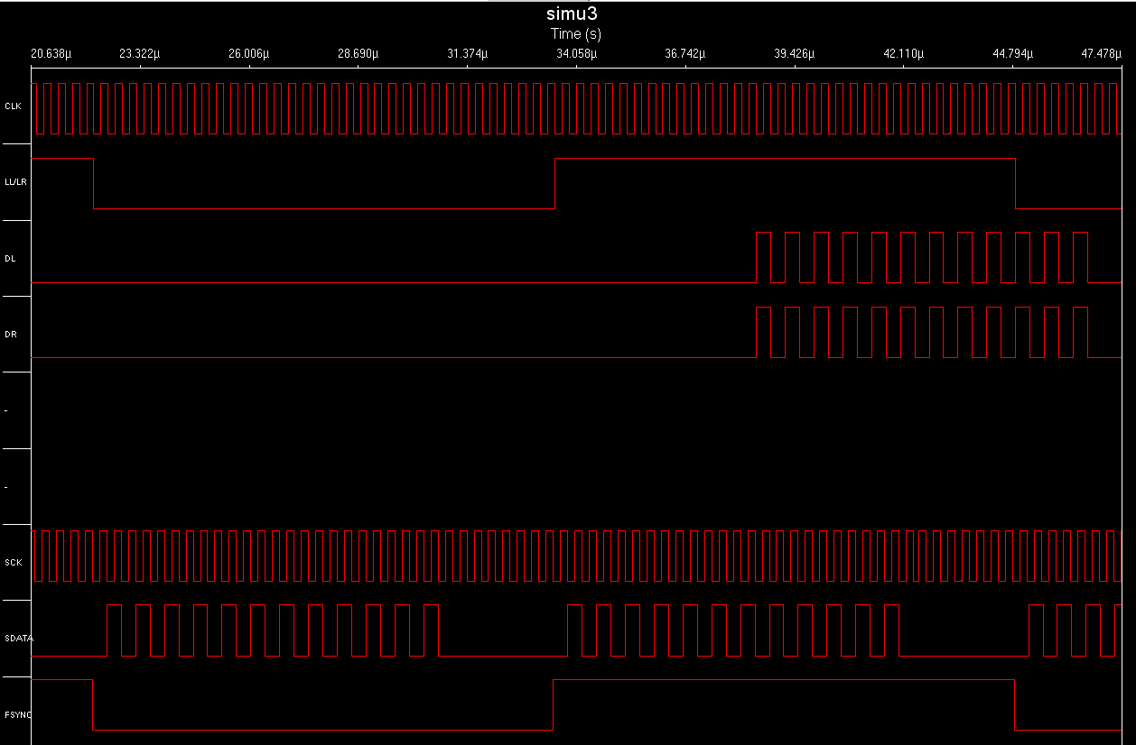

Some updates.
Source is 24bit I2S. Two versions, one shifting FSYNC by 19 CLK as proposed by vzs (not 13, as only 12 bits are latched in that case), and second "for purist eyes" shifting data properly for AD1865. Extra buffering was applied in both cases for signals that are not shifted to get everything in sync. In first version, only inverted LR is out of sync by HC02 propagation delay. In second version everything is in perfect sync, that is according to multisim of course 😉
There is a couple things that worries me. In both versions data is 24bit words. In first version each DAC channel gets leftovers from another one (6bits). That's maybe not the biggest problem, as 1865 transfers just "last 18 bits which were clocked into the Serial Registers to be shifted into the DACs". In second version, no such problem exists. Now the funny part. What happens when word is 16bit length ? Last 2 accuracy bits will always be 0
Is this the way it's supposed to be ? I'm wondering how this is implemented in such a receivers as CS8614. Outputting 18bit word from 16bit received data. Anyone care to explain ?
Now the funny part. What happens when word is 16bit length ? Last 2 accuracy bits will always be 0Is this the way it's supposed to be ? I'm wondering how this is implemented in such a receivers as CS8614. Outputting 18bit word from 16bit received data. Anyone care to explain ?
Last two bits will be zero all the time. This is normal. It is working on this way with CS (18 bit EIAJ output mode) also.

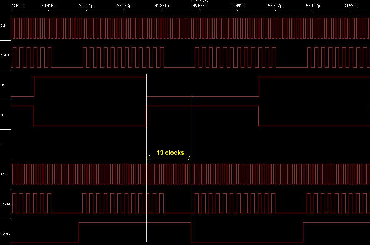

Actually I was referring to those 13 CLKs (see attachment). I'm still wondering why 32-13=19 CLKs has to be shifted... but I will figure out hopefully 😛 Today I'm a bit heavy-headed...
Ok, so no problem there, thanks.
