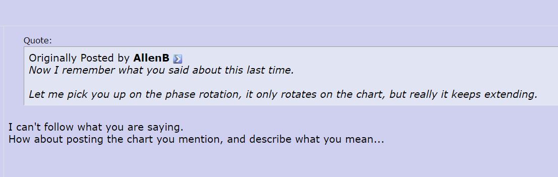

The reason processors have delay is because canned filters don't have the versatility to be useful without it. Otherwise, delay isn't strictly a necessary thing to have.
How can you quote me, and give a comment completely off the topic that went with the quote?
Here's a snip of that quote and the exchange that prompted it, from earlier in this thread...
How about stopping and answering that phase rotation stuff?....
....Before i ask you about today's comment...which I can't follow either...
I'm saying "I can't follow" to be polite and see if i'm missing something necessary for understanding your posts...
It's either ask for some explanations, ...or give up and declare them total nonsense....

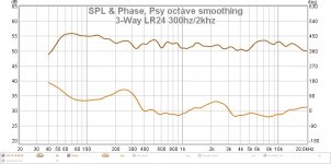

It's not too hard once you know the difference between room/diffraction effects and speaker response. Can get closer to linear phase if you set your delays right. This works best with a coaxial, mid/tweet fullrange, or low crossover tweeter.
Flatten your drivers passed their intended passband, delay your mid relative to your woofer a cycle or two, do the same for the tweeter. This was done in about 10 minutes. It can be optimized surprisingly well without FIR.
