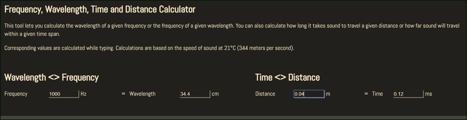

I'm not sure if you are in the right ball park? It should be under a millisecond if not a horn? My 4cm distance between the voice coils got only 0.12 ms with mic measurment.
and seems to be right in a calculation as well:
Frequency, Wavelength, Time and Distance Calculator

Aha it seems right. That's really close compair to my drivers 🙂 Does really 3,7mm needs a delay?
