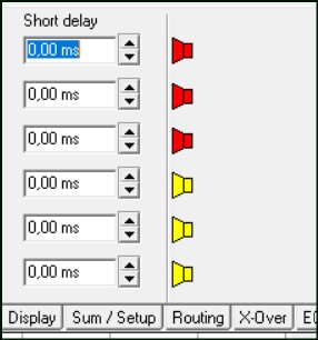

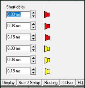

The testing was kind of semi-blind. I asked my friends to select which of the three settings they preferred using the Hypex remote without any information about the differences. They all picked the same setting.
The treble level was as close to identical before and after the tilting with the "tweeter axis" going from slighly below the ear level to slightly above.
You are correct that placebo in many cases is strong, especially when it comes to HiFi, and I can't confirm the effect with measurements. Still the percieved improvement is significant.

Updated report from the field:
A listening session with some friends ended up in that everyone, including myself, preferred the "frequency aligned" approach compared to the "delay aligned" approach even with the clearly audible frequencey response drawback.

The method I have used so far is to first do a distance only based delay (see post #5) and then do a phase alignment by adjusting the crossover frequencies to different values on LF an HF side.
