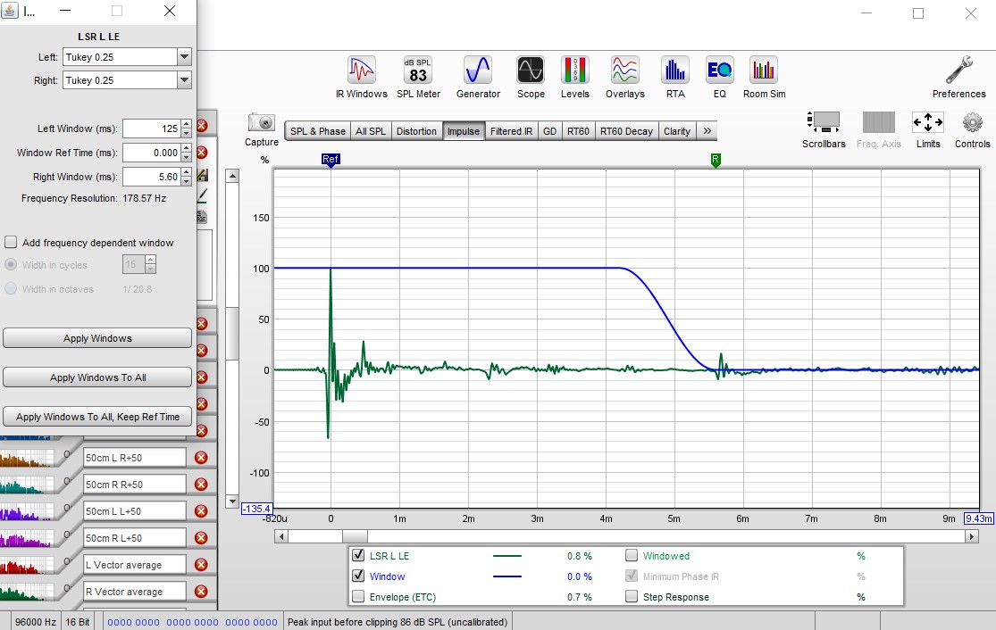

There isn't much to using the windowing function in REW.
Here is an example, it's the only measurement I have saved of a standard speaker placed in the middle of a room.
attachment.php

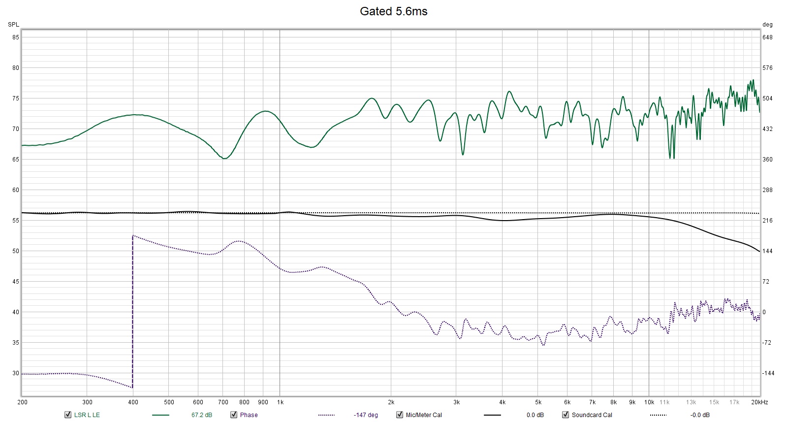

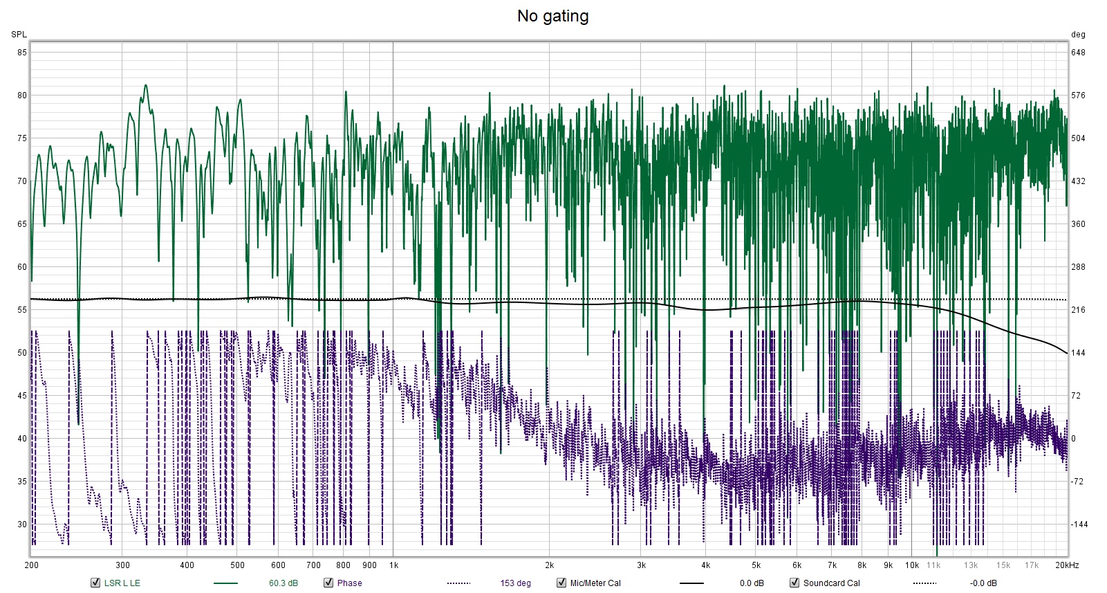

By looking at the impulse response you can see where the first significant reflection is and window the response to cut it at that point. I have chosen 5.6ms in this case. The type of window makes a difference as the shape of the blue curve shows the window.
I've attached some mages below that shows the difference to SPL and phase.

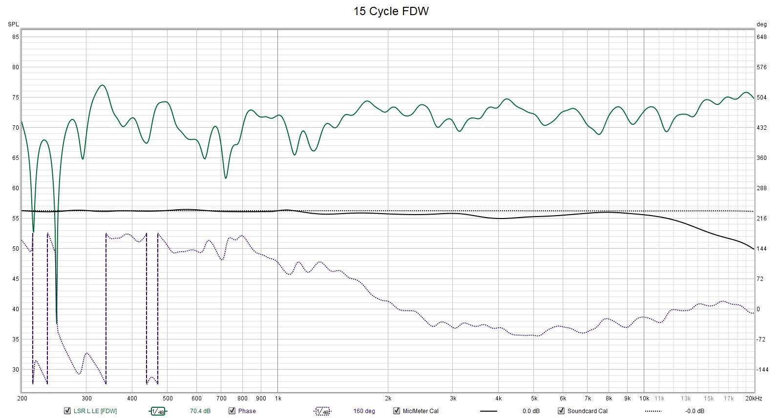

The other option which can be useful for full range in room measurements is to use the Frequency Dependant Window function, where there is a sliding window over time, longer at low frequencies shorter at high. In REW it is measured in cycles or octaves. Cycles means that that many cycles of each frequency are allowed through the gate.

You can create a filter for it based on a FDW'd measurement either manually with REW and rephase or automatically with something like DRC-FIR. The raw pcm output from DRC is the same format as a minidsp .bin file all you have to do is change the extension.
The other option to reduce room influence on your measurement is use vector averaging. Where you take multiple measurements at different points in space and use REW's vector average function the room influence will be reduced significantly above the transition region.
If you keep the measurement positions close to each other, within the space of your head, they will not be wildly different but the combined result will be more anechoic in appearance.

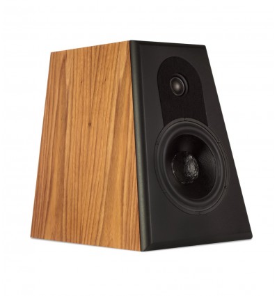

Last but not least the only published picture of the design which might make this text easier to understand:
(see also Hogtalarshoppen - Community | Facebook)
