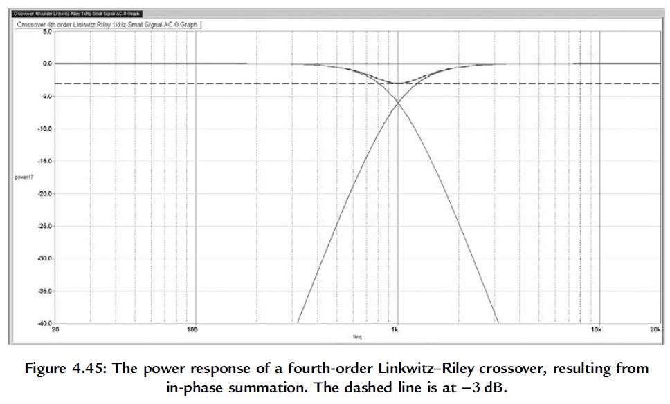

Douglas Self has some very useful information in "The Design of Active Crossovers" book with graphs that can help explain it. Because the crossover point is at -6dB in an LR there is 3dB power dip. The outputs are uncorrelated and when you RMS sum -6 and -6 you get -2.989.I wish I could understand understand what Rane is saying about power response dipping.

Like this, graph attached below from pg 89
Why are the outputs uncorrelated? If the crossover is working correctly they should be perfectly in phase at the crossover frequency. And I also thought that two speakers working at -6dB electrical power each would generate the same sound pressure as one speaker at 0dB electrical power.
There is another quote from the section on first order filters which explains a little more why the outputs are considered to be uncorrelated.
"The power response is shown in Figure 4.3. Since the two contributions to the total power are uncorrelated (because of multiple room reflections and so on), they add in an RMS-fashion; in other words you take the square root of the sum of the squares of the two levels".
If you go to a calculator like this one
Total dB level adding of incoherent or noncoherent uncorrelated sound sources
and go down to the section on adding of two acoustic levels you can see that adding -6dB to -6dB gives -2.89dB.

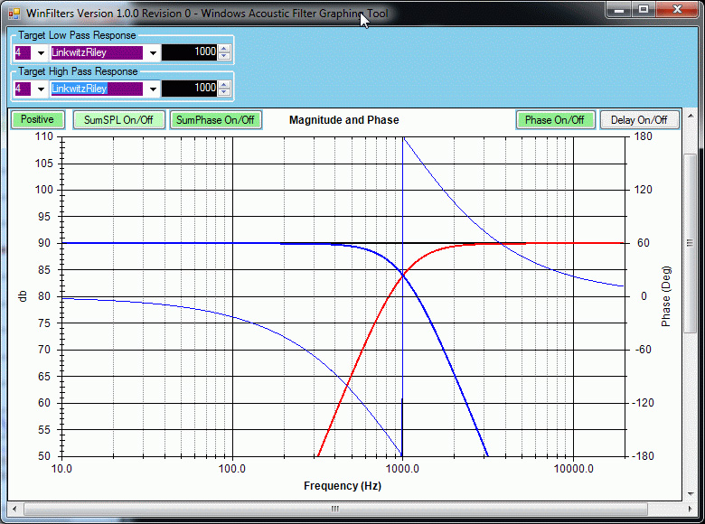

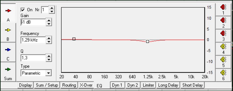

- Active LR4 crossover phase matching using a DSP
