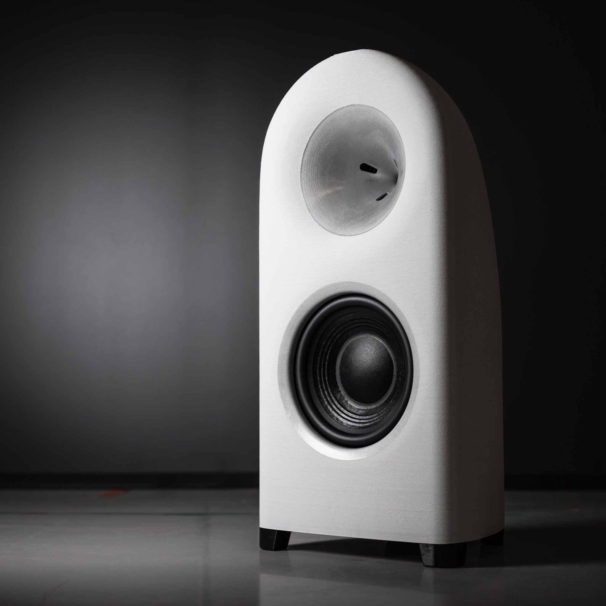

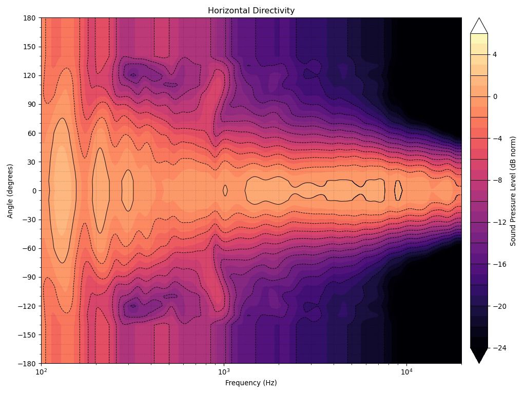

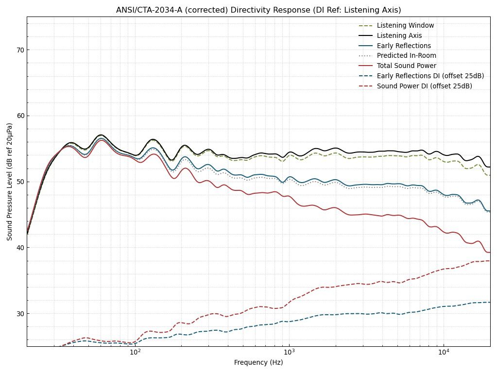

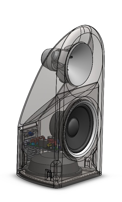

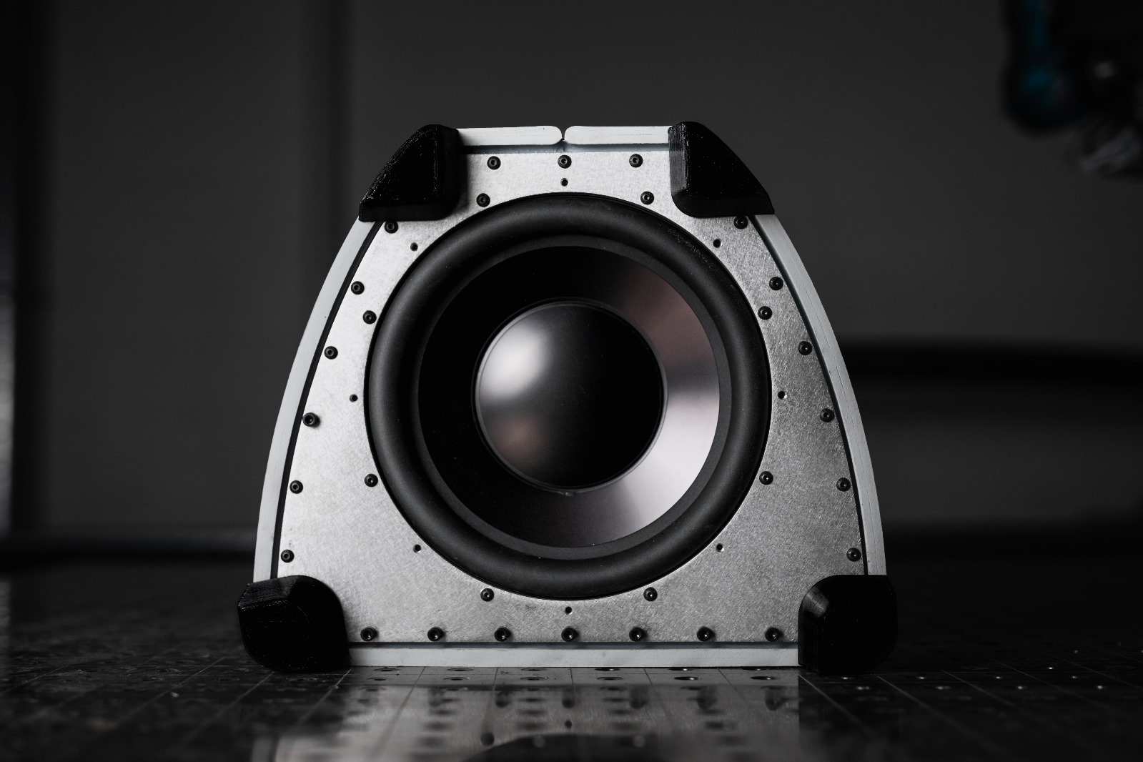

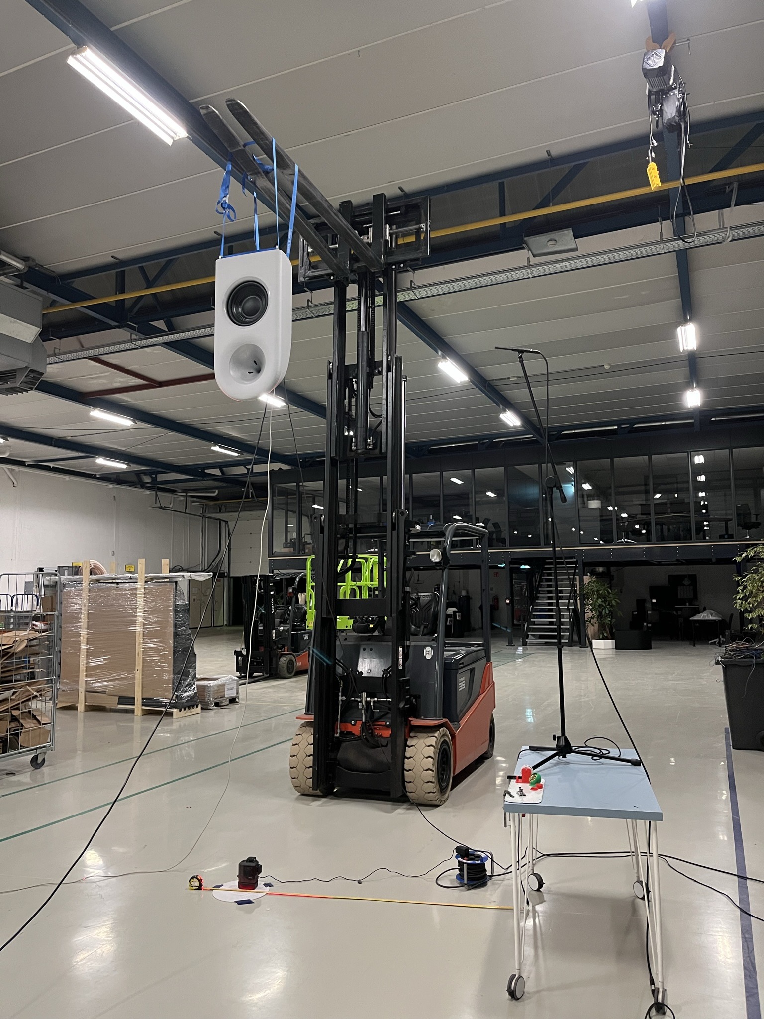

Amazing to see all the great projects people are sharing. Besides just getting inspiration from all people contributing to this forum, here's our two cents from Addit Audio.

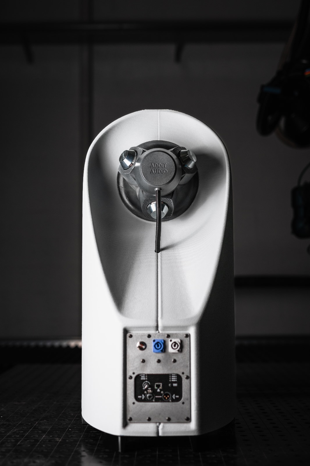

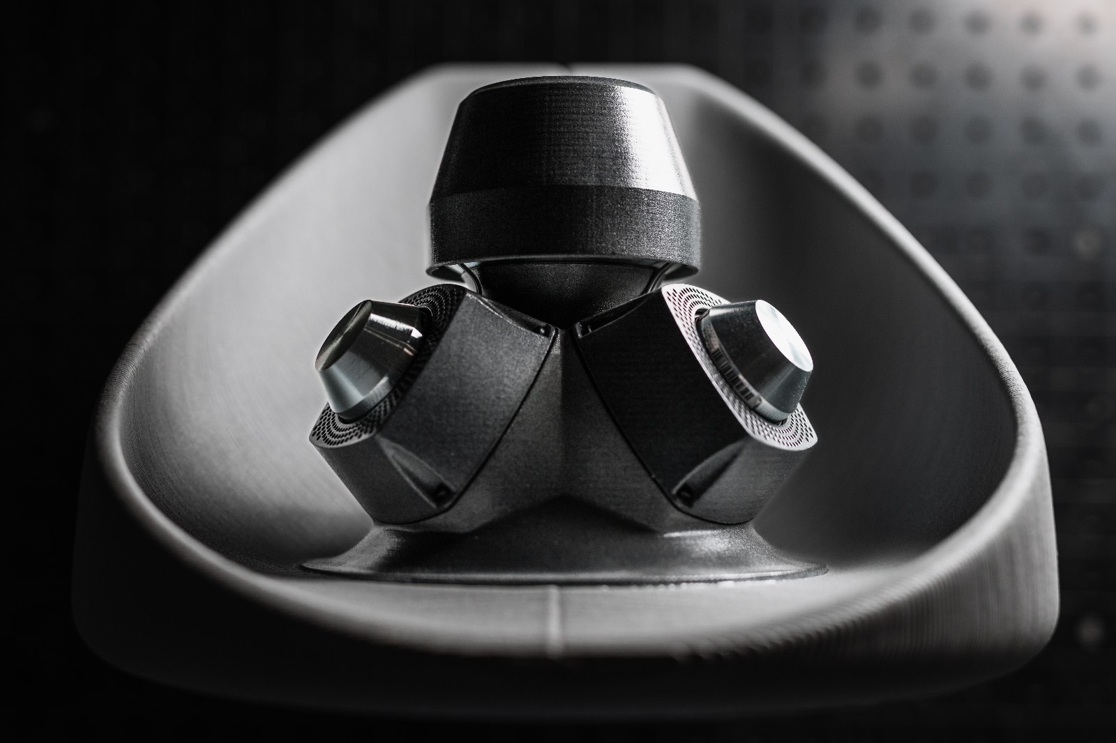

This is our take on a high output monitor speaker. We call her “The Monihorn”. The speaker features a 440mm ATH horn as basis with midrange ports for 3 4" mids. A 12" driver with a passive radiator takes care of the lowend. It's a 3 way design with DSP and amplification onboard.

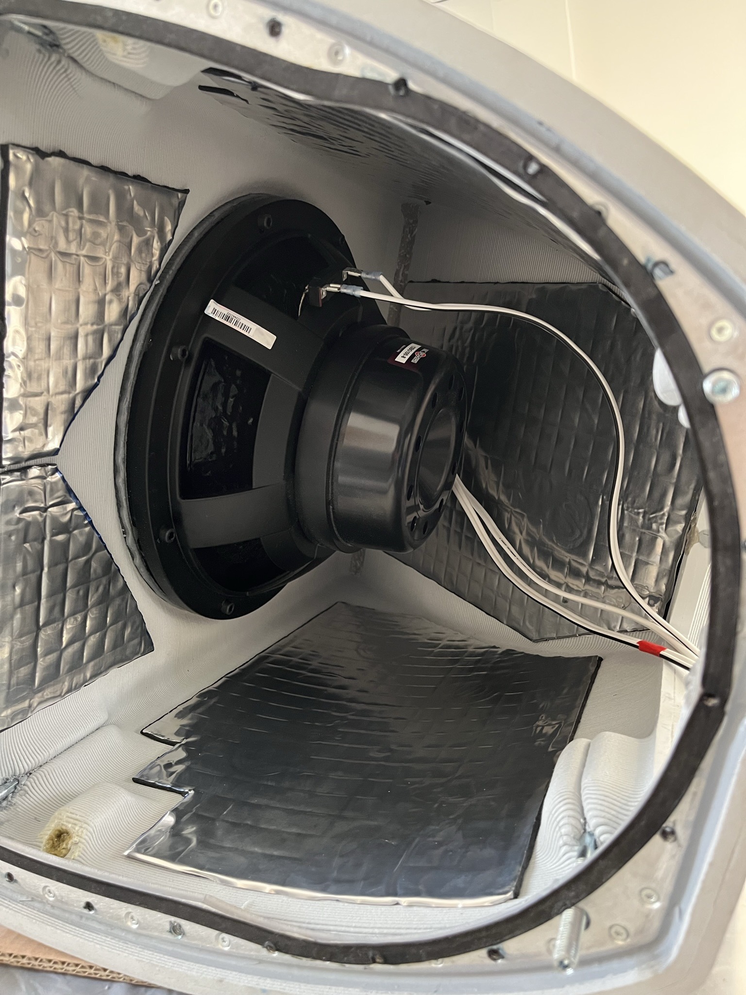

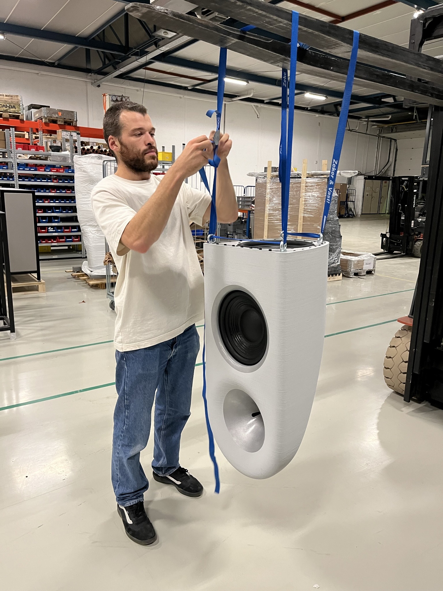

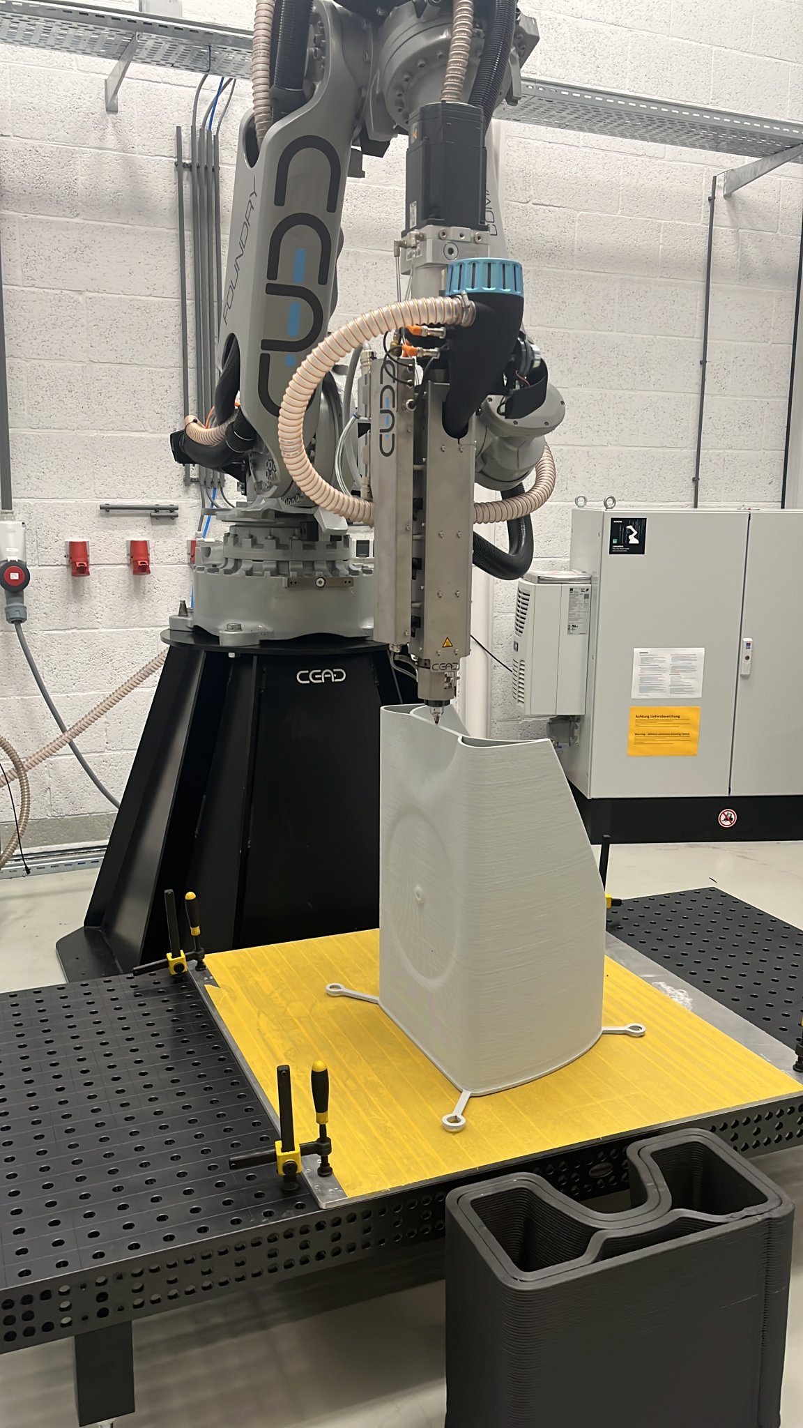

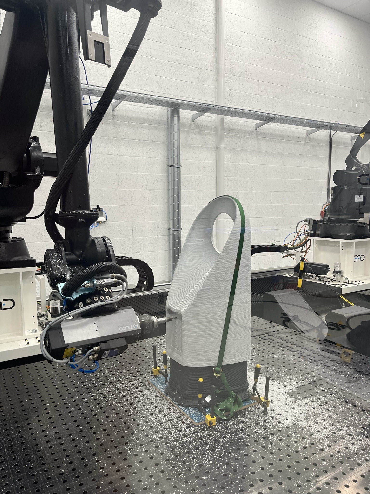

The cabinet itself has been 3D printed in one piece with a large scale industrial printer. Print time around 10 hours. Material used was PETG (post industrial recycled PET with 30% glassfiber) . The woofer and amp holes were cnc milled after the printing. Horn and woofer mounts are all 3D printed with a MJF printer. Foam was used to fill the hollow print for added stiffness and dampening. Essentially creating a composite sandwich.
Here are some measurements and photos from the process!

The speaker's a creative design, and the measurements look great.
But never mind the speaker. That is one hell of a CNC!
Aha! Now as you share the design in the "Make" thread, would you care to present also the other driver make and type? 🙂
Drivers:
CD - B&C DE250
Mid - B&C 4NDF34
Low active - B&C 12BG100
Low passive - Dayton Audio RSS315
MEH simulation and ATH params I need to dig up somewhere
CD - B&C DE250
Mid - B&C 4NDF34

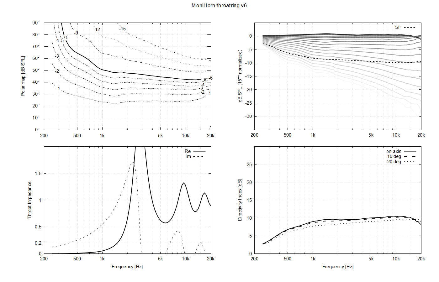

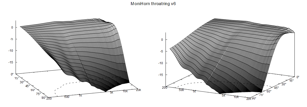

The design goals were (pretty standard):and tell us about the Horn MEH simulation/ ATH script?
- consistent DI (throat adapter to prevent beaming)
- wide coverage
- directivity control at least down to ~1000hz
Here's the ATH script for this version:
