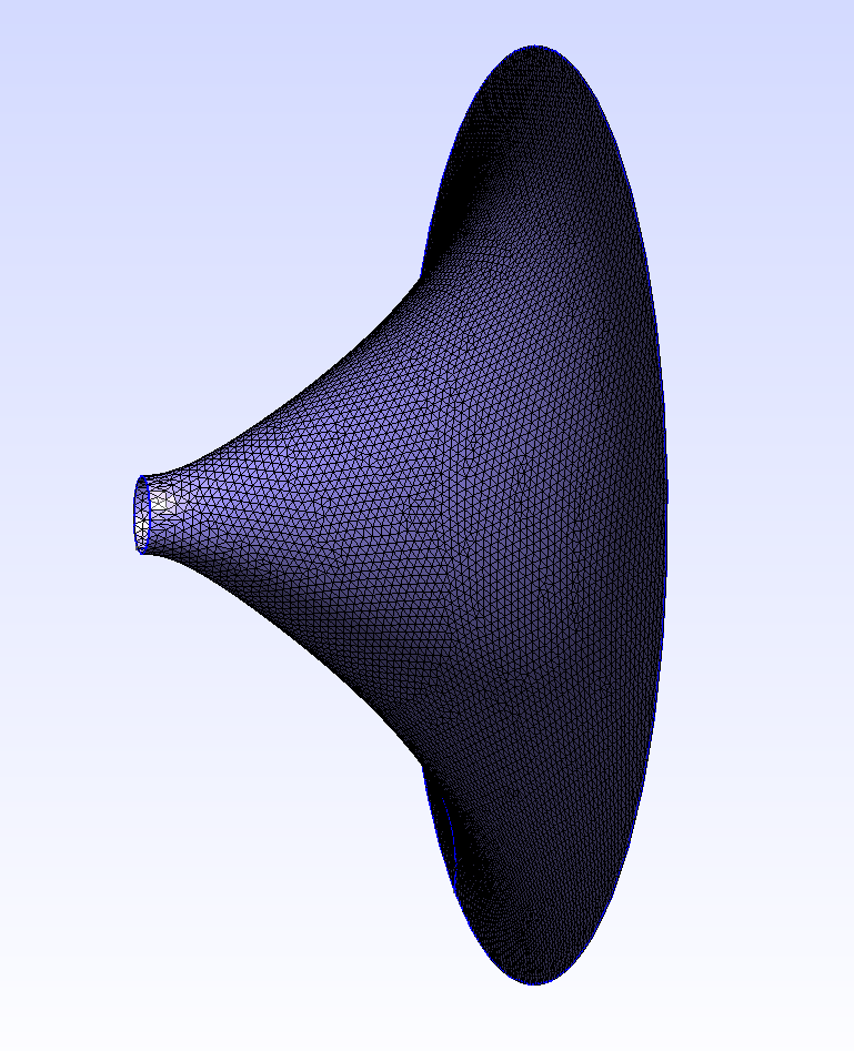

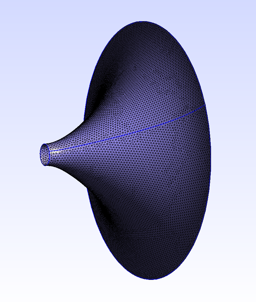

It was suggested to me to start a thread regarding the actual practical builds of horns and waveguides, mainly designed with the Ath. So here it is, for everyone to share their own way of converting their design into something real and listenable. Show off! 🙂
So far the tool can generate:
- STL file,
- coordinates files to be imported into Autodesk Fusion 360 as splines and/or smooth surfaces.
There may be other useful features implemented in to tool to enhance the practical possibilities - just let me know.
- STL file,

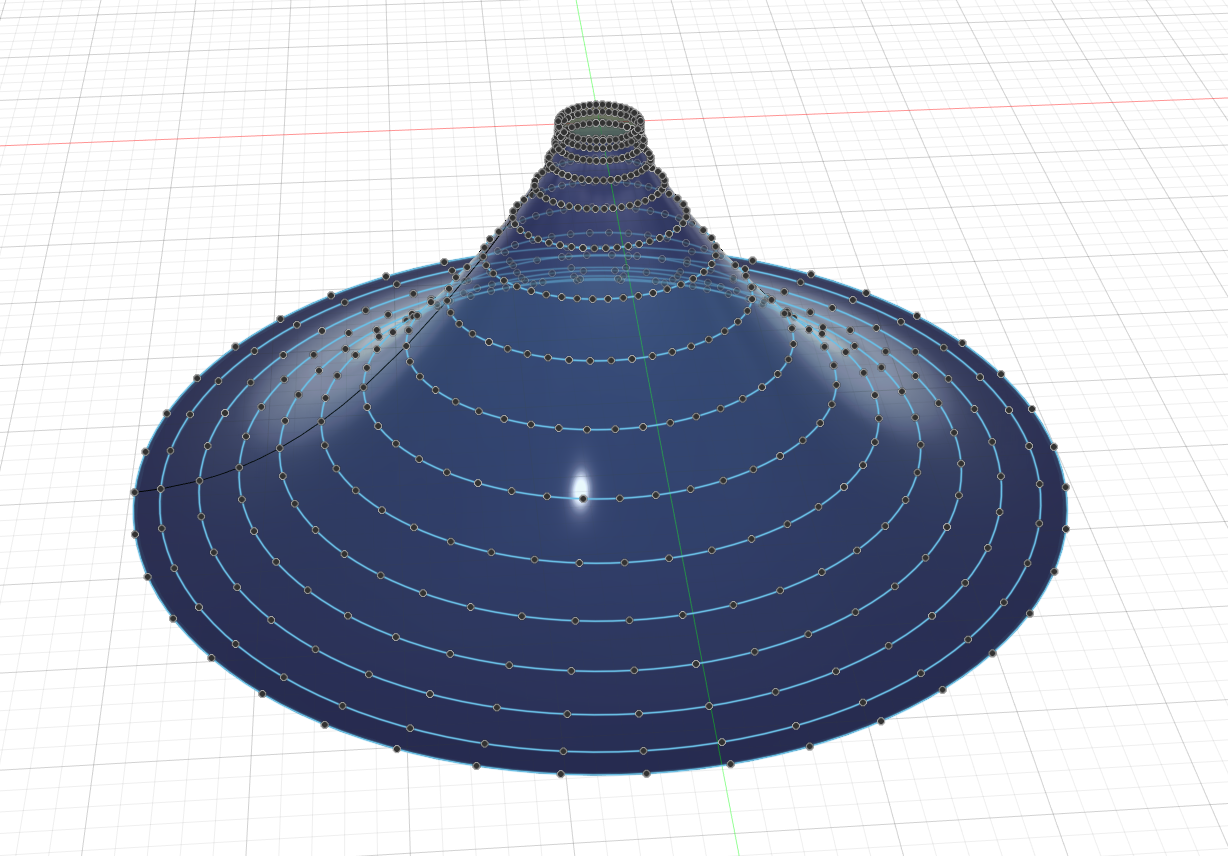

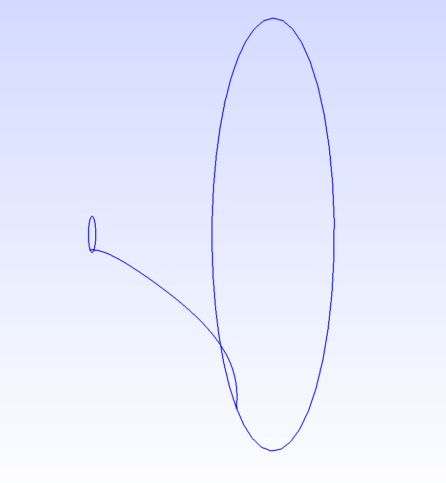

First, let me summarize how to import the shape into Fusion 360 since it is still not properly documented in the User Guide.
Definition file parameters (4.5.0 and above)
Output.Coords = true
Output.Coords.NumProfiles = 8 ; Number of exported curves in "_profiles.csv" file (default = 4)
Notes
Two files are created in the project folder:
<project_name>_slices.csv
<project_name>_profiles.csv
Now there are two Add-Ins for Autodesk Fusion 360 included in the Ath package:
Ath4_CurvesImport - used for spline-only import, can be used either with the "slices" or the "profiles" file
Ath4_SurfaceImport - used for lofted surface creation from the "slices" file.
The number of curves in the "slices" file is controlled by Mesh.DepthSegments parameter.

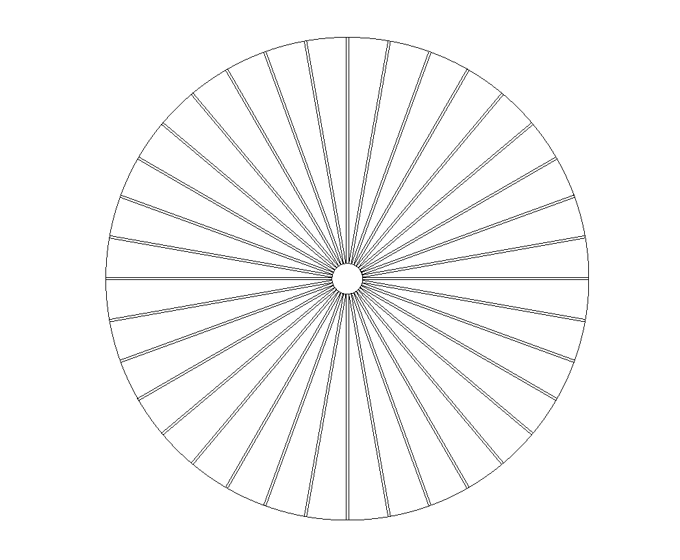

I guess that another output from the program could be a paper model to be cut out and glued together. It could give the basic shape structure to be worked with further, if not used as the final horn 🙂
Or to print templates of ribs that could be covered by a cloth and laminated. Then the final horn could be made out of a paper mache quite easily - paper horn.
Let the ribs cut out of plywood or balsa on CNC and the rest you could do in your living room...

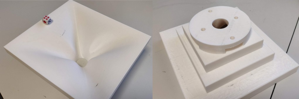

This mould could be milled on CNC from styrofoam (XPS) easily and quite cheaply I guess. Then laminated with a thin layer of fine fiberglass for a smooth surface.

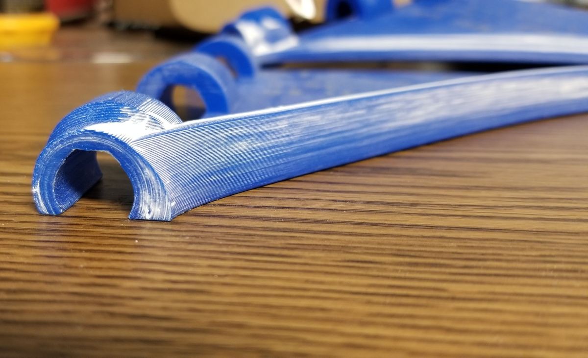

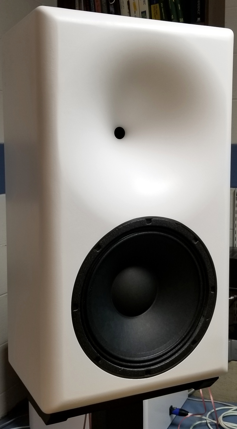

I recently completed a speaker that I suppose would fit here even though I didn't actually use Ath4 (I wrote my own tooling). The waveguide profile is OS with an angle- and curvature-matched Euler spiral (a.k.a. clothoid) termination starting at 40% of the total depth. Throat angle is 10°, which matches the compression driver I'm using (Celestion CDX1-1747). Here's the completed speaker:
The cabinet is 73cm x 41cm x 30cm (approx. 29in x 16in x 12in).
It took me a while to figure out how to make an accurate waveguide of this size since I don't have a big lathe or CNC router. I have a 3d printer, but I wasn't too keen on the idea of printing the whole waveguide due to the time required and the fact that the finished product would be a bit flimsy unless a lot of material was used. The basic process I arrived at is gypsum cement (basically plaster of paris, but much harder and stronger) over an MDF substrate coated with a suitable bonding agent. After some experimentation I found that type II water resistant yellow (carpenter's) PVA glue works remarkably well as the bonding agent (more on this later).

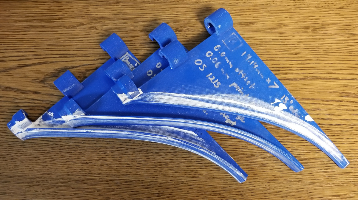

I shaped the gypsum cement using 3d-printed running molds that pivot on a 1/2in stainless steel rod held in place by this jig (which is also 3d-printed):
Here are the templates:
Two of the templates have a wide angled edge which helps to spread the plaster, kind of like a plasterer's trowel:

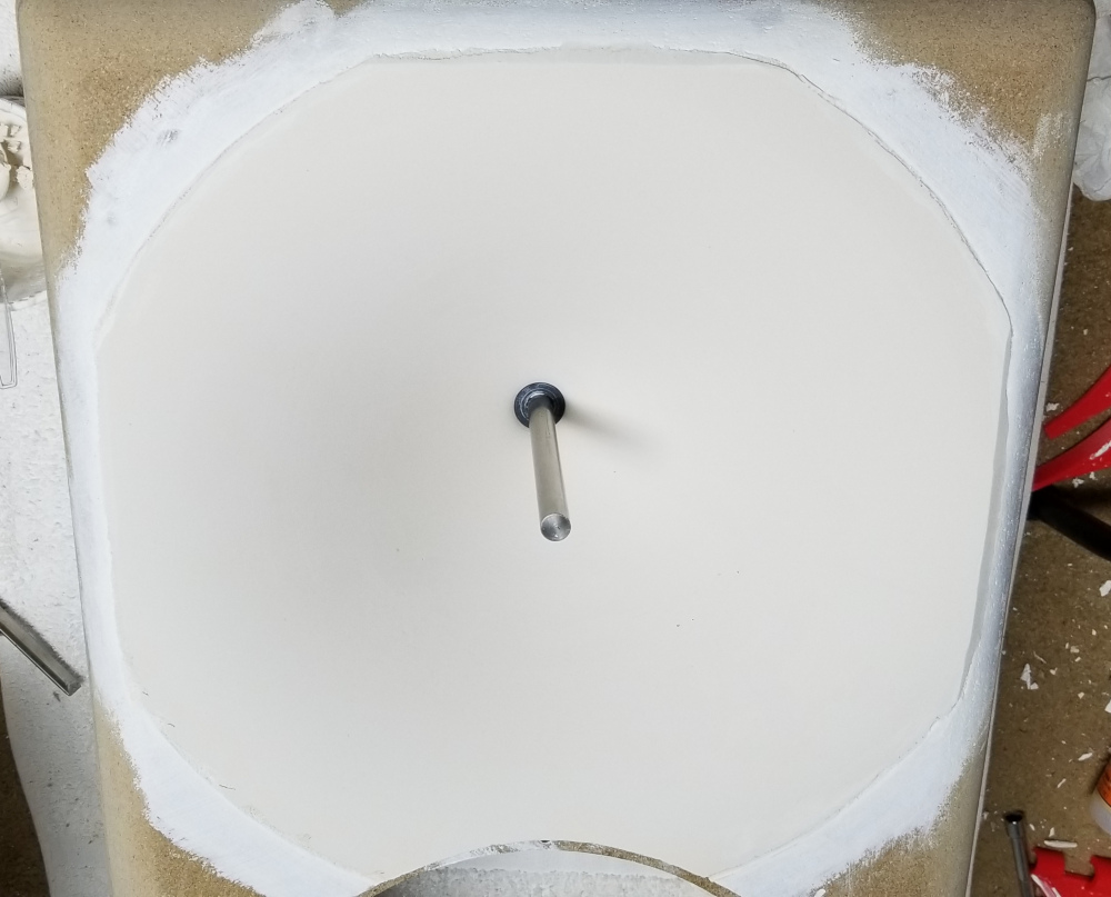

I applied the plaster in two coats, similar to two coat veneer plaster. The basecoat is about 3mm thick, cut 50/50 by weight with fine silica sand and the finish coat is 1mm neat. Here's the bare plaster waveguide. You can see the stainless rod in the middle:
This particular one was actually a failed attempt as the plaster didn't bond properly to the substrate. Due to the fact that gypsum plaster expands slightly as it sets, you need a bonding agent that provides some bond strength even when damp to prevent the plaster layer from lifting off the substrate near the waveguide mouth. For the attempt above, I sealed the MDF with a waterproof primer and then coated that with Elmer's Glue-All (a white PVA glue without water resistance). The problem is that the Glue-all turns back into a PVA emulsion on contact with the wet plaster and thus has no bond strength until dry. What I found works well is two coats type II water resistant PVA (I used Gorilla wood glue (NOT the polyurethane stuff), but Titebond II or any other similar product should work just as well), sanded lightly between coats, and one coat of Elmer's Glue-All. The Glue-All is probably not required, but I figured it would improve the bond once dry. Type II PVA adhesives get a bit soft when exposed to water, but don't completely re-emulsify. This property appears to be what makes it work so well for this application.
The gypsum cement I used is a G-P product called Densite (K-5, I think), which you can buy in small quantities at dickblick.com. USG Hydrocal White should also work well. Do not use USG Ultracal 30 or any other gypsum cement with portland cement (check the SDS). Based on my experience with Ultracal 30, it will shrink slightly over time and crack.

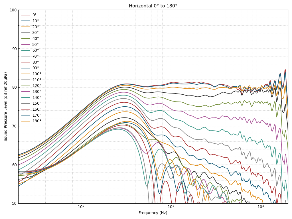

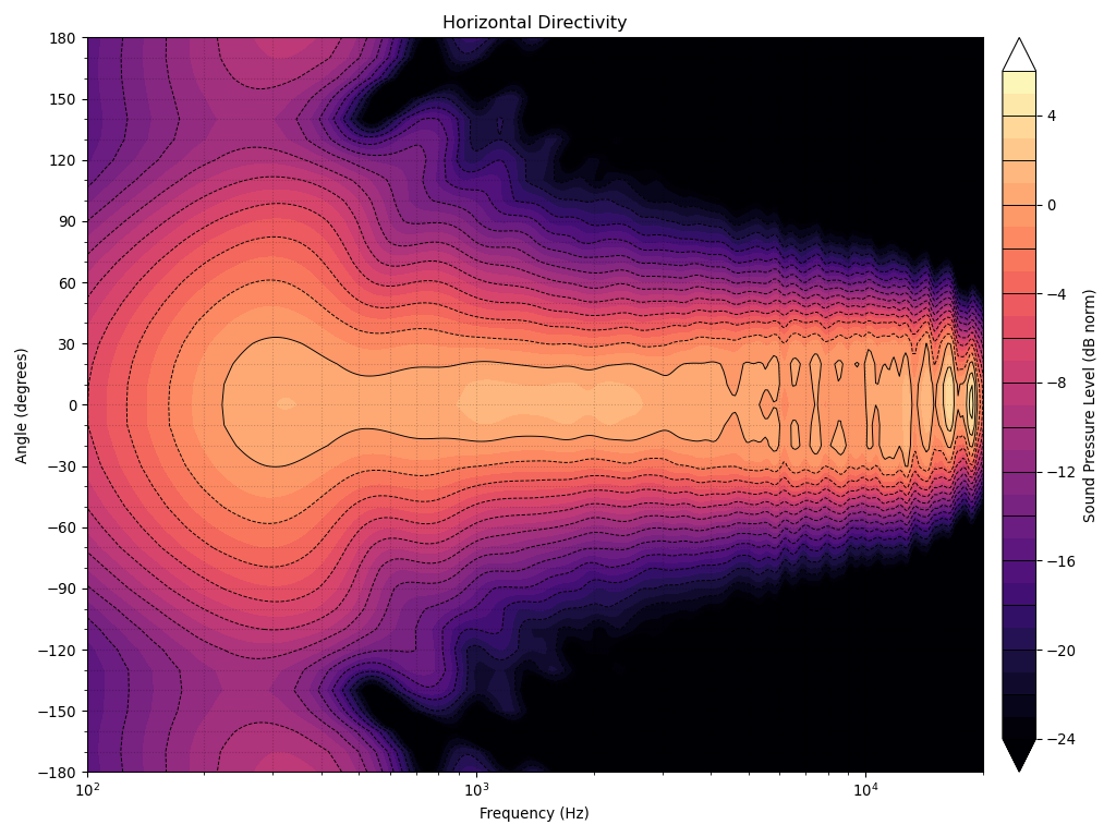

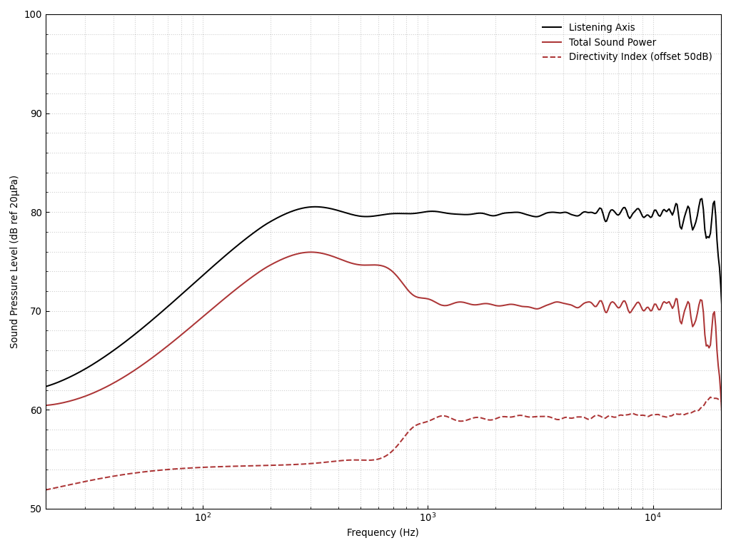

So how does the final product measure? Very well, in fact. The data seems to agree pretty well with the ABEC3 simulations I did. The measurements were done inside with a short gate, so I'd ignore below 1kHz for the most part.
You can see that the sound power is very flat from the crossover frequency (1050Hz) to about 16kHz. Also, the 0° response is about ±1dB from the listening axis (18°), which I'd say is pretty good for an axisymmetric device. I think that this is pretty good evidence that mabat is right about how important the termination is. The axial response could be improved further with a more gradual termination, but the DI would be more tilted. I don't know which would be better in terms of perceived sound quality.

Big thumbs up for a stunning result!
It looks like a factory built loudspeaker and those plots are excellent.
Thank you also for your detailed description of the construction, a source of inspiration for other forum members.
The woofer is an Eminence, judged by the cone and surround?
What's is your (initial) subjective impression of the speaker(s) in the room?
