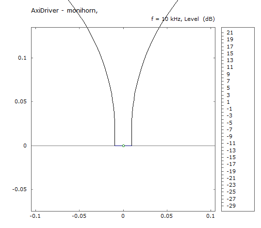

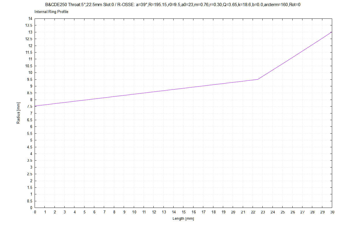

Could you please show the profile for this one. I tried to enter them into R-OSSE calc. but was unsure... arcterm?The design goals were (pretty standard):
- consistent DI (throat adapter to prevent beaming)
- wide coverage
- directivity control at least down to ~1000hz
Here's the ATH script for this version:
Code:; ATH 4.9 20230530 ; MoniHorn v2 ; ------------------------------------------------------- ; CircSym mode ; Throat adapter Throat.Ext.Angle = 5 Throat.Ext.Length = 22.5 R-OSSE = { R = 197.15 a = 39 r0 = 9.5 a0 = 23 m = 0.76 r = 0.30 q = 3.65 k = 18.6 b = 0.0 arcterm = 160 } Rot = 0 .....

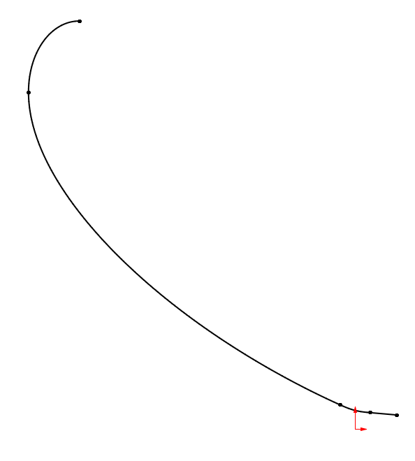

Also, I should say I don't use GridExport:f360. I don't know what that produces. However, the configuration file generates a shape inside the DE250 that looks like the above.
CinnamonRolls you have it right. Jzagaja you are missing the 23 degrees rotation.

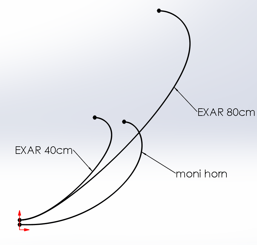

We indeed used that shape inside the DE250. The sharp transition we smoothed with a continuous curve (G3) of radius of 50mm.
Because the CAD was made in Solidworks I used the following equations within SolidWorks’ equation driven curve(maybe someone else also is lucky and has access to SW and wants to use ATH in it):

Somehow this radius resulted in a 440mm horn so we used it. Note the plug and smoothing of it doesn’t come from this equation, it was added manually. The origin is on the revolve axis and on the DE250 mounting plane. Don't know if anyone wants to simulate it, but I've attached the .dxf anyway.

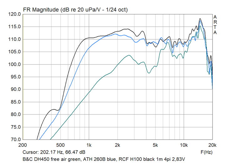

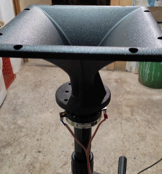

B&C DH450 on ATH ST260B (minor cutting of the edges to be able to print within a Bambu P1S) vs. RCF H100 horn vs free air sensitivity comparison; 1m 4pi 2,83Vrms; no baffle, measured vertically, on axis, with gate in software:
A nonlinear (harmonic & intermodular) distortion comparison, with filtered (equalized) frequency response, vs. the H100 can be found in:

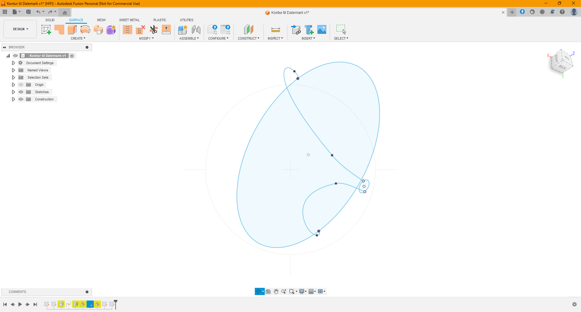

Is there anyone who is good at Fusion 360 design? I am trying to make a horn but I am unable to convert the outline to a horn design.
I would close the horn outline to form a horn structure with suutable wall thickness and then revolve it 360° around the horn axis.I am unable to convert the outline to a horn
https://help.autodesk.com/view/fusion360/ENU/?guid=GUID-D74BB28A-9570-43AD-97A4-E094021C036B

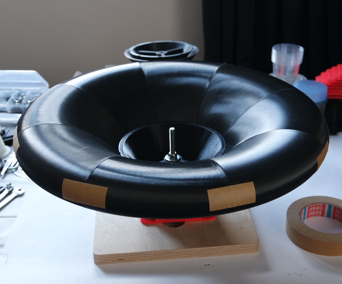

When building a waveguide from 3d printed parts. What is the best glue? Do you afterwards use a coat of epoxy to smooth everything?
As for my kits with the provided petal jig, here's the recommended procedure:
- Sand down all the adjoining surfaces of all the parts - especially all the little blobs from retractions and also corners, everything that would prevent the parts from fitting closely.
- Tighten the jig to the base. It will be possible to easily add petals one by one into the formed gap.
- Use a slow glue and assemble all the petals in one step, i.e. make sure the glue remains liquid until the last petal is added. I use a PU glue that also expands a bit, but I guess anything slow enough will be as good. Use a tape at the mouth edges of the petals so they can't move apart. Only be careful to not glue the petals to the jig.
That's it. Remove the jig only after the glue hardens completely.
