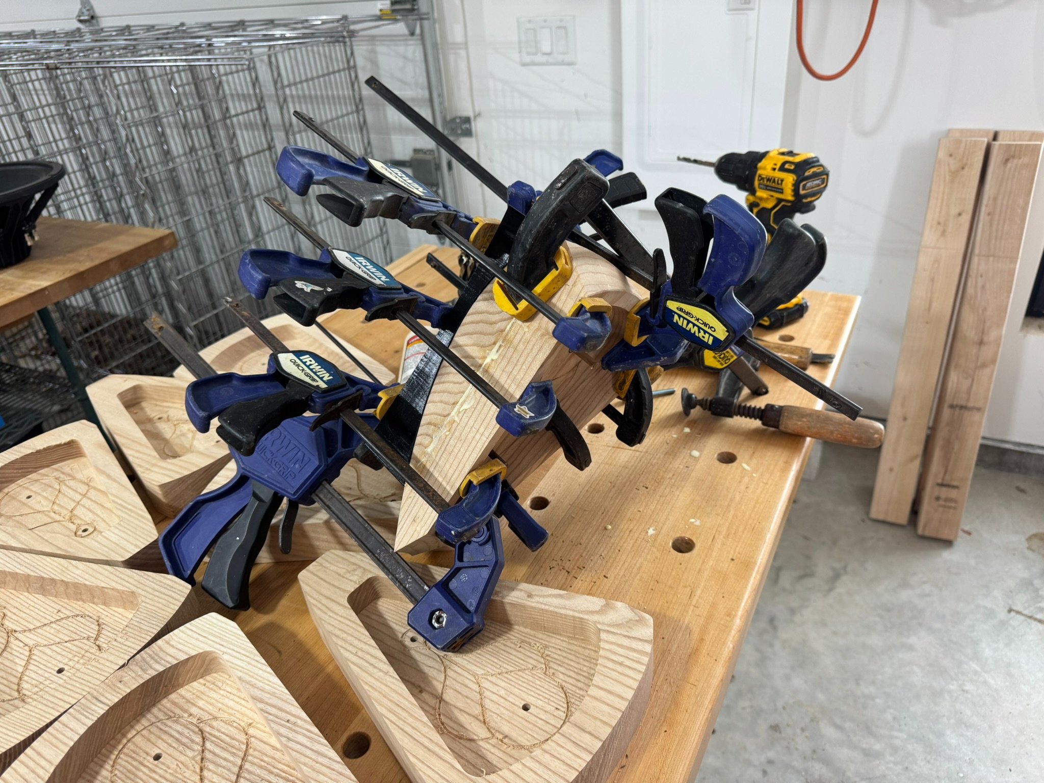

I fabricated one "petal" today with some of the extras I screwed up along the way, and amazingly things seem to fit and work as they are supposed to. I need more clamps.
looks amazing, if you have cnc possibilities, why not 🙂 must be very heavy though... but that unique looks is worth it I suppose.

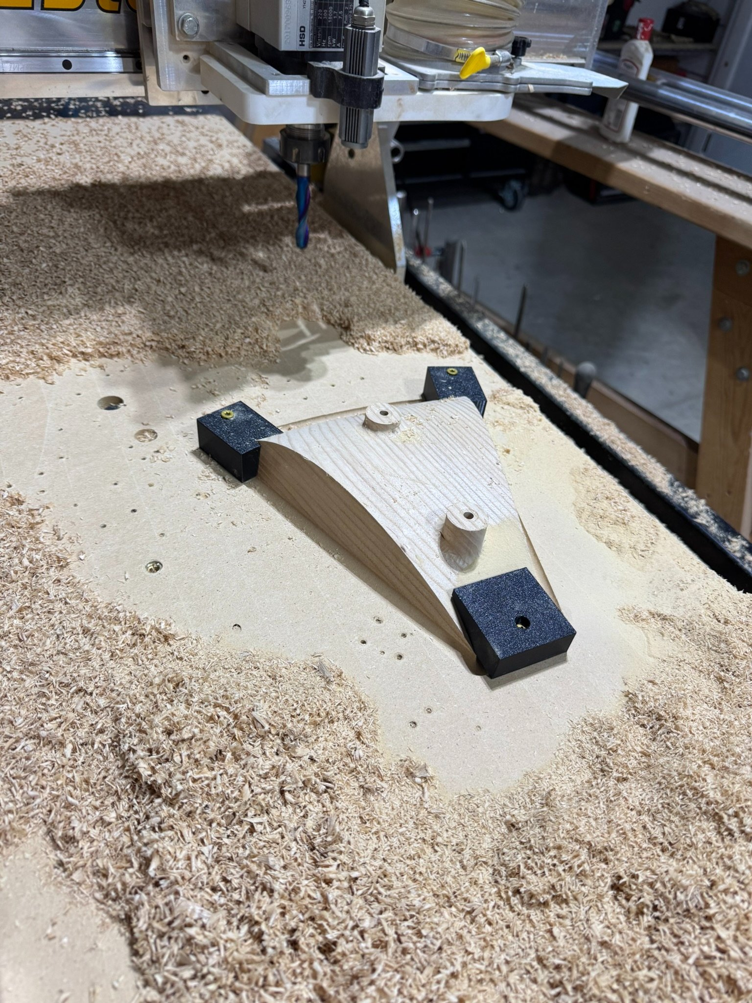

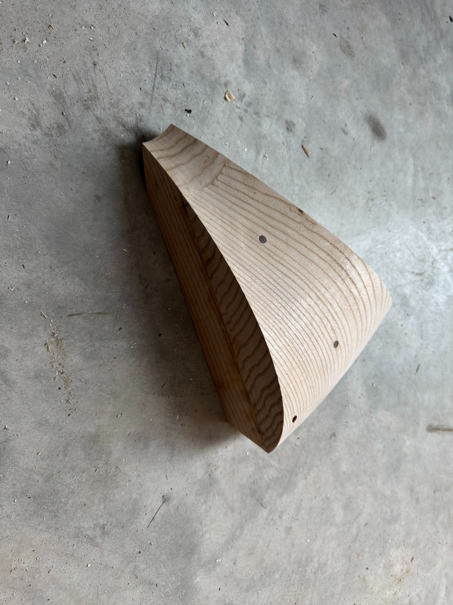

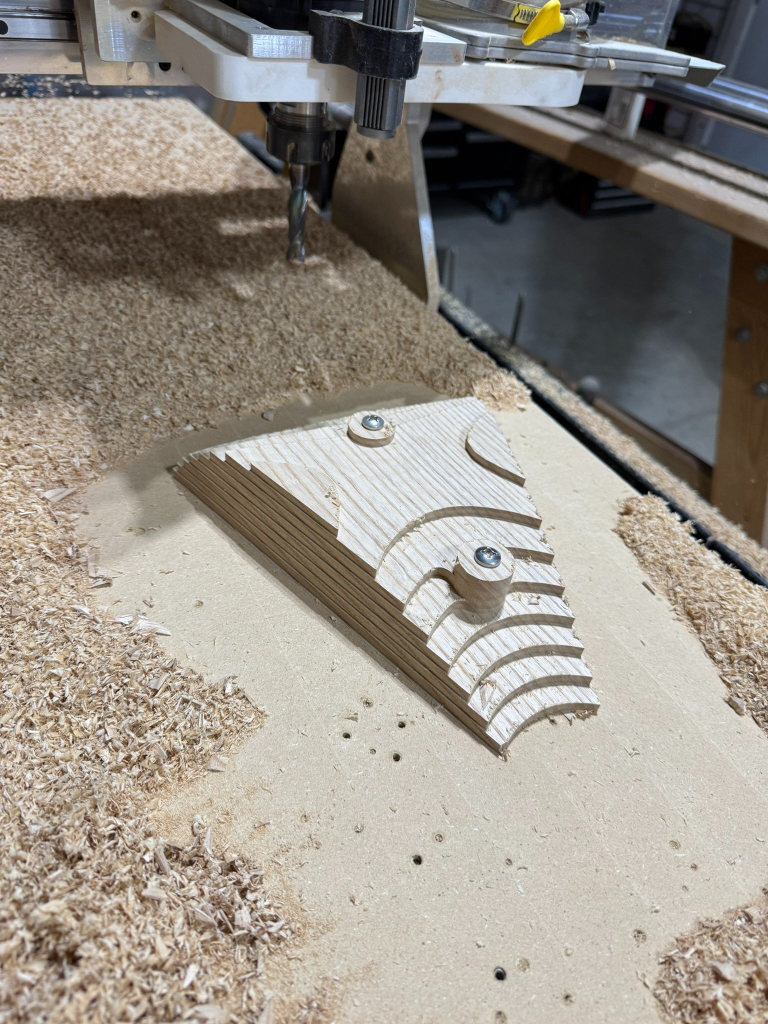

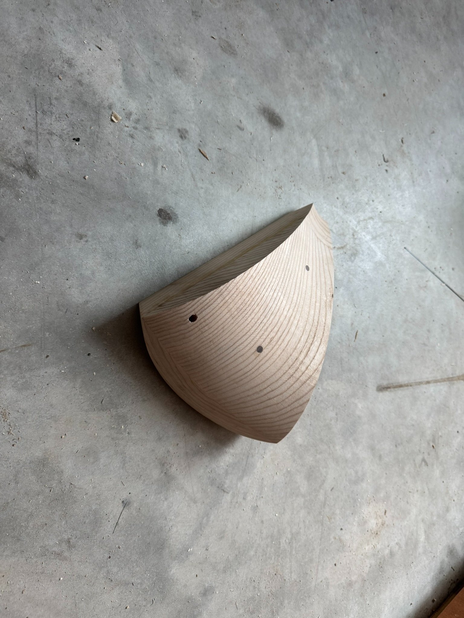

Really smart approach with the CNC there. I've been trying to formulate a plan of attack for machining the A460, but your process seems really well thought out.
@galucha it took a lot of thinking and tinkering but I figured out a method that worked well - I basically used two 1/4” holes in the petals to locate the piece on the spoil board, then I actually put brass threaded inserts into the spoil board so I could bolt the piece down to the CNC through the 1/4” registers with a 1/4-20 bolt. Because I was flip milling and laminating two different pieces it was the best way to ensure I was in the ballpark for alignment and centering.
