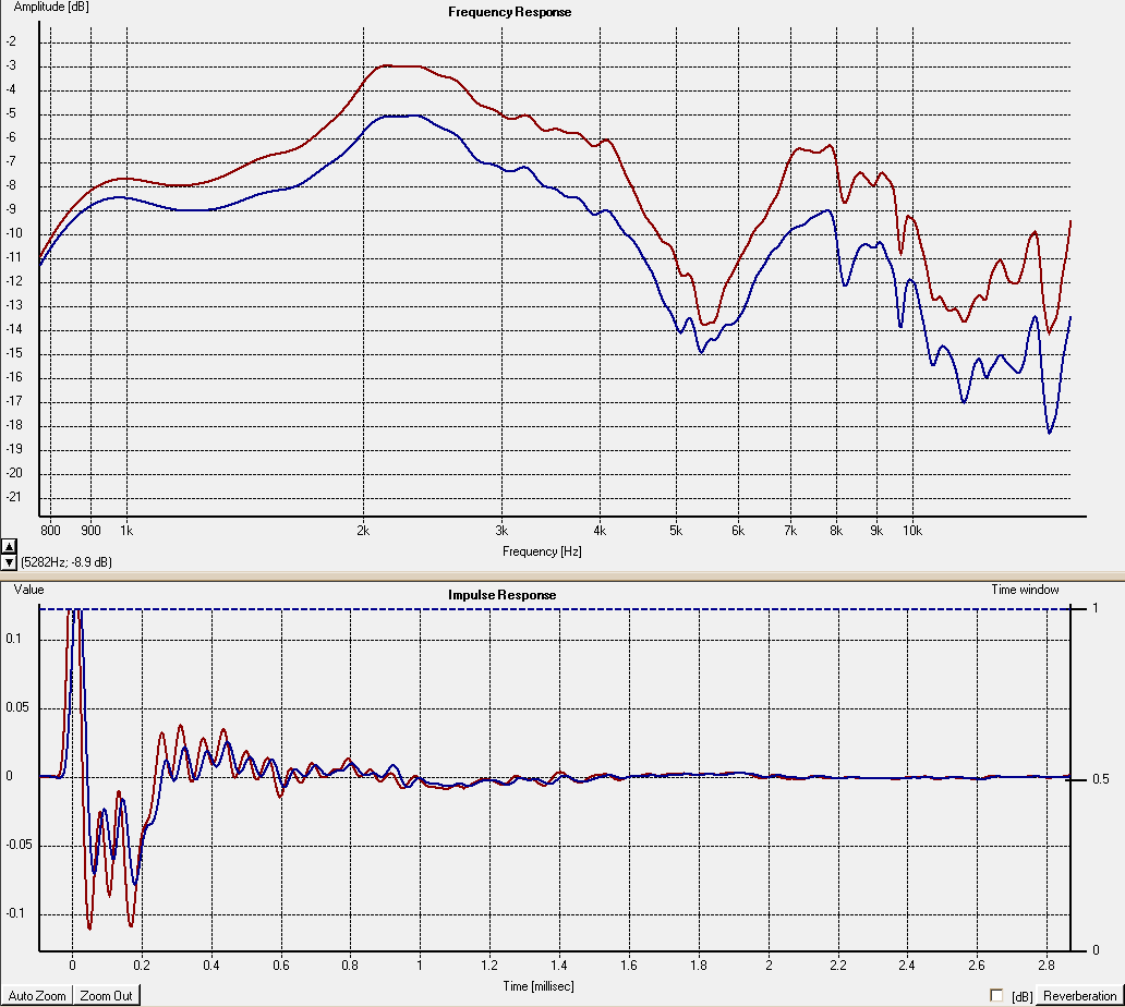

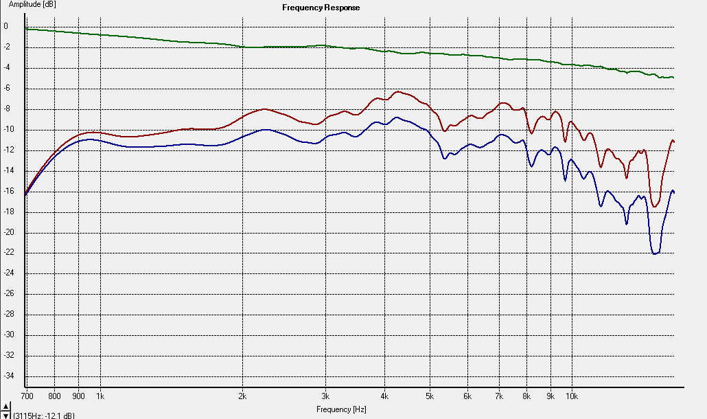

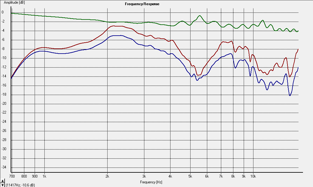

That's some very lossy foam, far far more than what I use. Unlike yours, I hardly see any effect at the low end of the passband.
So objectively we know that there is an effect, that's step one, given the magnitude of the effect it is hard to say that it is not audible (that much is conjecture, but given the data I am sure that it is accurate.) What is unknown is if the effect is perceived as beneficial in a controlled subjective test. A test like that would be extremely cumbersome to pull off. Hence all we can say at this point is that "the jury is still out on subjective improvements." However, as far as I know no one who has tried this has reported a negative perception. Several have reported positive effects.
Still you seem to hold the position that the foam makes an audible difference. For that you have no evidence. It's not so long ago when you admitted that yourself.
Yes, most probably it was far more dense than what you use. Just an experiment. Honestly, I hardly noticed a difference at the time. I haven't used it since as it gets quite expensive. Definitely it didn't harm.That's some very lossy foam, far far more than what I use. Unlike yours, I hardly see any effect at the low end of the passband.
But I probably don't listen as loud as many may be - that also can make a difference.
When it comes to subjective impression all of us are to be taken with a grain of salt, to that I agree. And I think I represented my position on this very well in that quote.
My impression is that in the case of the simulated waveguides it could be a little less difficult just because you don't have to record the sound first. It would be all artificial - the source polars, the room reflections, the head. Maybe the head would still be the weakest point.... Later in the mid-2000s I got a HEad binaural system and recorded many of my speakers and others in my sound room. On playback they were not really even close to the real thing. I think that is because I just used regular headphones and not the Head EQ'd electrostatic ones that we used at Ford. But those headphones were beyond my budget so none of this worked out for me. ...
In the impulse there seems to be a (minor) effect.
On the other hand, there's a few dB less output due to the foam...

I think there are more convenient ways of how to present the data, like the wavelet transform (I also remember the Wigner distribution which for some reason never really catched on). Unfortunatelly these were not readily available to me at the time.In the impulse there seems to be a (minor) effect. ...
