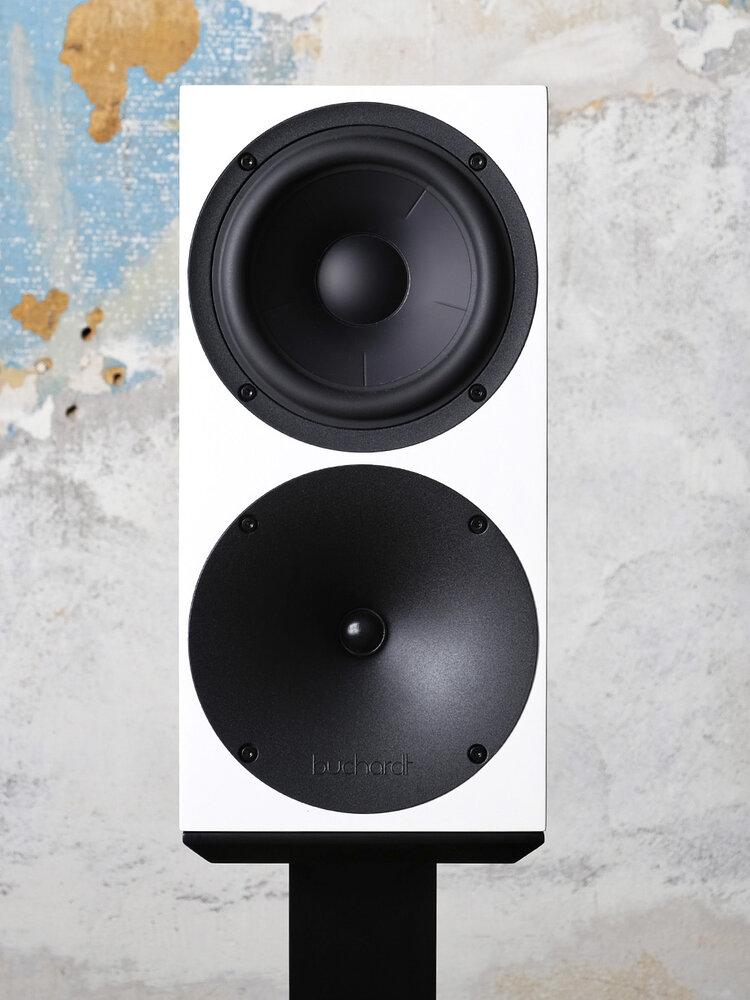

How about these? S400 White — Buchardt Audio
They get great reviews. I see potential problem with diffraction on the sharp edges, but the WG is supposed to be matched to the mid-woofer and there is a passive radiator in the back. They are not that expensive either.

See the measurements (made on Klippel NFS, which is a dream): Buchardt S400 Speaker Review | Audio Science Review (ASR) ForumHow about these? S400 White — Buchardt Audio
