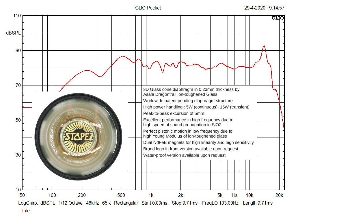

Try this.
very interesting, but it can't even hit 95 db at 1 meter.... bateman would never be happy with that!

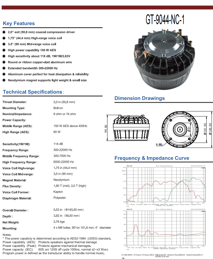

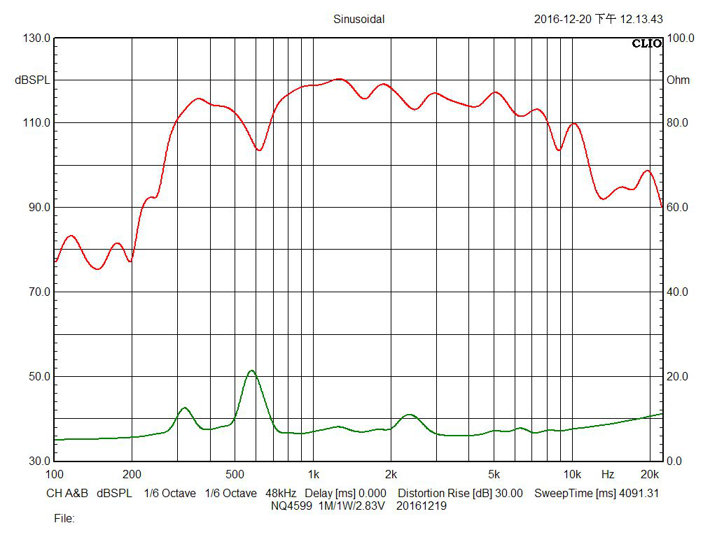

That of course depends on the target output levels and what you mean by "reasonable". As was shown, you don't have to keep the coverage of the waveguide controlled down to that extremely low frequencies, but anyway, even the DCX464 would be pushed rather hard that low I think. No own experience here.
There are no frequency response data there but if specified at 200 - 9k, I'm afraid it would require one more driver above that for high frequencies and that would be a big NO GO for me.
Question is can you sim arbitrary driver to get 200Hz with 70cm diameter. Efficiency can be below 100dB because most will do passive anyway.
Is 200Hz possible with reasonable size?
