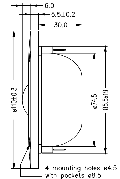

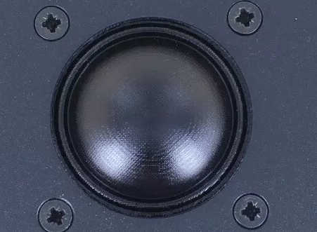

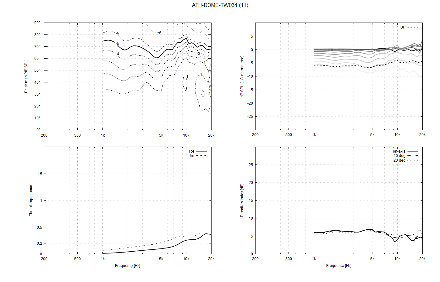

Any experience with Audax TW034 dome on a waveguide?
It's a soft dome, hence may not work so well so high as a hard one, but its shape/height seems promising for a wide beamwidth, and the faceplace is just calling for it -
Based on the photo it's at least 10mm tall.

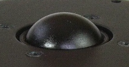

But a hemisphere doing a pistong movement would not add much from it's sides - right...(as it is not getting wider as it vibrates) so all domes rely on bending wave "break up" for its dispersion I would think... and the result of that you cant tell by looking att the shape... problematic...but its shape/height seems promising
It needs to be optimized, will hardly work well with a "stock" waveguide, but then it's like a miracle (the taller the dome the better - for a wide dispersion a tall 34mm is better than a shallow 25mm) -
BTW, I also tried some variations on the T34A theme and it seems that +-65 deg is really the limit above ~12 kHz with the bare tweeter...
It's no problem to have +-70deg below that.
They just beam, that's what happens. By adding a (surprisingly shallow) waveguide this can be changed completely. But you need the dome to maintain its pistonic motion, at least for a simple rigid-boundary modeling that we use. That's where a stiff dome like the T34A comes handy. With the Audax, we would have to try, I guess. For that money I would be happy with 12 - 15 kHz, don't need 20 🙂... so all domes rely on bending wave "break up" for its dispersion I would think..
But let me repeat, as this is crutial:
The taller the dome, the better - for a wide dispersion, a tall 34mm is better than a shallow 25mm.
It seems that the Bliesma T34A and Audax TW034 are about the tallest domes available. Does anyone know of anything else?
By this I mean the height/diameter ratio - the higher the better (the two mentioned are both ~0.3).
Hard to guess the ratio for the T35C002 but it seems also pretty high.
- Actually, it may easily be the tallest (and also the most expensive) -
But maybe it's not spherical. I haven't tried different shapes yet.

The downside of the smaller domes is that the surround typically occupies a relatively large area compared to the dome itself. That's never a good thing and it's also where the bigger domes have a significant advantage. But it's certainly a good tip, I think I even have the LP100 somewhere. I can look how easily it could be attached to a waveguide. It's interesting that the published data don't even suggest it should work, but perhaps the default factory "waveguides" are too small to have the desired effect. Or maybe the soft domes just don't make it possible - we'll see, I already ordered a pair of TW034.

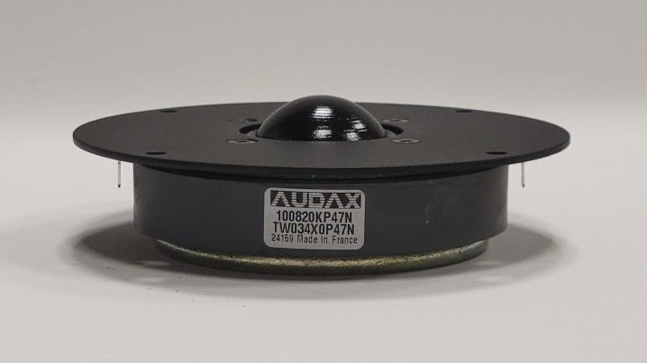

Found another photos of the Audax. This looks really good, it may be even more than 11 mm.
(Not as good as with a concave surround, but no such tweeter exists, to my knowledge.)

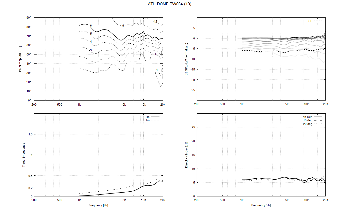

Here is what a single milimeter of dome height does - with everything else equal, dome heights 10 and 11 mm:
Now the funny thing is that 11 mm may be already too tall 🙂

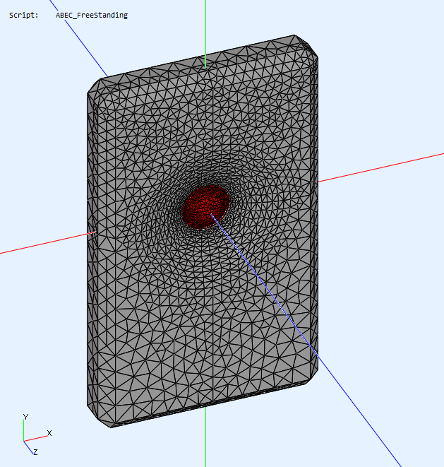

How about the WG throat covering the surround, fully or partially. (So that the throat diameter is closer to the dome/voice coil diameter and starts a fracton of a mm above the surround. Besides that it creates a cavity, but the output of the surround is less to begin with.) Or in the partial case covering the surround kind of in a radial phase phase plug fashion https://www.desmos.com/calculator/aajs8hkfim and would be "blended out" as it expands.
I always thought that covering the surround would be a good idea, and that the cavity should be filled with a medium-density felt for damping any output from the surround or any cavity resonance. No idea if this actually works well in practice though.
I tried to cover the surround in different ways in the sims, but it always came out worse than without. Maybe I just didn't have luck, but I suspect that these little details are not easy to model reliably (and that it's probably worse in the sim than in reality). That's my takeaway at the moment - these experiments would need to be done hand in hand empiricaly with real devices, to see what it actually does.
