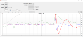

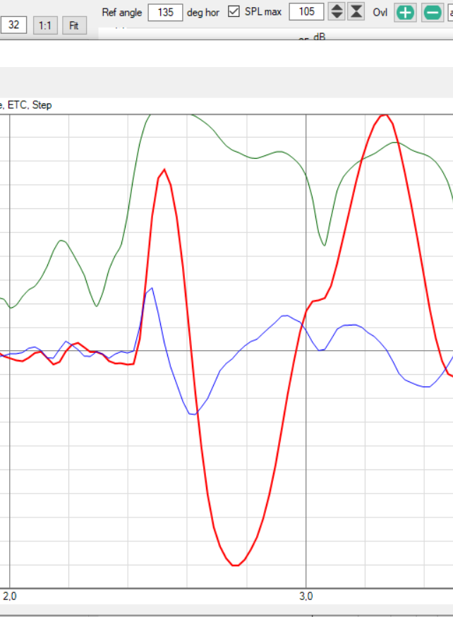

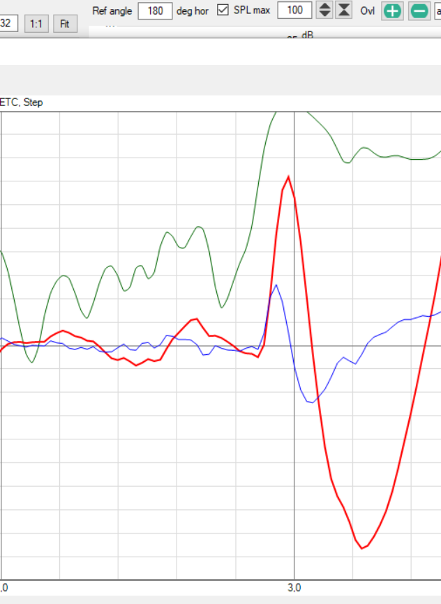

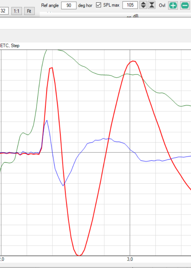

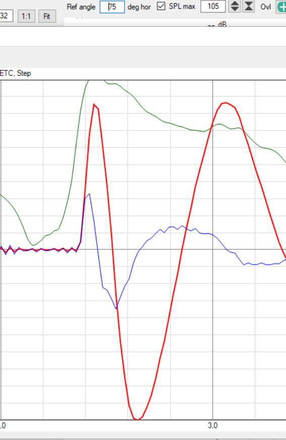

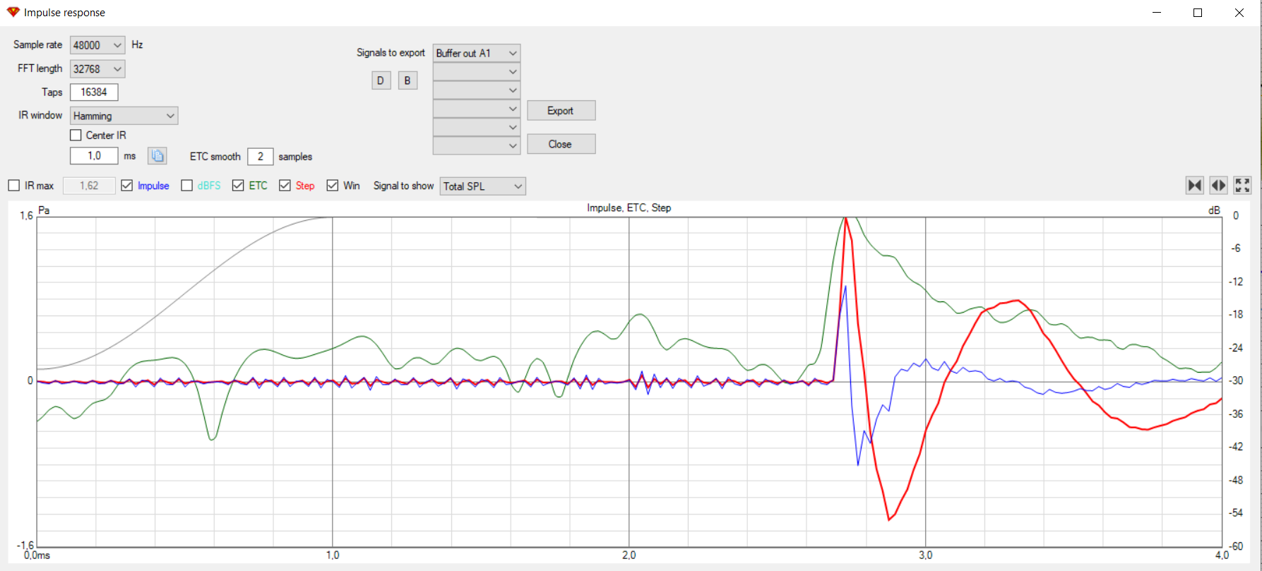

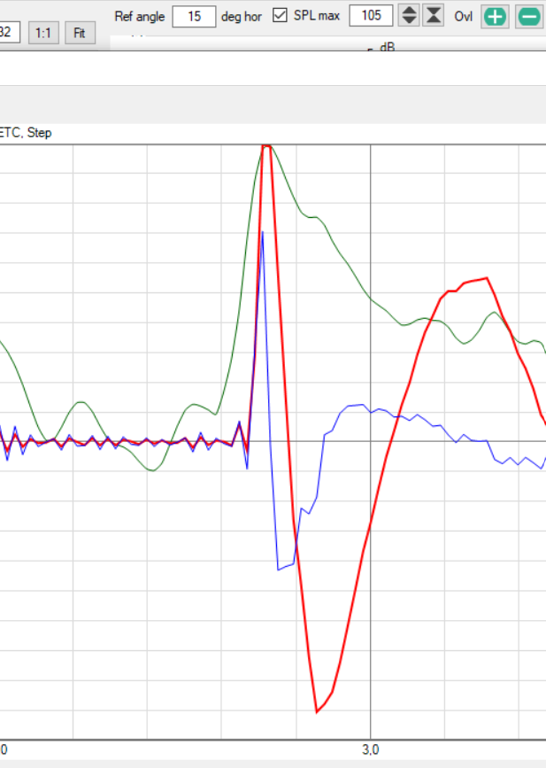

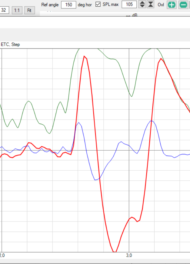

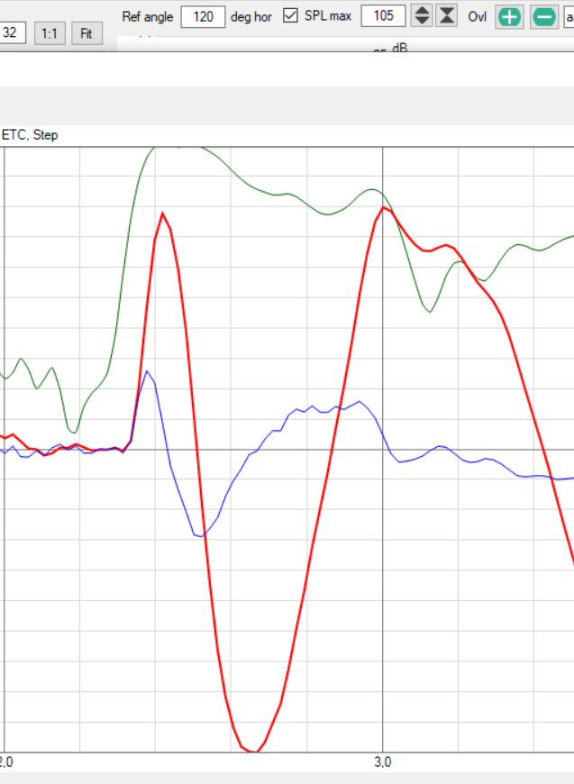

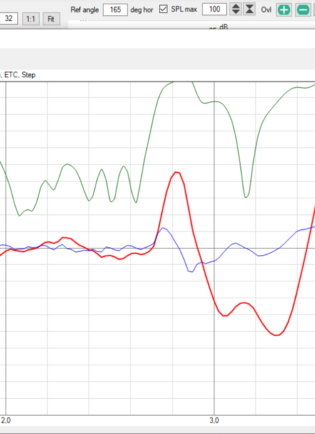

ABEC simulations indicate the acoustic center is at the throat though, not at the mouth. This is evident if you look at impulse responses for measurement set where throat was rotation axis, as it is by default with ath sims. If you move the rotation axis to mouth and redo the sim and inspect impulse responses of various angles, the impulse advances early as you look at >0 angles, functions similarly as the Desmos sim. This indicates the acoustic center is at the throat and not at mouth as we've been thinking it is.
edit.

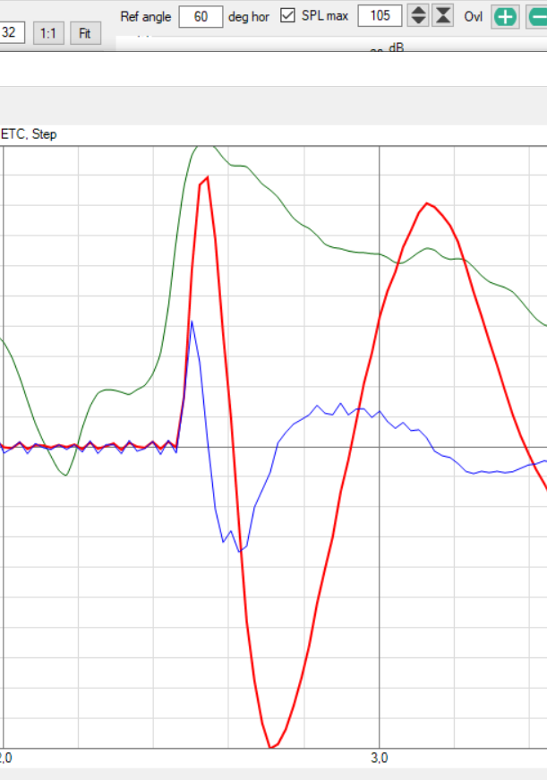

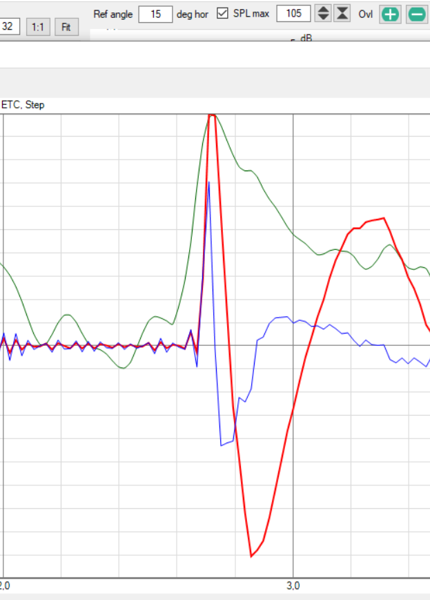

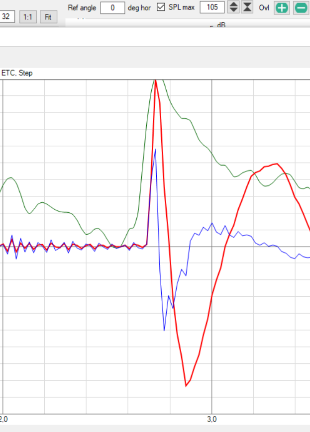

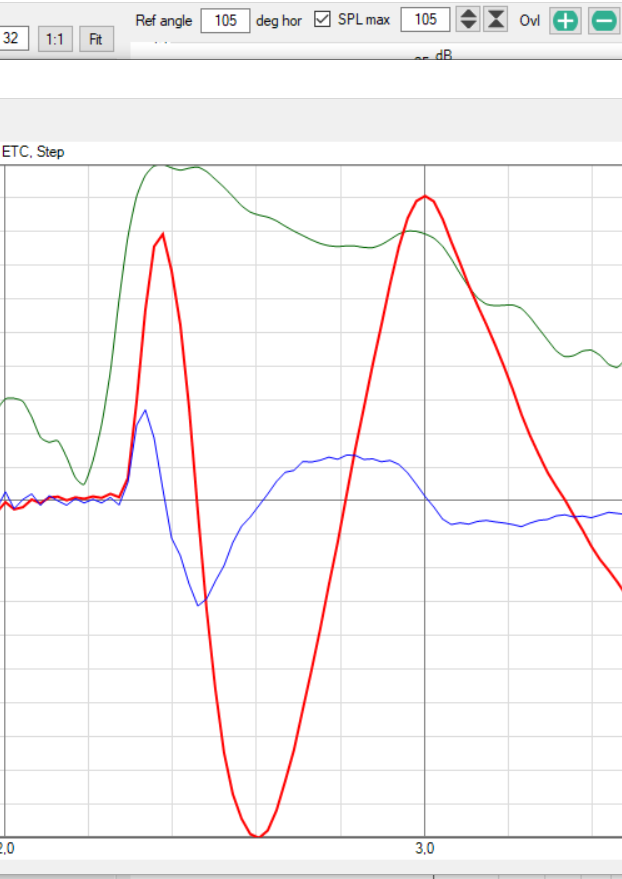

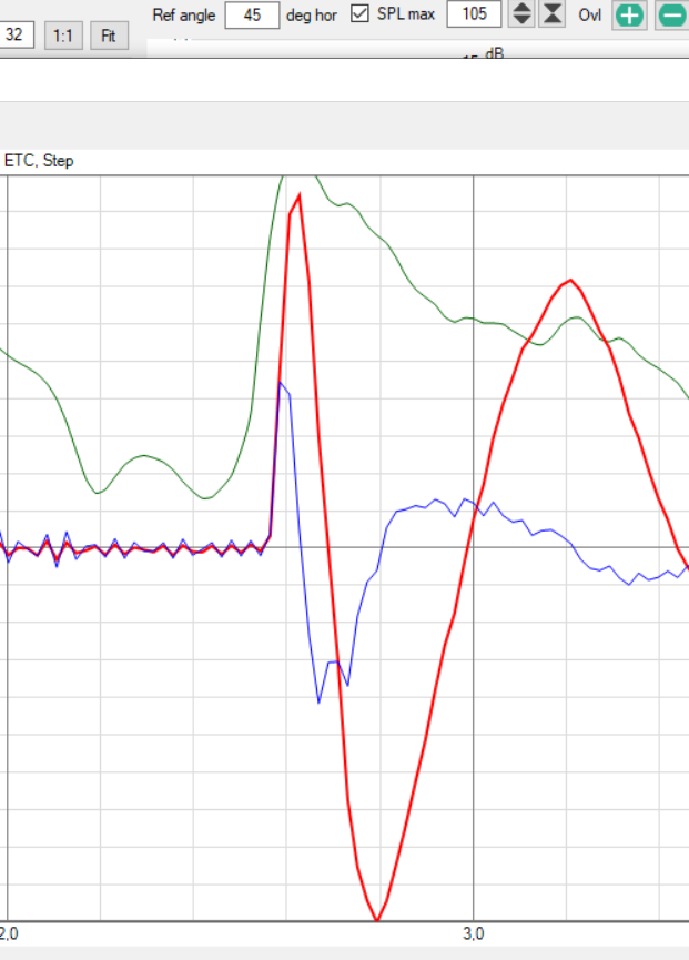

I just checked, same thing happens with real measurement I did earlier and posted about this stuff, rotation axis ~mouth. Impulse advances as I start to increase angle. This means the acoustic center comes closer to mic with rotation = acoustic center behind rotation, closer to throat than mouth. Click one of the impulses and cycle through to see magic movie 🙂
edit.

- It must be a data interpretation thing then.

Yes, since there is no way to skip this when acoustic center is recessed into a physical structure, all we can do is optimize what is most important, the listening window making sure the device size and position is so that at least within listening window distance between acoustic centers is close enough cosidering wavelength at crossover.
Of course it's not at the mouth, but it takes sound some time to get there. Until then, this sound inside the horn is not seen anywhere else, so it's irrelevant for the polars.This indicates the acoustic center is at the throat and not at mouth as we've been thinking it is.
Well, it is irrelevant for single device polars, but not when crossed over to another source whose acoustic center is not at same axis given path length difference is long enough to cause phase difference and superposition reduce from max 6db making dip it seems.

You can take out data from VACS, simulate any waveguide from ath and you get data with rotation axis at throat. Then do the same device but with the Offset to move rotation axis at the mouth. You might be able to directly compare data in VACS as well, arrival of impulse to various angles. If you want to compare to a woofer you could do simple woofer box sim with same VACS settings. You can export data and use in VituixCAD as well if you want to, but I think the same data would reveal same things no matter which software.
No, it doesn't, that's the point. Once you compensate for the travel time inside the horn, you can forget about it. What's left then are the path differences between the woofer and the mouth, as if it wasn't a horn at all, but a "diaphragm".delay affects all directions,
It seems it does, problem is the travel time is not constant relative to the other source to all output directions, as per illustrated in various ways. Observer is closer either source, when they are at an angle. You can compensate the waveguide, but it still differs per direction in a system context if acoustic centers of sources don't align showing the same issue.
Please, do 🙂You can compensate the waveguide
I think that the impulses from waveguide still arrive at various times at various angles when they are aligned at mouth with baffle, so I can add constant delay to woofer but the waveguide still behaves the same so not sure why I'd do that? I can do it once more but my extra time costs one more good optimized waveguide in your shop everyone can buy, for 1.4", as per in #15,980 ?😀
