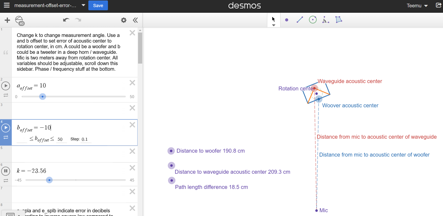

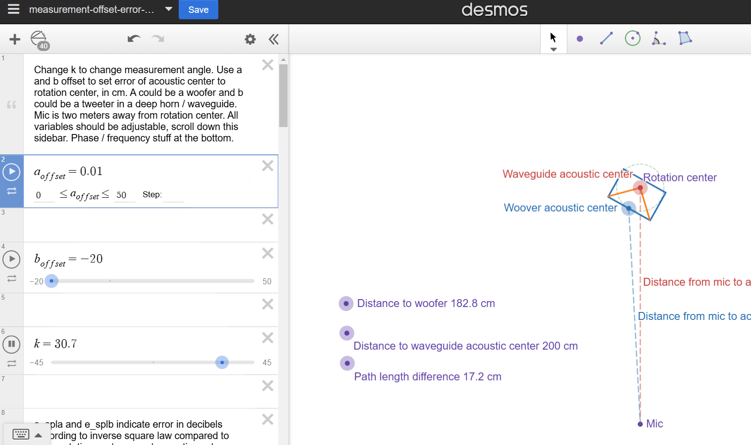

Here is attempt to train intuition with waveguide depth and rotating axis by visualizing and making it interactive:
https://www.desmos.com/geometry/zmwyitoecg
It's missing waveguide profile though, and how it would increase path length beyond ~nominal coverage angle, but this doesn't affect things in listening window so not the most important thing here, sorry, my inner desmos wizard isn't that good so you just have to imagine how the waveguide would further affect path length 😀
What the test kind of suggests is that if waveguide is deeper than say 1/4wl at crossover, the waveguide should be brought forward toward listener so that it's acoustic center is about within 1/4wl to the woofer's in order to maintain smooth response at crossover in the listening window. This might look a bit silly with deep devices, hence attempt to make shallow waveguide. What I'm after is that even though the waveguide has ideal performance toward listening window it can be ruined around crossover if acoustic centers are too far apart.
As evident playing with Desmos example, if mouth is at baffle plane so that waveguide acoustic center is behind the woofers, the waveguide effectively comes closer to observer as angle starts to increase from 0, which makes dip in off-axis response if phase difference gets beyond 90degrees because waveguide impulse arrives before woofer's, so ideally it needs to be within 1/4wl and preferably less assuming broad listening window is wanted to be flat, as it ideally would, impulse from waveguide should arrive at the same time as woofer's. Listening window is the most important thing, so waveguide that is brought forward would compromise high angles, but those aren't that important as listening window. Math person could likely calculate what the max distance between acoustic centers could be to have smooth +-60 deg or so, +-90deg, at least as much as is the practical constant directivity target.

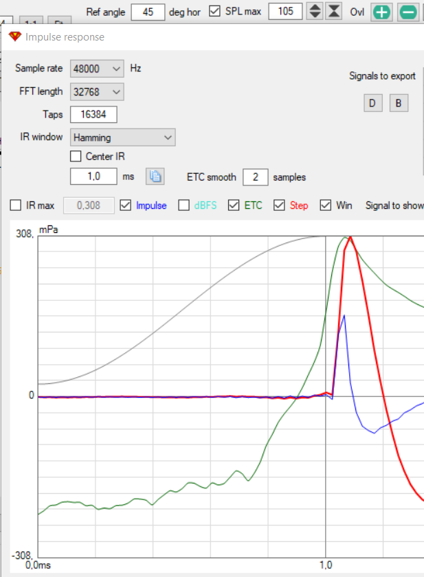

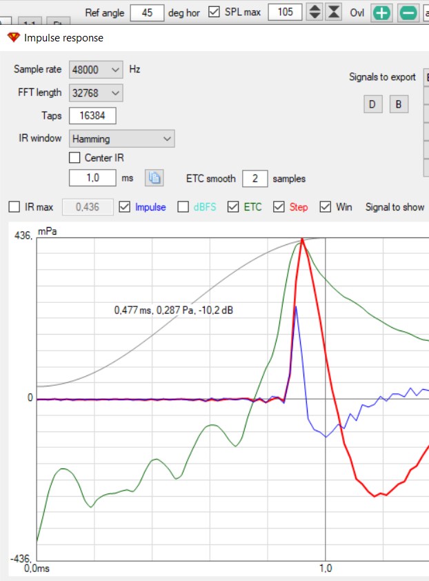

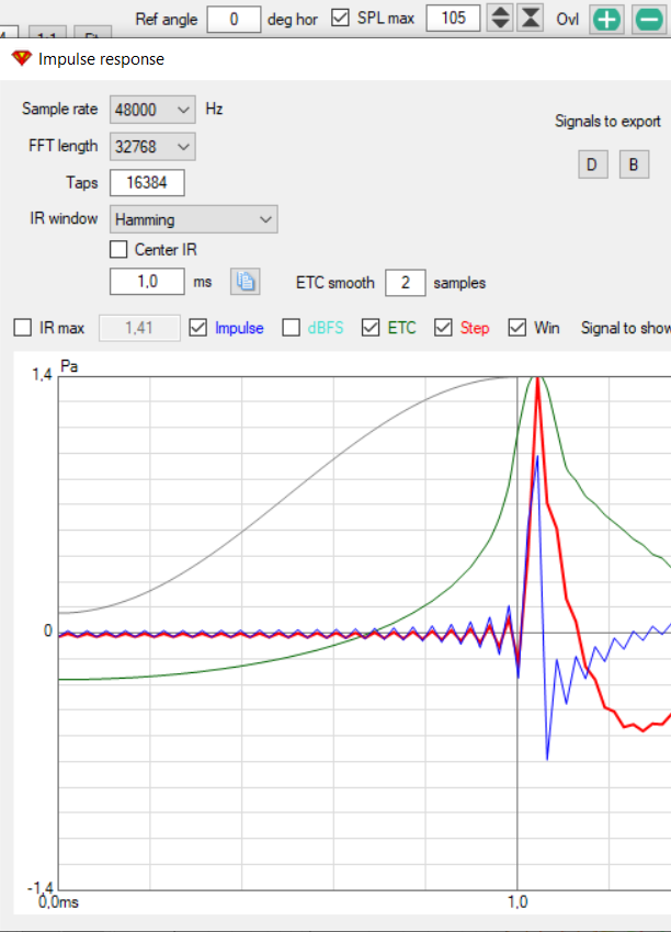

This stuff can be seen in impulse responses of spinorama data. If waveguide is rotation axis is at mouth, the impulse gets early within listening window as explained above. If rotation axis is at acoustic center the impulse stays where it should, within the listening window.

It's simple trigonometry, lets simplify acoustic center is at throat of a device. If you see the throat of the waveguide, and start to rotate the waveguide keeping center of mouth as rotating axis, equidistant to you, the throat gets closer to you with increasing angle until you don't see the throat anymore it gets behind the corner and it gets further now. Path length from throat to you first shortened, then increased when rotation is ~beyond nominal coverage. If you repeat the same test rotating axis at the throat, the throat stays equidistant to you, until it gets behind the corner and you don't see it anymore, after which it gets way further with increasing angle.
Take spinorama data to vituixcad, open the impulse response window and scroll the ref angle to see the impulse move indicating distance to acoustic center changes. Now repeat this same for your woofer, the impulse stays ~still. Now, depending on whether your rotating axis is same or different than thewoofers, distance to waveguide changes differently, making phase difference to various angles changing frequency response = waistband if the difference in acoustic centers is too long.

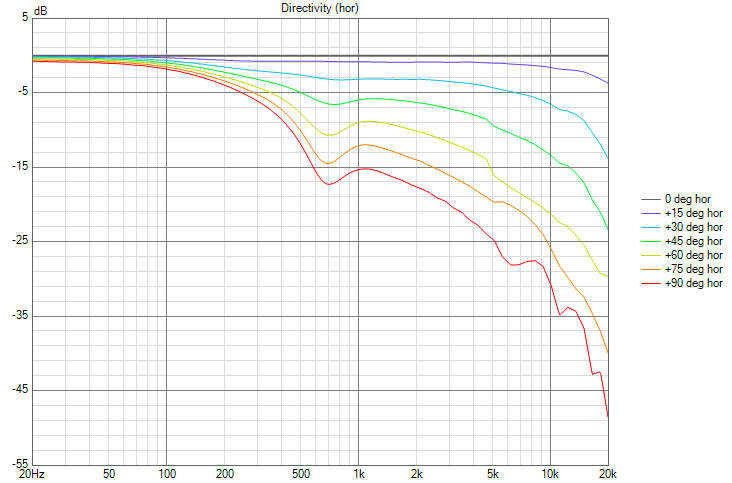

Here example, A460G2 simulated with ABEC, rotating axis either at the throat, or at the mouth. Since z in vituixcad stays zero this means the rotating axis changes between the two at the woofer or behind the woofer, right
Here horizontal response with 500Hz crossover, if mouth is at baffle plane, when the acoustic centers are not on same axis:
Destructive interference increases toward off-axis due to distance to waveguide acoustic center changing, while distance to woofer doesn't.

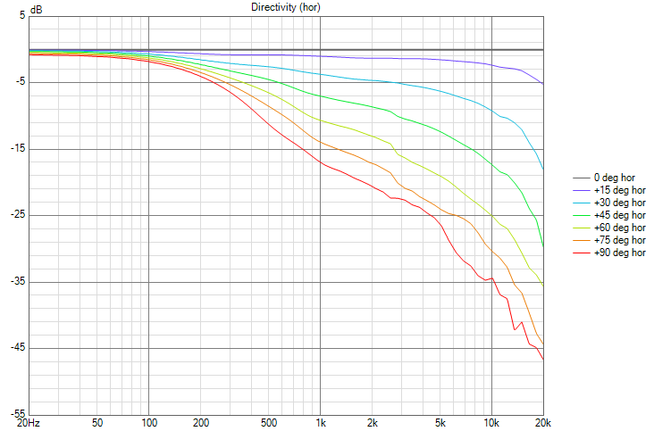

Here exaclty the same setup, except now the throat is at baffle plane, so same rotation axis for both devices. Now there is no destructive interference, as both acoustic centers are equidistant to the observer at all angles.
In practice, your complete system would measure like the first image if you put the device mouth to baffle plane, and the second if you put the throat to baffle plane.
Here you could use digital delay to compensate it to some direction, but that's electronical correction so affects all directions at once.

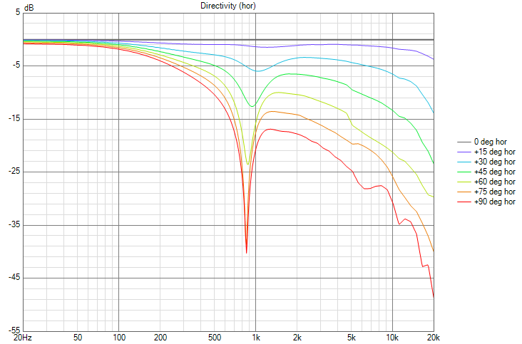

if crossover frequency goes up, here 1000Hz, the path length difference really shows up and severe destructive interference happens, if device mouth is at woofer plane. First image again waveguide throat is at woofers rotation axis, and the second one is when waveguide mouth is at woofers rotation axis.

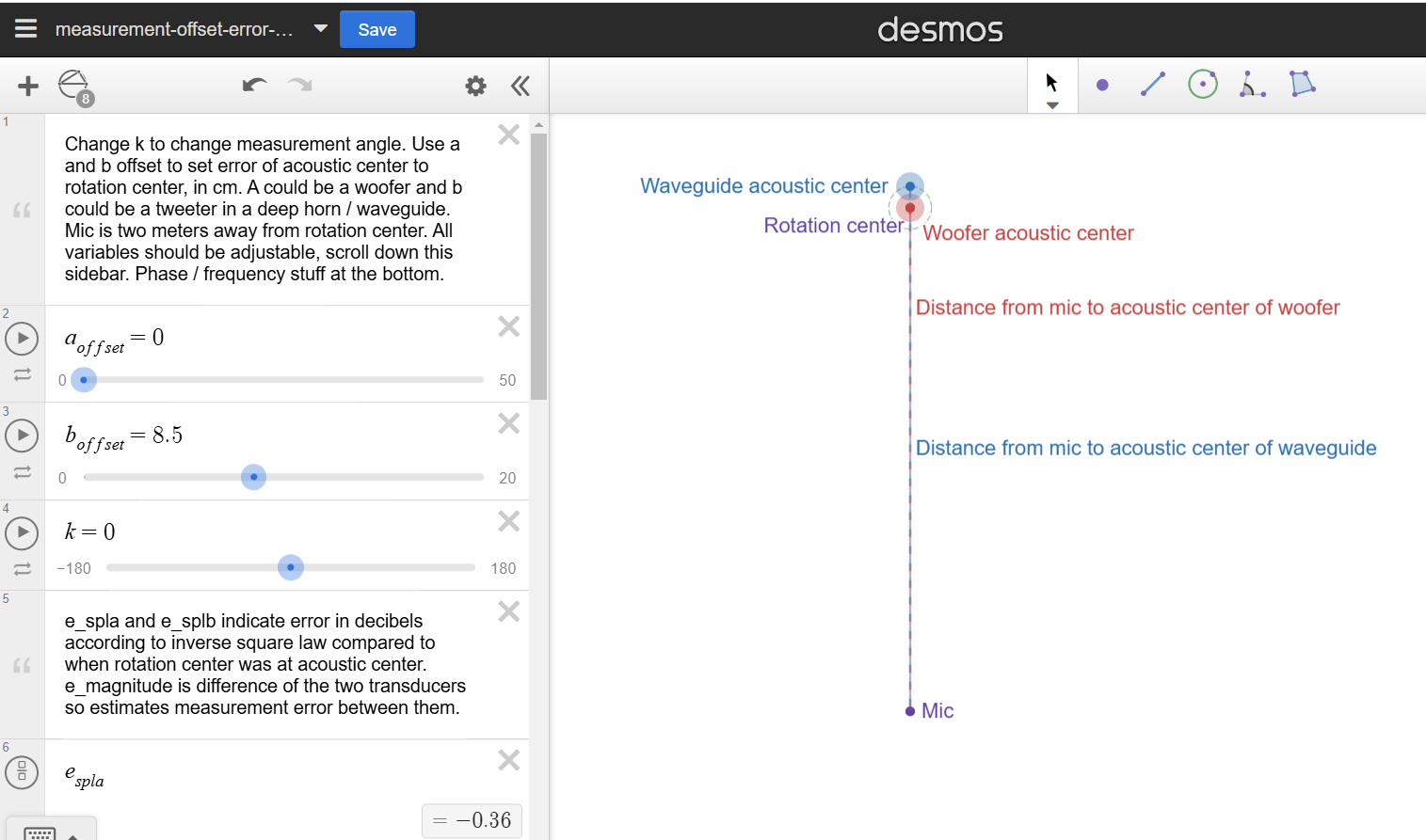

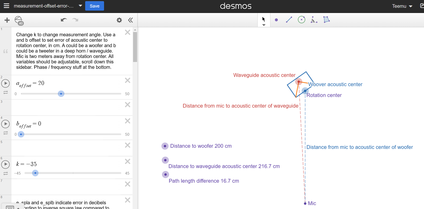

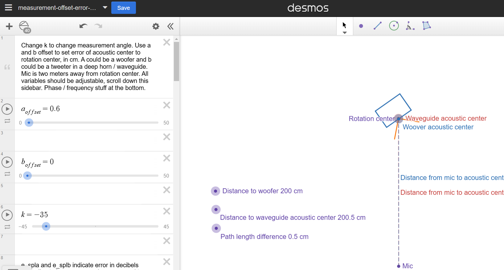

Here updated Desmos to illustrate it directly without VituixCAD 😀 https://www.desmos.com/geometry/piyepl4o5g
If acoustic center of waveguide is at the throat,
Here is link, hit play button for the k -variable on left to start rotating sequency. Move waveguide position by changing the a_offset slider, the first one. the labeling shows distance from both acoustic centers to mic.
When the waveguide acoustic center is behind woofer acoustic center, the waveguide acoustic center gets "closer" to mic with rotation, while woofer stays at one distance.
You could do it the other way around, rotate from waveguide acoustic center, but now distance to woofer changes per rotation. Or split on the middle and both change.
Implication of this is that at crossover frequency, where both have acoustic output, they will superimpose differently to various angles. The closer acoustic centers are at same axis, the better they constructively sum to ~all important directions. If one wants this, the waveguide must be positioned bit silly on top of the woofer, throat at baffle plane mouth way beyond baffle, like in the very first image on this post.

OK, thanks. That's what I meant by the wrong way how to look at it 🙂Here updated Desmos to illustrate it directly without VituixCAD 😀 https://www.desmos.com/geometry/piyepl4o5g
You should measure the distance to the mouth, not the throat, IMO. And compensate the distance from the throat to the mouth by adding a corresponding delay to the woofer, in principle.
