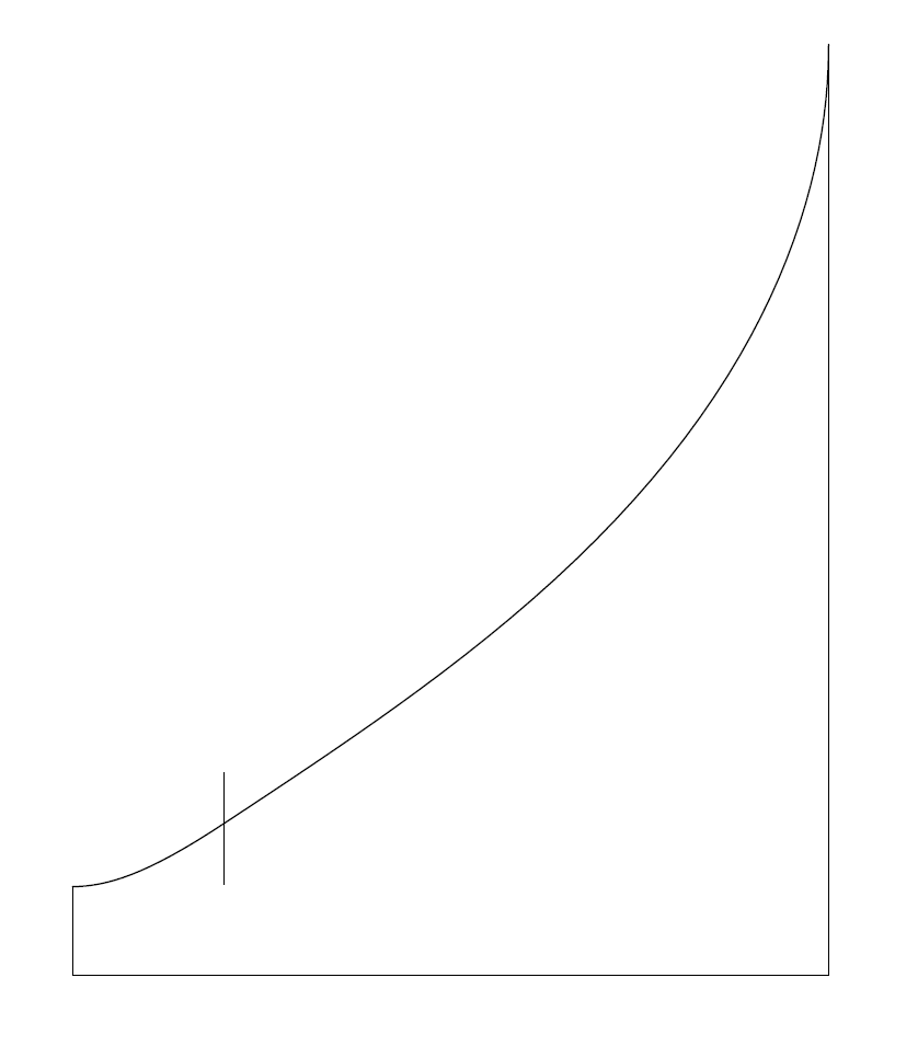

I noticed that your program does not appear to match curvature between the OS section and the termination. The error is pretty small in most cases, but becomes obvious if Depth.ConicSectionPart is set to a low value (<0.3 or so).
Yes, I realized this just after I released the tool... It's still tangent but curvatures at the joint may be (and will be) different. It's because I forgot to take the OS curvature into account - I just assumed it low enough, which is not allways true - especially near the throat, as you say. I will correct this. The solution is simple - to find the corresponding curvature on the clothoid and make the join at that point (now it's allways the origin of the spiral).
Thanks. At least someone is looking closely 😉
Glad to help. I noticed the issue after adding clothoid termination to my own waveguide generator script since I had made the same assumption that you did. I use a simple iterative algorithm to match the curvature, but I wouldn't be surprised if there's a better way (my math skills are a bit lacking compared to some others here 😱).
BTW, if an OS waveguide is terminated by just a circular arc (a simple radius), there will be a big step change in curvature ("2nd derivative") at this joint. It can be made much smoother with the spiral but as you can see, care must still be taken...
Ha ha, it won't be so easy after all - what must match is a curvature, tangency and a size at the same time. I guess some iterative algorithm will be necessary...

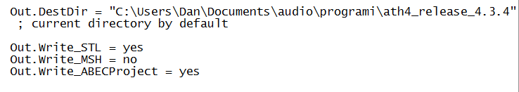

does the ath4 generate STL file which can be opened by STL viewers.
If not what is "Out.Write_STL = yes"
Of cource it does. The parameter Out.Write_STL controls whether this file will be created or not. Only beware you must correctly specify the Out.DestDir parameter as well.does the ath4 generate STL file which can be opened by STL viewers.

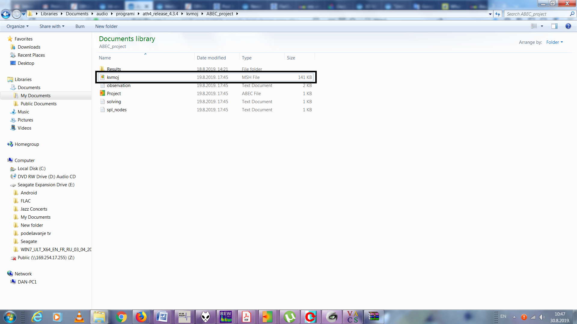

Your STL file should be in the project's root directory, i.e. "kvmoj". The files under the subdirectory "ABEC_project" are solely for the purpose of simulation - the mesh (.msh) file there corresponds to the STL but has some additional features required by ABEC to run properly.
Yes. Your PC has just a different default association for .stl files, i.e. thinks it is something different. That's OK, you can change it or leave it as it is. Just open this STL file in an appropriate program (CAD, MeshMixer, etc.).
