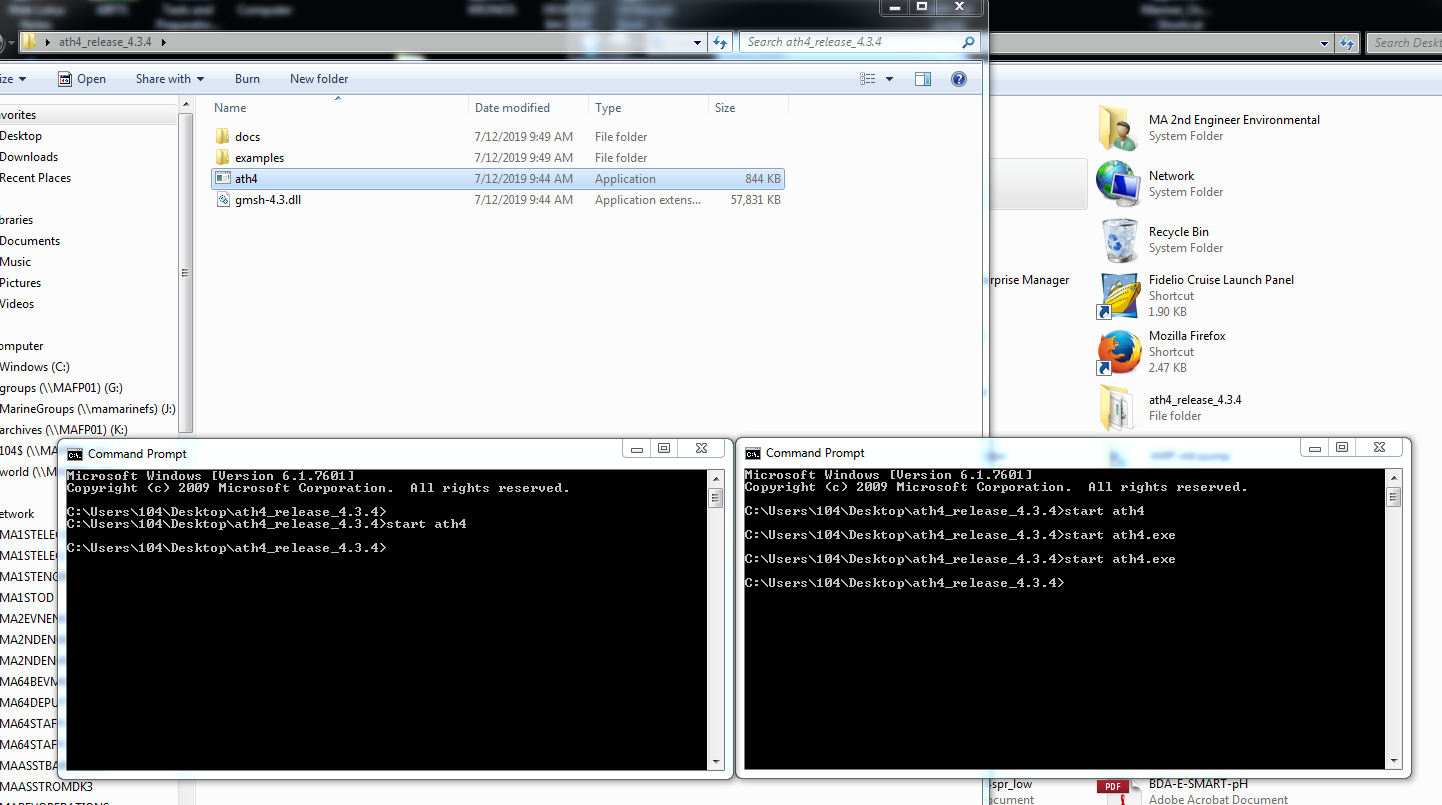

Hi guys
I know that you are already couple of steps forward but need some help with ath4 application.
I followed instructions, extract ath4, copy in same directory gmsh-4.3.dll, made cmd shortcut and copy file path in "start in". When I double click cmd shortcut nothing happen, actually new cmd window blink for a second and disappear. I rename ath4 to ath4.exe and tried again, same thing.
After that I've tried to go regular procedure: open cmd, type cd (file path), enter, type start and application name (both ath4 and ath4.exe) and same thing happens.
After first fail I deleted all files and download and repeat everything again on two computers with same results.
So please is there any known solution ...

Don't type "start ath4", just "ath4".
There is a chapter "3. Working example" in the user guide. Please go step by step as shown. You will also need to change the output directory in the script file(s): Out.DestDir = "..."

Thank' Marcel
of course it was about me, after follow manual and your advice's everything working fine
