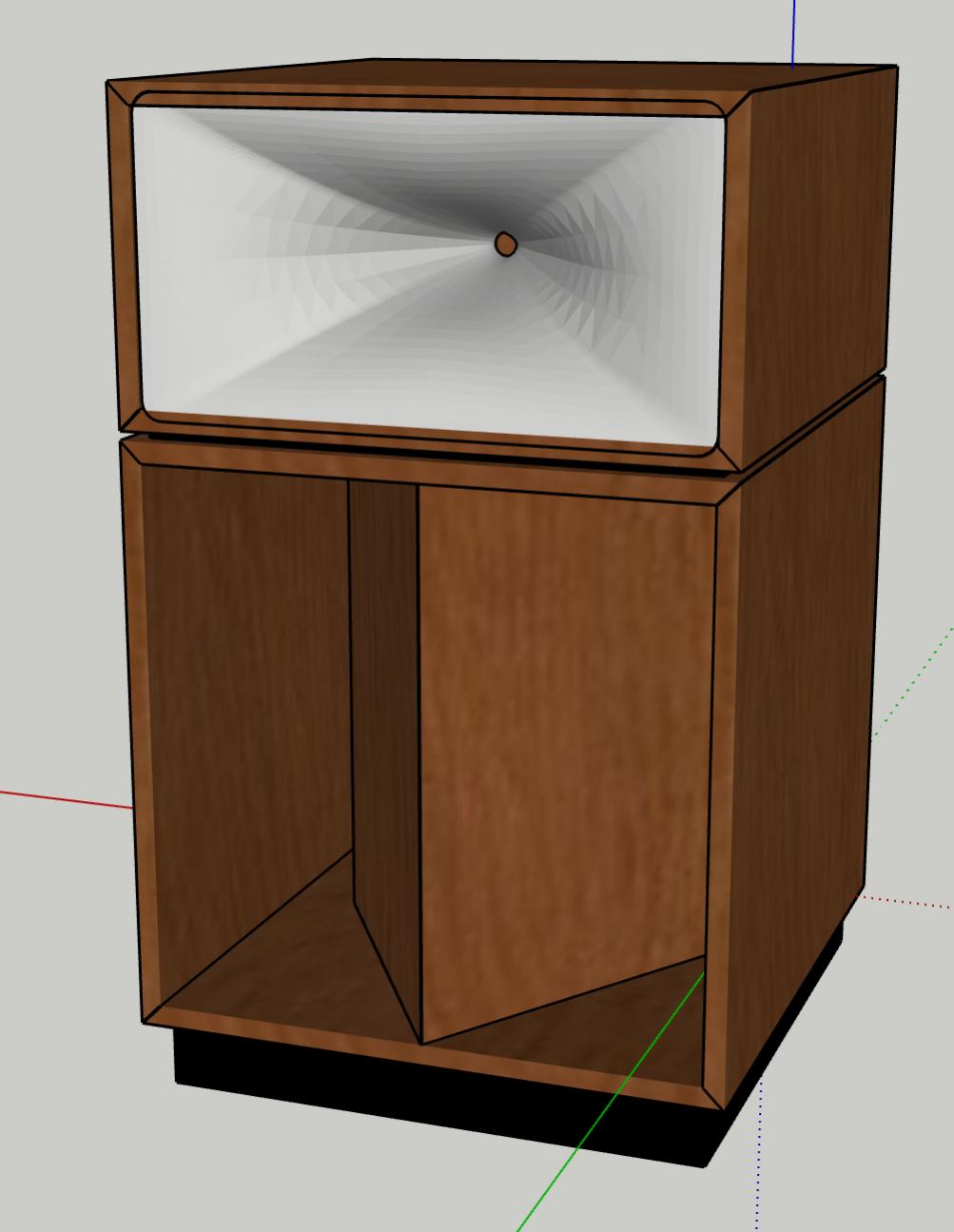

The crazy thing, is that I could SWEAR that I was able to get meshmixer to close that waveguide. Last month in meshmixer I used some combination of settings in meshmixer, and it simply "filled in" the inside of the waveguide.
For the life of me, I couldn't get it to do that yesterday.
It's not the end of the world; extruding the shape gets the job done too, but it's messier.

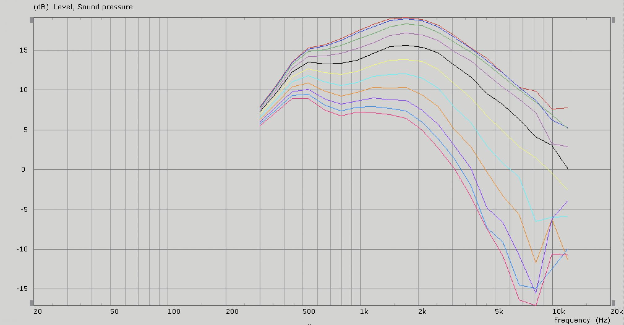

Did some quick and dirty experiment with a 80x40 horn:
One question though: is there an easy way to control the size of the horn? What I did now is tweak the depth and angles to get in the ballpark of the size I'd like, but that limits me to a specific range of angles. Let's say I want to make a 2:1 (w:h) sized horn that is 90x90 deg. Can the tool do that for me?

It's fine to use the trail and error method, as long as I know what knobs to turn. So how then do I go about making the horn in my last question? Or even the reverse: a (almost) square 60x40 horn?
That's not possible at the moment, I'm afraid, because you must enter the angles first. Together with the depth (and other variables) this will lead to some mouth dimensions. You see, when the mouth is squarish, it's strange to have the two coverage angles different, and vice versa.
I see a simple solution however. For a rectangular horn (i.e. for Shape = raw2rect), I will make parameters available for any target mouth dimensions you may like (now it is taken from the raw shape's width and height before the final transformation).
Stay tuned 🙂
Stay tuned 🙂
I don't think that's possible.
Here's why:
