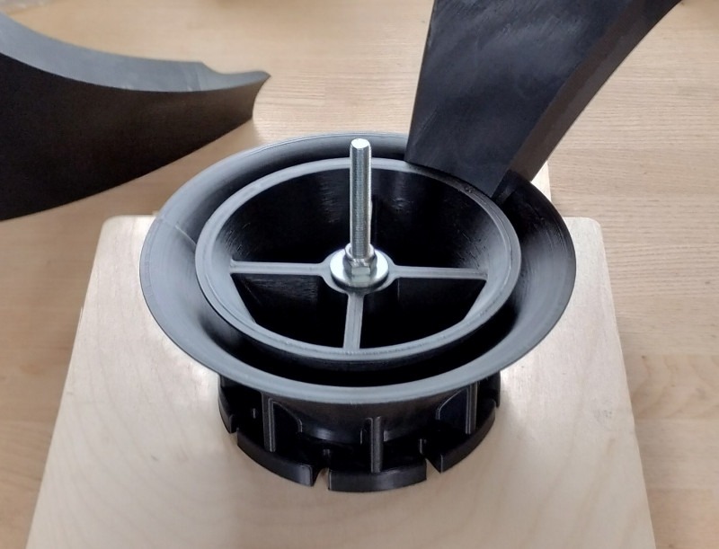

You need four threaded rods or long bolts, going through the whole adapter, to attach the driver.I haven't figured out how to attach the short adapter yet
Thnx, already bought them 15 minutes ago))You need four threaded rods or long bolts, going through the whole adapter, to attach the driver.
Hmm, ok, I’ll try to look for, although doubt.there must be a leakage somewhere.
Sure, I'm wondering what's going too🙂Just trying to explain what we see, because it's really strange...
I put a layer of double-sided tape between the long adapter and the horn, on the driver's side there is a small layer of sealing rubber - it can be considered airtight. The curve has not changed.

Ok, I tried it - the adapter doesn't leak, literally! 🙂Does the long adapter hold water (I mean literally)? 🙂
I'm still not promising that I've done everything perfectly (I sometimes go back to check if I've locked the door when I leave the house)), but I've tried everything and it doesn't seem to be my fault, but that's how it works with my driver. I guess I'll have to wait for someone else to test it.

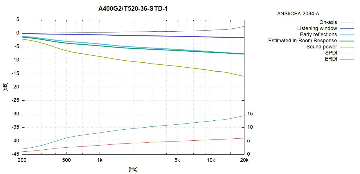

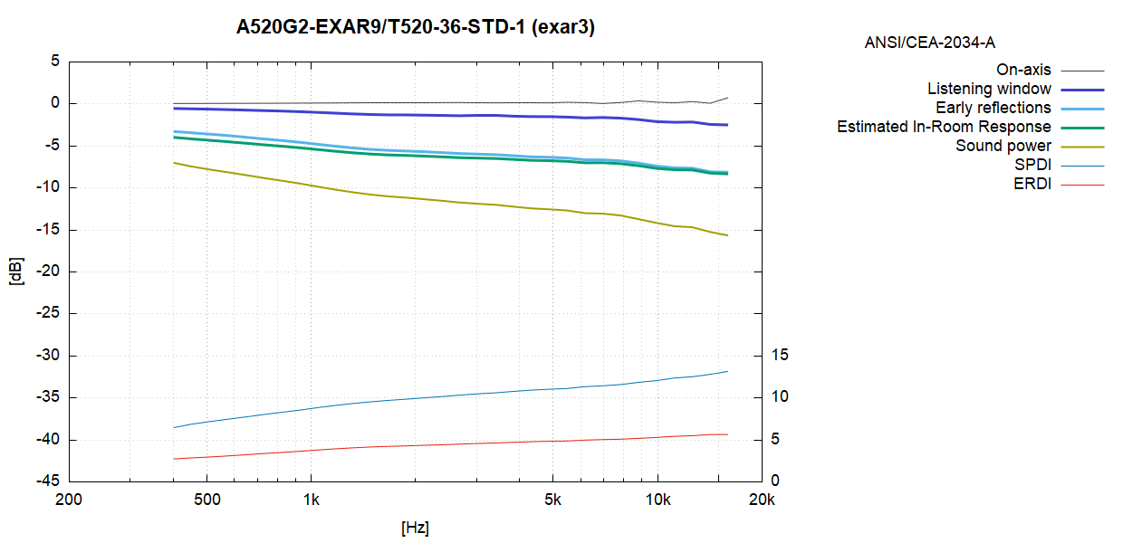

Hello everyone,
Was wondering if anyone could share a link for generating the above graph, tks. I know VitrixCAD2 can plot it but was wondering if there are other alternatives.
Much appreciate
GQZ
For this particular graph, polar data are extracted from ABEC output, processed by Ath and corresponding plain-text files generated for gnuplot.
This is all done automatically with the latest Ath version (includes a gnuplot script) - to run ath.exe you would need a key file that's included in the Cults packages for A520G2/A400G2, but you can use the provided gnuplot script right away.
Then in an Ath script set:

I only think that full 0 - 180 deg polars must be calculated for this to work, 10deg step should be enough, I keep 5 by default. Basically, all the polars that are required by the CEA2034 must be directly available:
Code:
ABEC.Polars:SPL = {
MapAngleRange = 0,180,37 ; start_angle, end_angle, no. of polars
I'm not sure if this works with the older version(s) of Ath. At some point I added this but don't remember when. It's nothing that would be impossible to live without but people seem to like it 🙂
