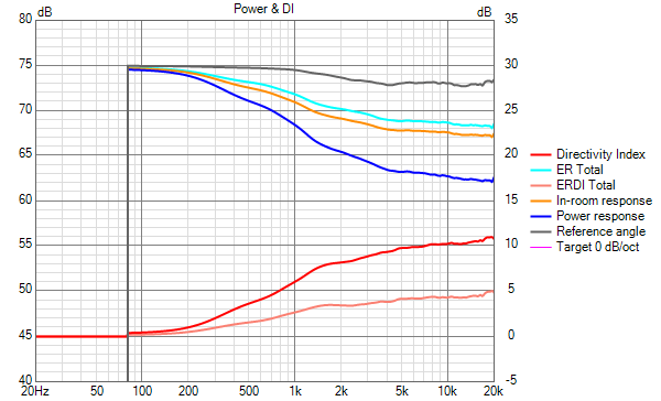

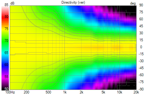

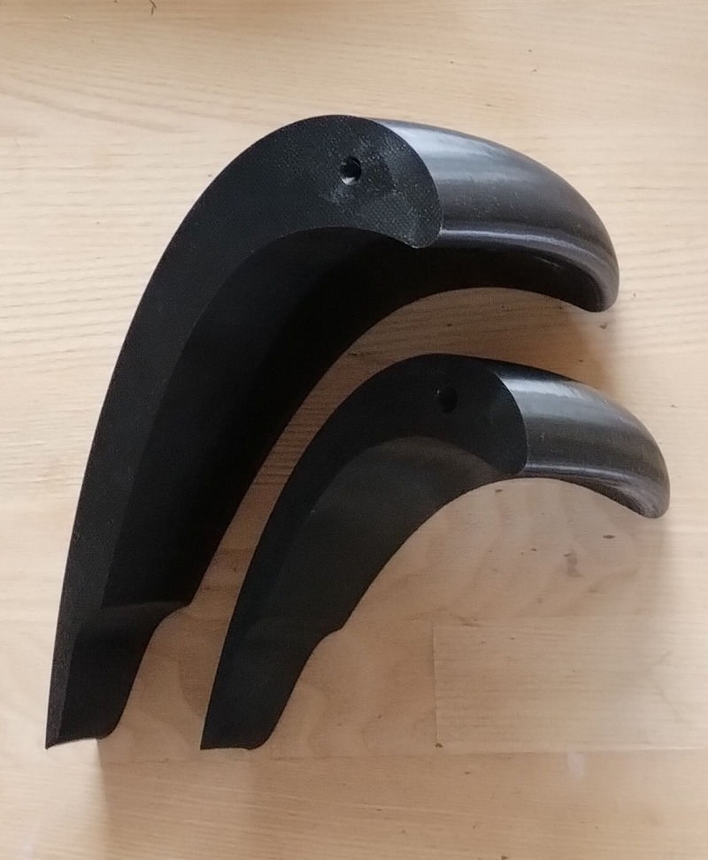

The image will probably be confined to a smaller area around the stereo center. Very compact and solid image, detailed imaging, but what you hear will be presented to you without a sense of size.All criticisms welcome because I still don't understand directivity and directivity matching with enclosures: Is this too beamy? Too narrow?
The petals for A520G2 and A400G2. When put side by side, it's quite a difference.
There will be nothing smaller than the 400 🙂

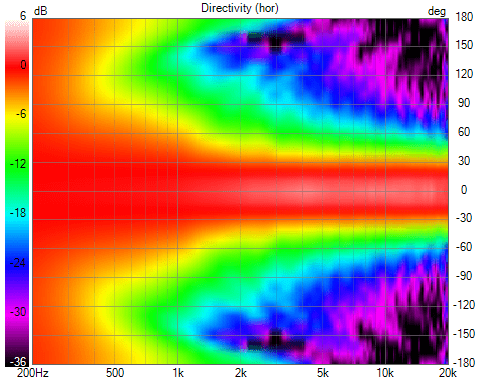

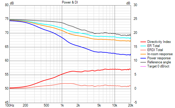

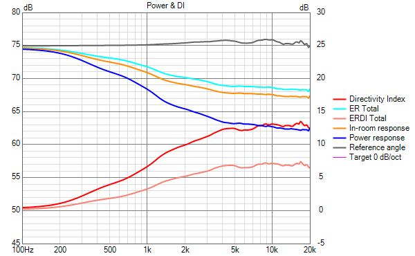

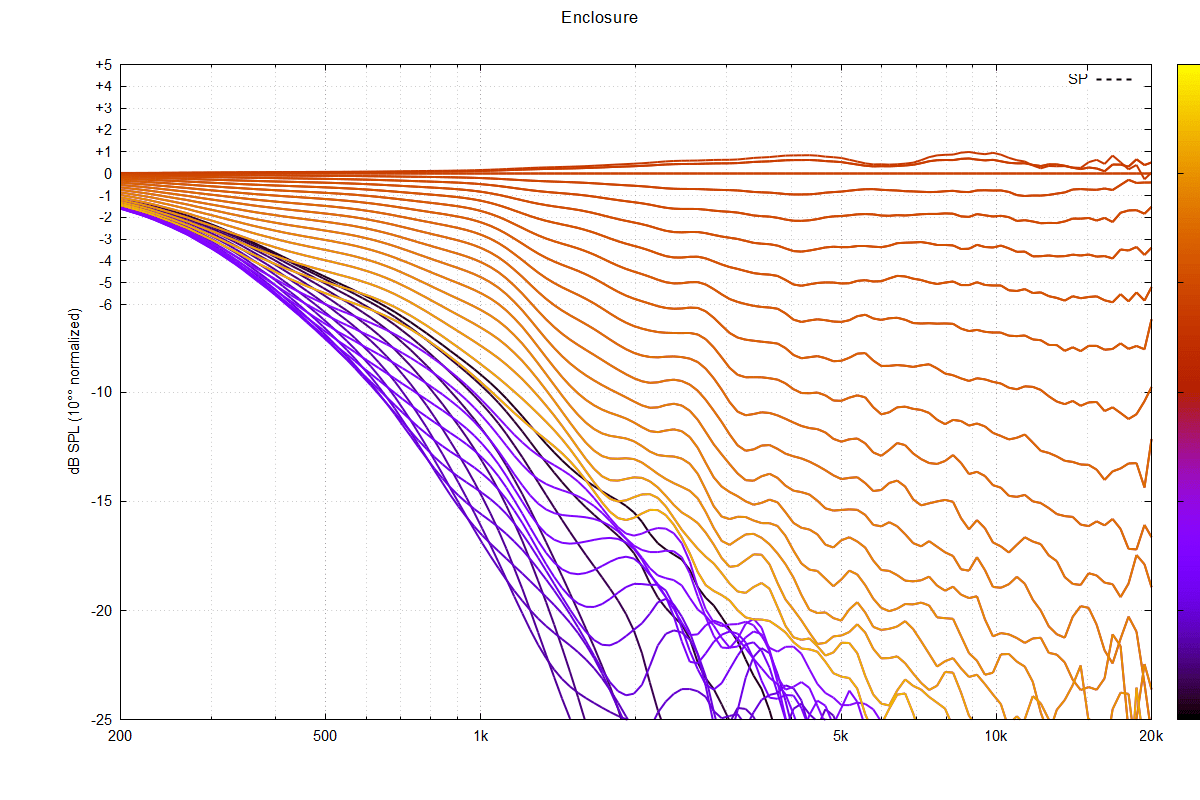

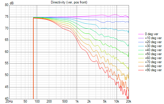

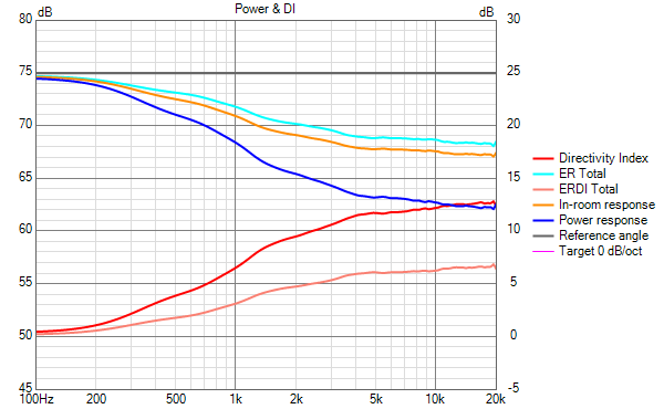

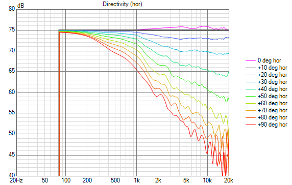

Changed the parameters for the horn I simulated in post 14,893 to flatten directivity above 4kHz. It can sort of work down to 3kHz between 20 & 25 degrees. Intuitively, I think something like this should be controlled to 2kHz minimum, so it would need to be a little bigger. Even though it might be too small I may print a waveguide to test effect of entry ports on the higher frequency range I want to keep flat. Config attached in Zip.
0, 10, 20, 30 Power+DI (10 degrees)
Normalized 10 degree line chart. You could sit off center with the far speaker at 10 degrees and the near at 30 with a 5 dB drop level from 4kHz to 10kHz.
Center of polar still isn't smooth so sitting at 0 degrees wouldn't be as nice.

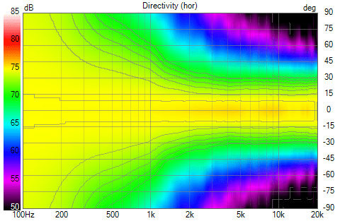

+/-90 Horizontal, Vertical

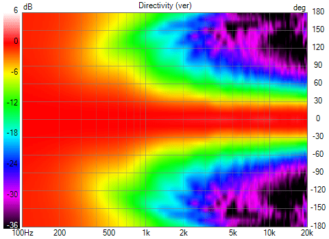

+/-180 Normalized (Yellow is -6dB)
Horizontal, Vertical. Vertical image should show more white like the Horizontal due to uneven 0 degree axis. It didn't come through in the image.

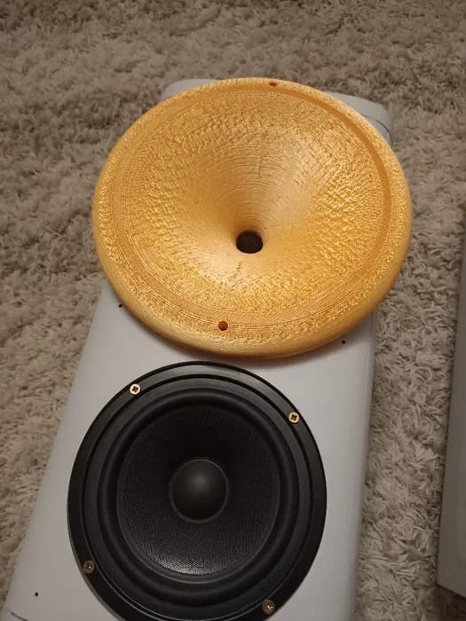

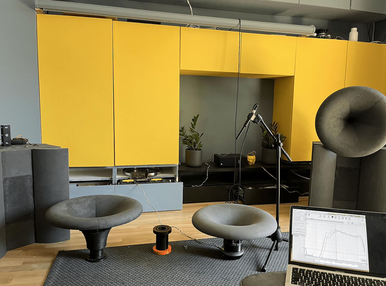

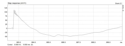

Hi @mabat, 940 driver + upscale horn (red), and + Gen2 long extension (green) and short one (blue). 😎
I haven't figured out how to attach the short adapter yet, so I had to shoot at the ceiling, but I think the measurements are workable with the short window.
