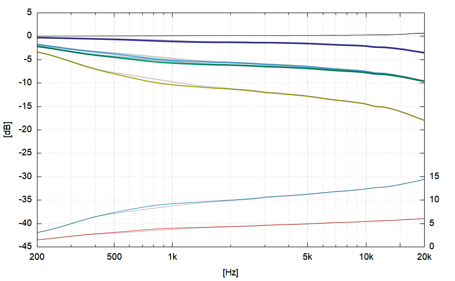

BTW, with a bit different mouth shape, I was able to reduce the waveguide diameter from 520 to 460 mm while keeping the performance virtually the same down to ~600 Hz:
(light gray = A520G2, color=A460G2)
It may not seem as much but those 6 cm are a big difference visually.
If one wanted to stay at 520, how could this insight be utilised to ones advantage?
Staying at 520mm it would just lead to a higher DI around the "knee" -
I'm not sure this is the best thing, as it's often problem to reach this with the direct-radiating transdures below.
But it's not a huge difference.

OK, we don't want that really no... so making it smaller is the "only payback" for this... maybe one could say that staying at 520 using the invention would enable directivity control at a lower frequency - whatever directivity one would want - wider or narrower..?
Yes, it enables directivity control to a lower frequency, but with a sharper DI knee where the transition occurs (below some frequency the DI always starts to decrease no matter what, that's simply given by the mouth size). I tend to think this is not as beneficial but these are really nuances.
The current A520G2 (and A400G2 as well) are designed so that this transition is very very smooth. But it we don't need to go below ~600 Hz, it can be made smaller with the same performance. That's really the point.

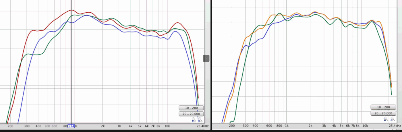

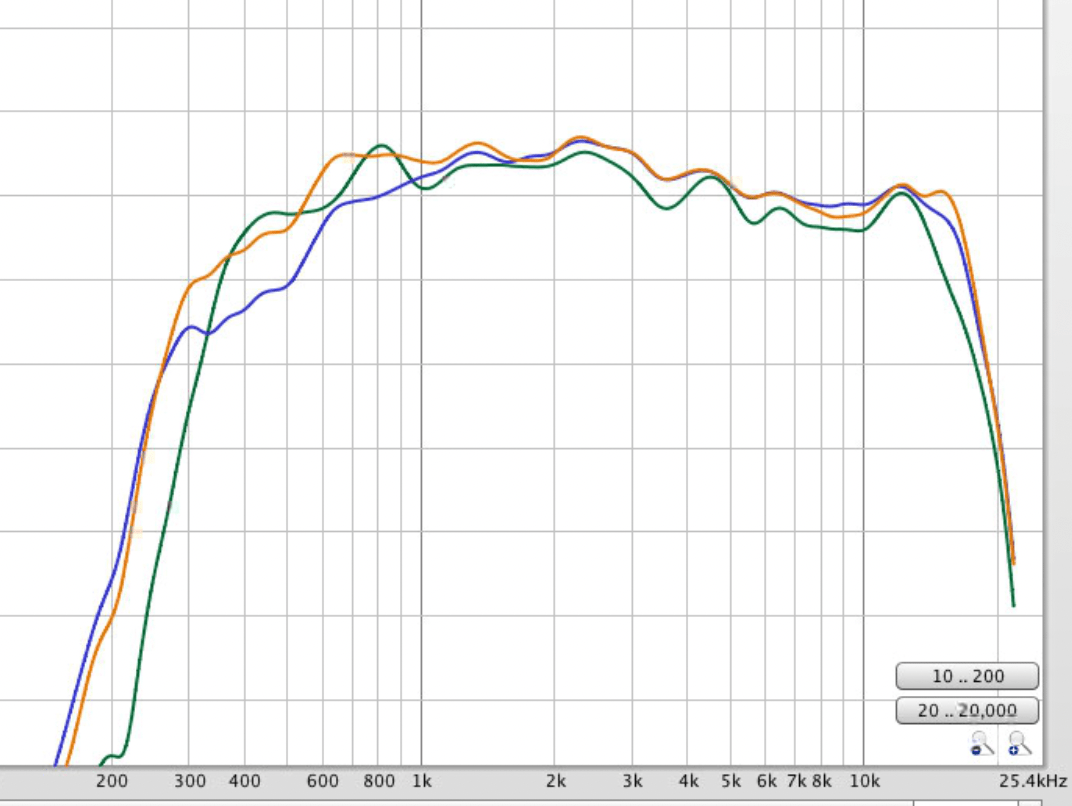

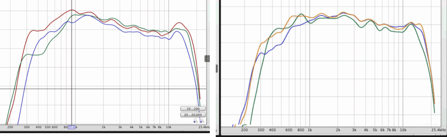

Hi @mabat, I finally got to test the last version of the adapter.
The measurements aren't accurate, I shoot the ceiling again and just rearrange the adapters.
6 cycles window, 5dB step, mic is always at the same distance from the driver (~90cm), and I tried to place the horn in the same place (so I don't think the difference in the top end is due to microphone/horn position, it was seen on other measurements as well).
T520-36-STD-1 - green
T520-36-EXT-1 - blue
T520-36-EXT-type-B - orange

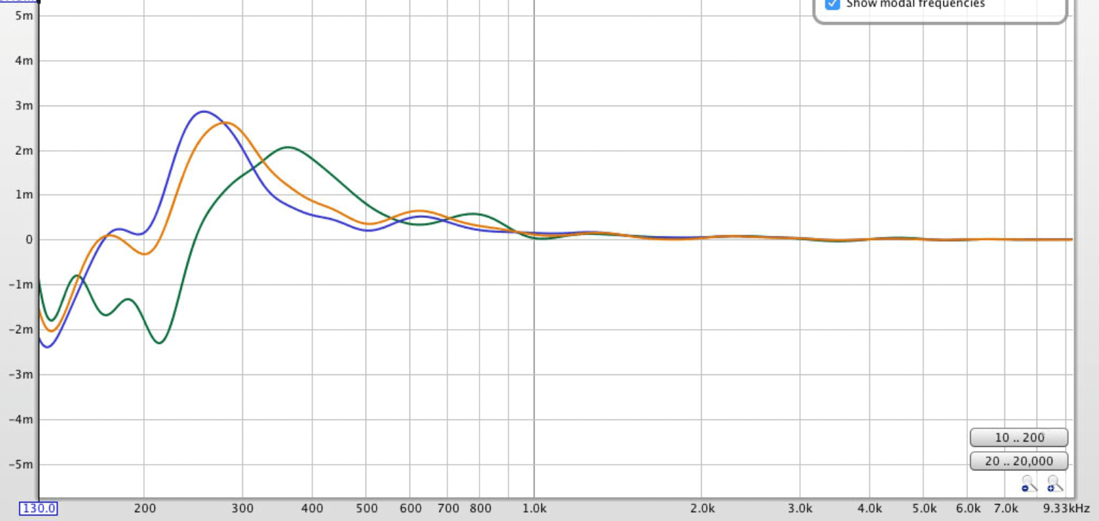

Group delay:

It's only a pity you can't take cleaner measurements. At 400 Hz six cycles mean 15 milliseconds, and in that time you collect reflections from all around. But I know very well this is the most difficult frequency range to measure at home, and I don't know how to improve it without a lot more serious effort.
- Now I think if the long adapter isn't just too long here.
The top octave is also a bit of a mystery. I wouldn't expect such differences, but it may be, as it's already above the simple-wavefront mode of operation, I suppose.
I'm thinking about taking the horn out on the terrace and making a cleaner measurement outside, but I don't know when that will be possible, especially since a building is being built next door and the environment is quite noisy.
The top octave is also a bit of a mystery. I wouldn't expect such differences, but it may be.
It looks like in the top octave the driver's wavefront is far from ideal, so the results will be different with different drivers.
But definitely, the more-conical EXT adapter is a clear improvement.
Right now it's for example not clear, IMO, if the dip at 500 Hz is due to a reflection or not. Or if the ~10dB gain at 250 Hz is real or not.
Also, the green one will be probably a lot smoother.

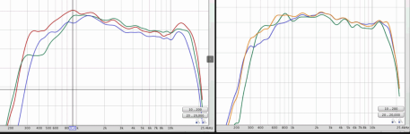

Oleg, looking back at your previous measurements, there are so large differences that it's indeed difficult to make any judgements.
- Do I understand it correctly that the green on the left is the same device as the blue on the right (i.e. EXT-1)?
And the blue on the left is the green on the right (i.e. STD-1)?

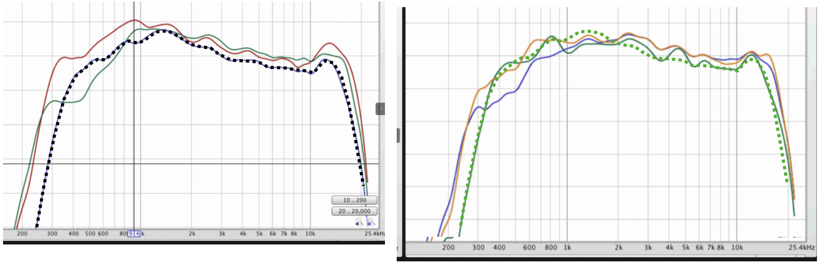

The main differences between these measurements: a slightly different scale at the pics; the distance was a bit shorter, ~60-70 cm as I remember vs ~90 cm, and maybe not the same FDW (4/6 cycles? not shure)..
E.g. short adapter, measurements looks closer after scaling (I don't save old measurements, thus by hands):
And yes, the colors are reversed, Green 1 = Blue 2, Blue 1 = Green 2. There's a couple dB difference, but I think the difference between adapters is pretty constant overall?
I apologize for the inaccuracies in the measurements, I'm doing my best. I will install a new long adapter soon and try to take better measurements.
