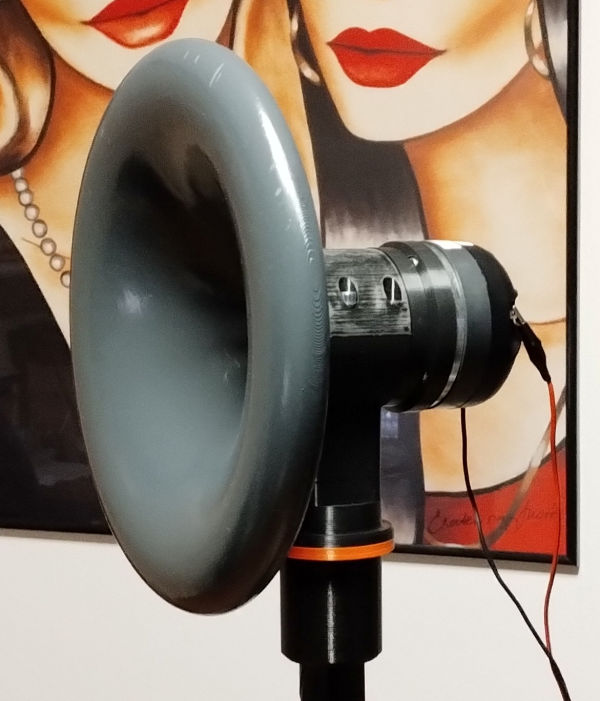

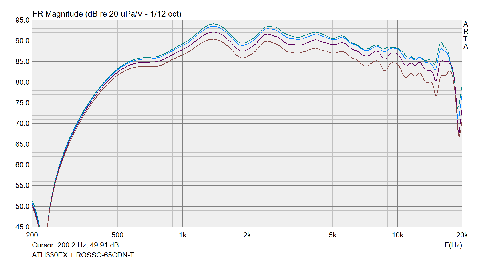

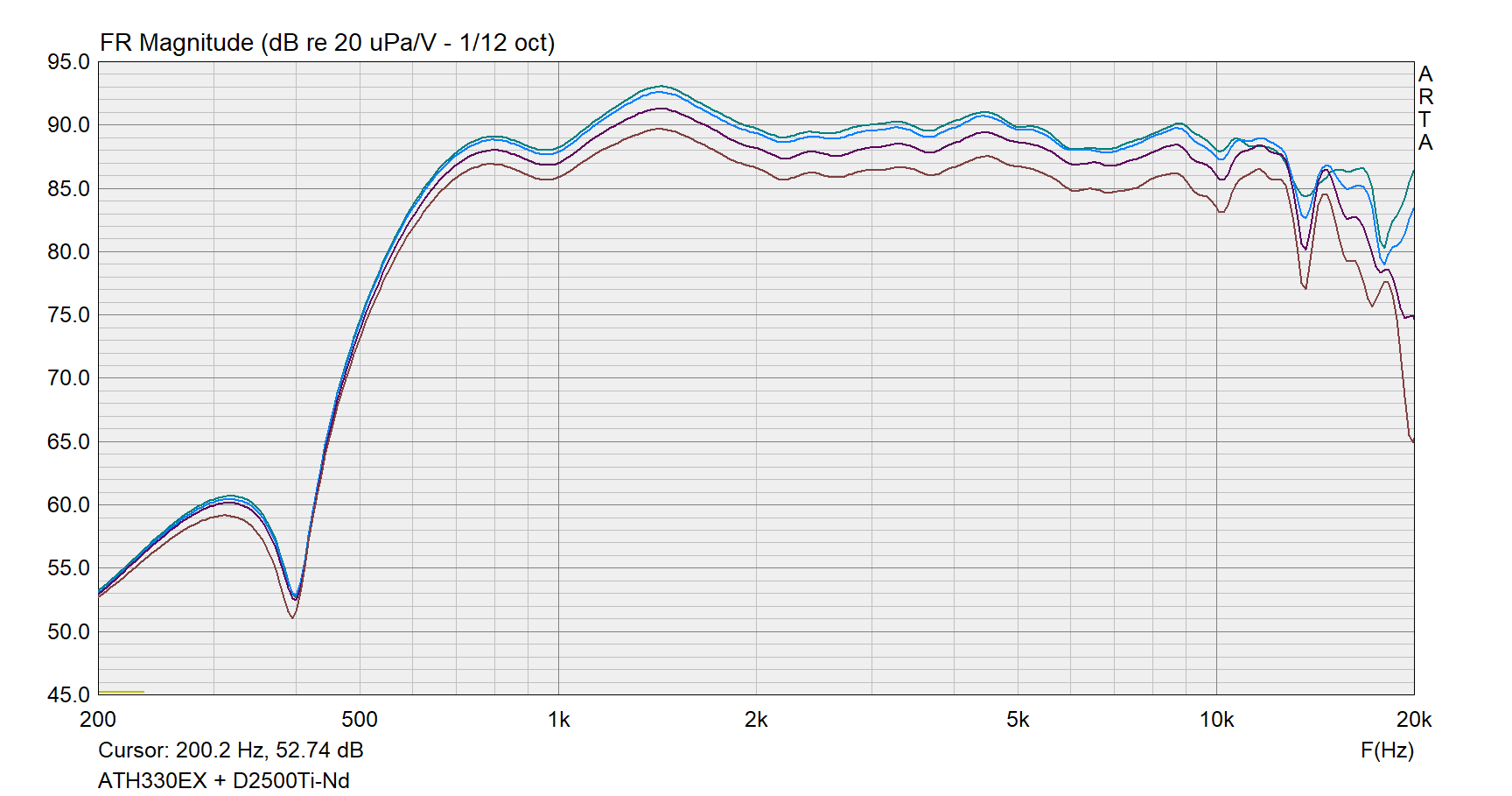

ATH330EX + SB ROSSO-65CDN-T/1" throat plug

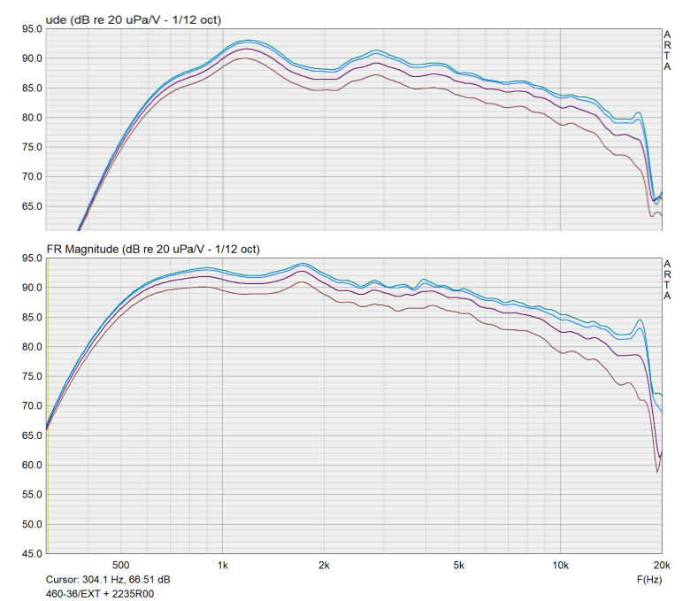

This is not as pretty as I would hope for. Could be that the Q of the extension is too high, I don't know.

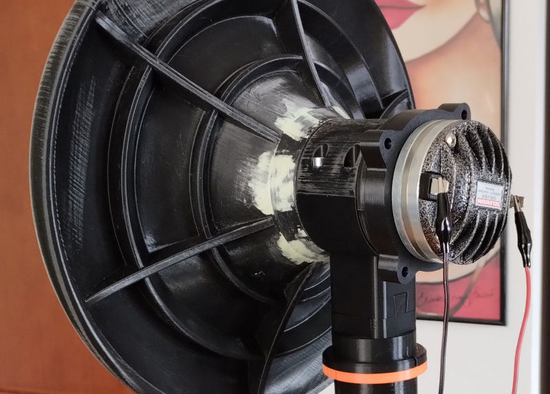

ATH330EX + Selenium D2500Ti-Nd.
For some reason I'm always happy with this driver, no matter how it's used.
And there's a big mismatch of the exit angle in this case.
BTW, this is the same driver in a bigger horn with a conical throat extension, starting at the phase plug exit:
http://www.at-horns.eu/exar-story.html#d2500

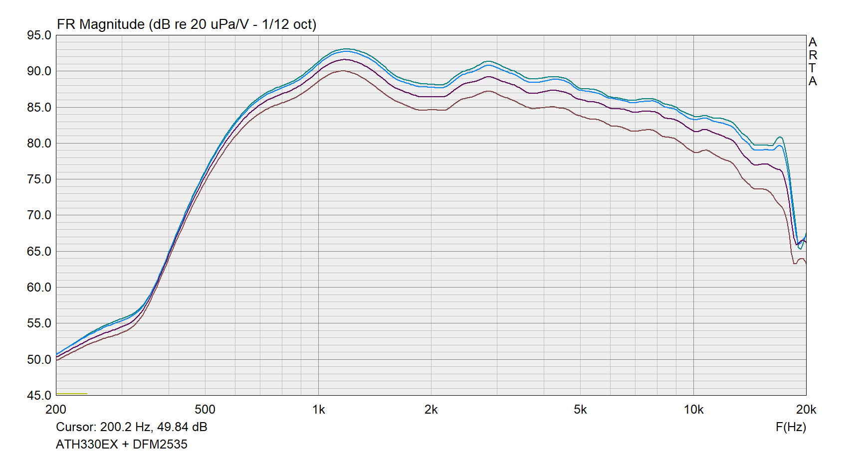

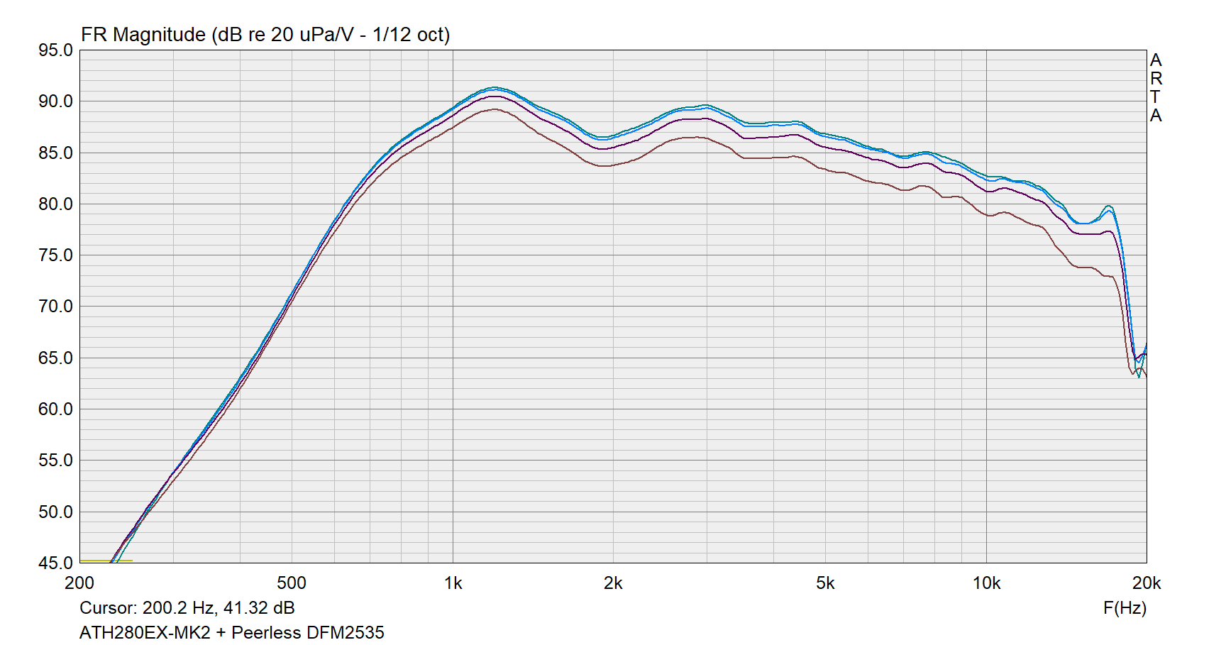

ATH280EX-MK2 / Peerless DFM-2535 (again, roughly 0/10/20/30 deg off-axis).

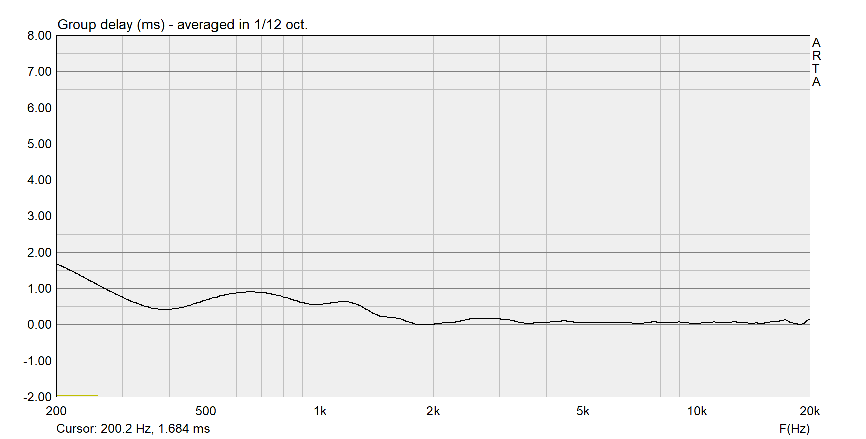

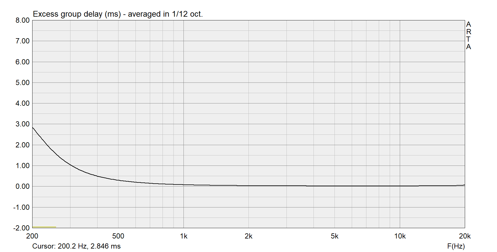

Group delay and excess group delay of the last measurement. Still, a minimum phase system in my book.

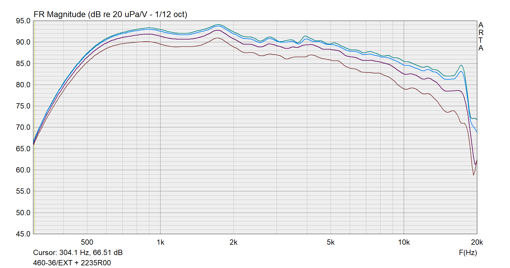

The same 1" driver (Peerless DFM-2535) in three different (free-standing) devices, from small to large:
- I think a different approach is needed. It seems to make the most sense to separate the horn and the whole extension part, as it was done in the original experiment. Since the directivity limitation of a 1.4" throat seems still acceptible, the horn part would start at this diameter and the extension part could be more flexibly optimized for a particular driver, including a possible throat ring. The question is what throat angle of the horn to choose. In the experiment this was 6° (total), so maybe something around this value.
And again, it just shows that it doesn't make sense to waste time with small devices. 🙂
Could you post associated impedance plots as well? Thanks! Look how the dip ~2kHz is replaced by peak on the last device. It seems one could have ~flat frequency response at least with this particular driver, choosing something in between. I assume this stuff is readily seen in the impedance plots, and if it is one could optimize for smooth FR comparing driver impedance to waveguide impedance.
edit. actually, the datasheet shows no (driver) impedance wiggle around 2kHz, so all of the differences are from the waveguides and how it's impedance affects the response?
https://products.peerless-audio.com/transducer/438
I will do the electrical impedances separately later, but I'm not so optimistic it will be that easy. The question is what is a "waveguide impedance" - where to look at? At the phase plug exit of a driver, or even closer to the diaphragm? Certainly at the exit of a driver it's too late, as the exit section has its effect. It's a coupled system which only a part of we know something about separately.
I think we would need to start modelling the whole drivers. Way above my pay grade.
What kind of difference simulated throat impedances have (from ABEC)? Frequency response wiggle between 330EX and the 460-36/EXT are almost opposite ~1-4kHz, perhaps the simulated impedances gives a hint. Perhaps results are specific to this driver, but perhaps there is some information to be extracted.
The DFM2535 seems to be nice test subject for this kind of stuff, with very smooth response.

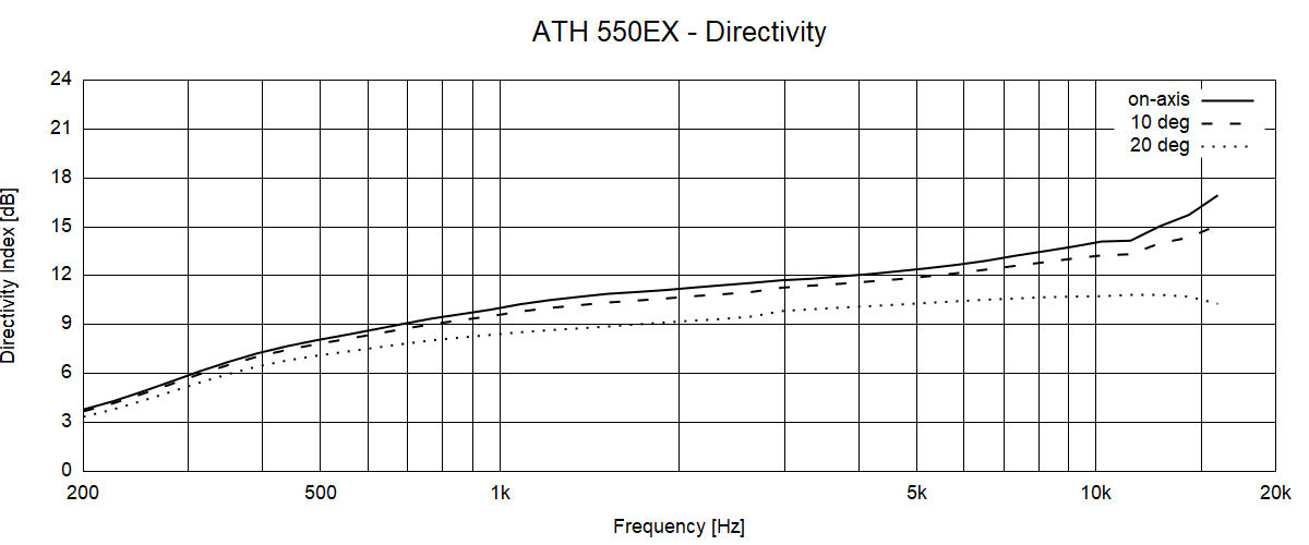

ATH 550EX
⌀550 x 314 mm, 36mm throat
Especially with large drivers it should work from ~500 Hz with ease.
Profile template is available via Cults (see my webpage).

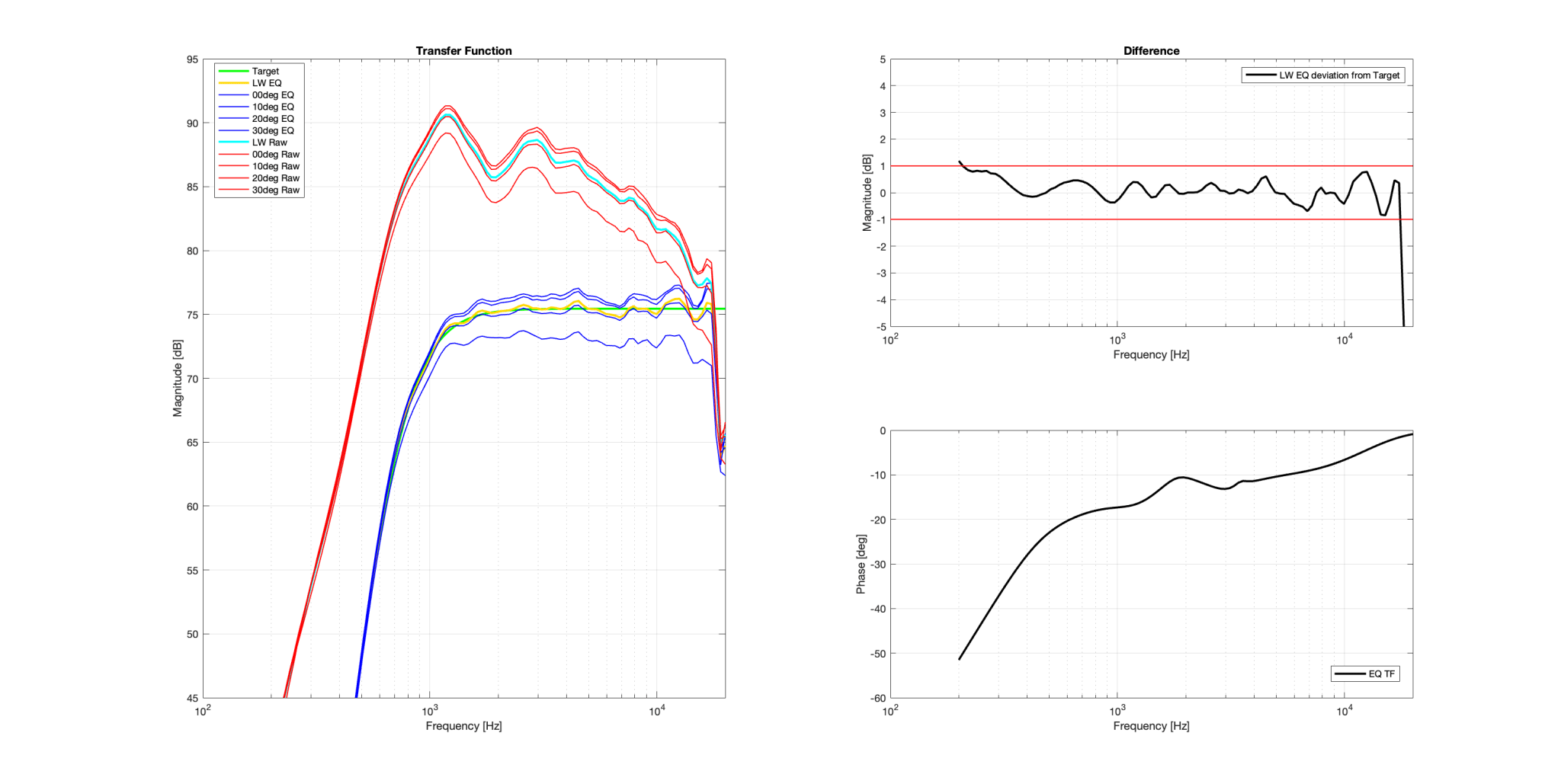

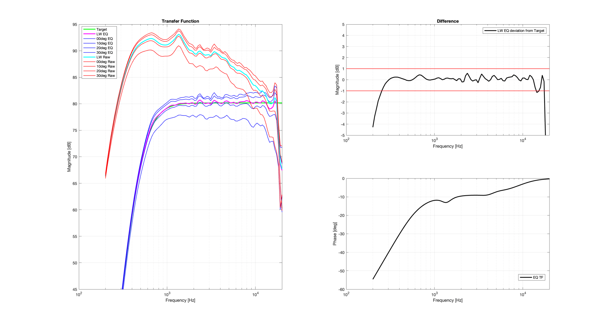

For those interested, this is what 7 Biquads can do on these devices i.e. well within MiniDSP 4x2 HD capabilities.The same 1" driver (Peerless DFM-2535) in three different (free-standing) devices, from small to large:
Actually with the MiniDPS much steeper slopes could be easily implemented on top of advanced EQ.
