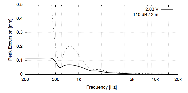

For a compression driver (here in an extended waveguide), the excursion can look like this - for a constant voltage and for a constant SPL (dashed line):
- Some wouldn't use it below 1.5 kHz, I would go down to 600 Hz...
BTW, don't be afraid to measure the CDs without any protective filters, it's really not needed in most cases, it won't break them. The surround is so stiff that it won't let the diaphragm move a lot. It would need to be an insane level to damage the driver.

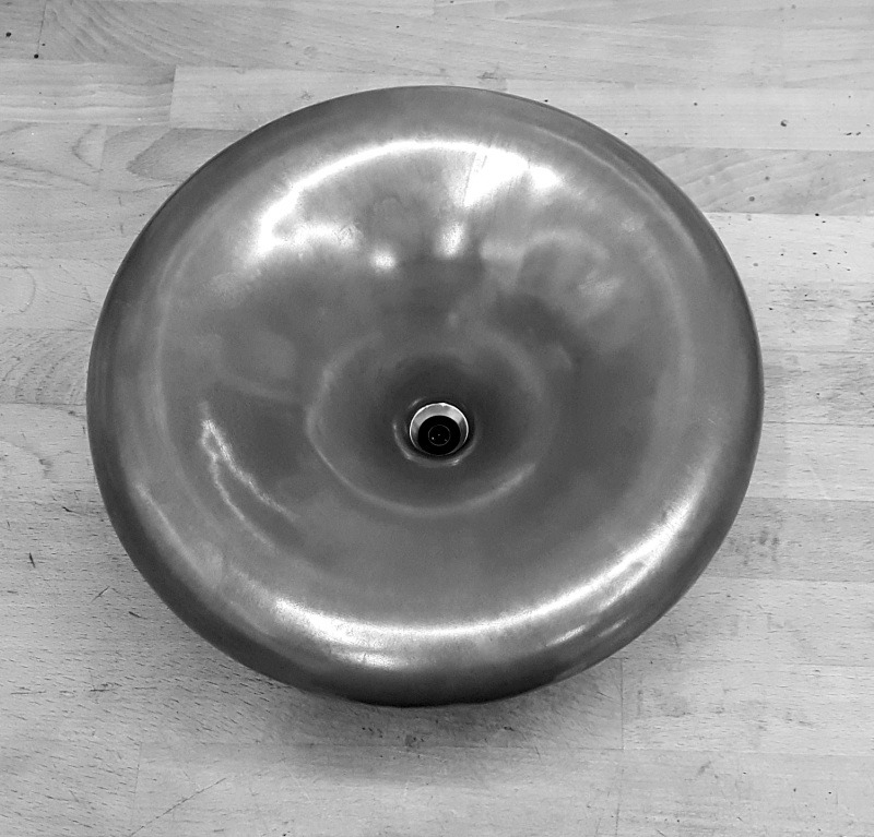

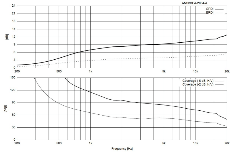

- This is the latest development, the smallish ATH-280EX (#13,808), STL is available via link on my website.
This one should be pretty universal. The gradually rising DI throught the 1k region makes it possible to be used with various woofer sizes, anywhere between 700 - 1500 Hz, depending on a CD used. Around 800 Hz it can be even matched to a "cardioid" midrage unit (DI ~ 6 dB).
Reactions: 1 user
The single most important criterion is a smooth frequency response, including the whole radiation pattern, through the intended crossover region and sufficiently above that. This alone can be pretty hard to find. Above 1 kHz virtually all of the drivers have some problems. If you can find one that doesn't, you're lucky. I've made enough loudspeakers of this kind that I know how tight it usually is, one virtually always wishes for a better woofer...
Or, you can set the crossover lower and forget about it. Almost anything will do up to 600 or 800 Hz. Then, we can look more closely on distortion, etc... There will be a lot more what to choose from.

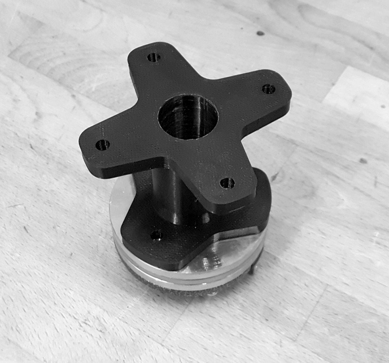

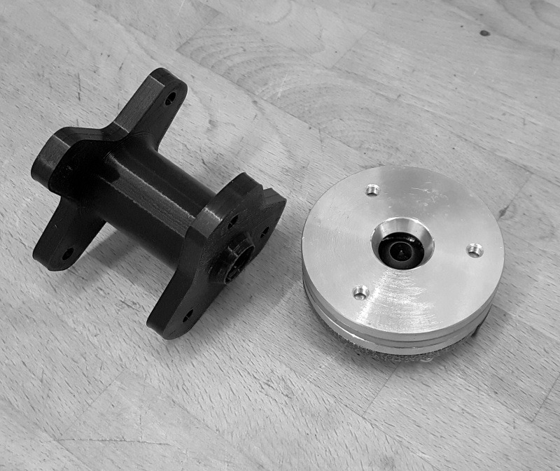

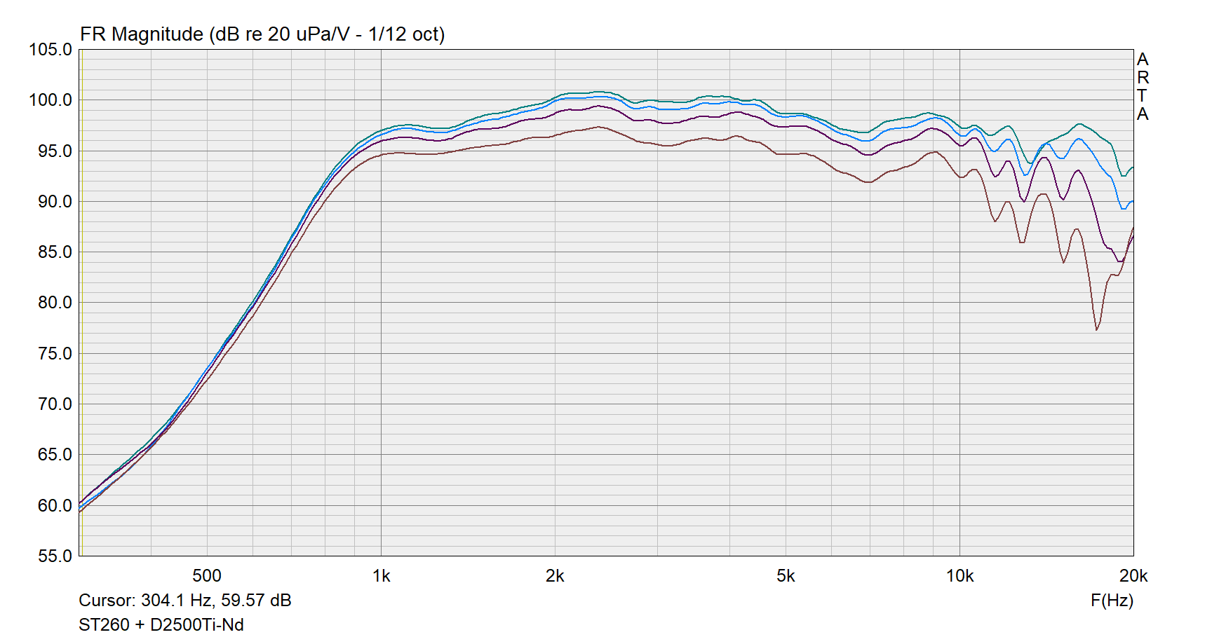

I made a simple experiment, perhaps not as convincing as I hoped for :), but neverthelsess -
This is 1" Selenium D2500Ti-Nd in the ST260 waveguide, connected a) directly and b) via a 70 mm conical duct starting at the driver's phase plug exit. All else equal, I kept the mic-driver distance constant during the experiment.

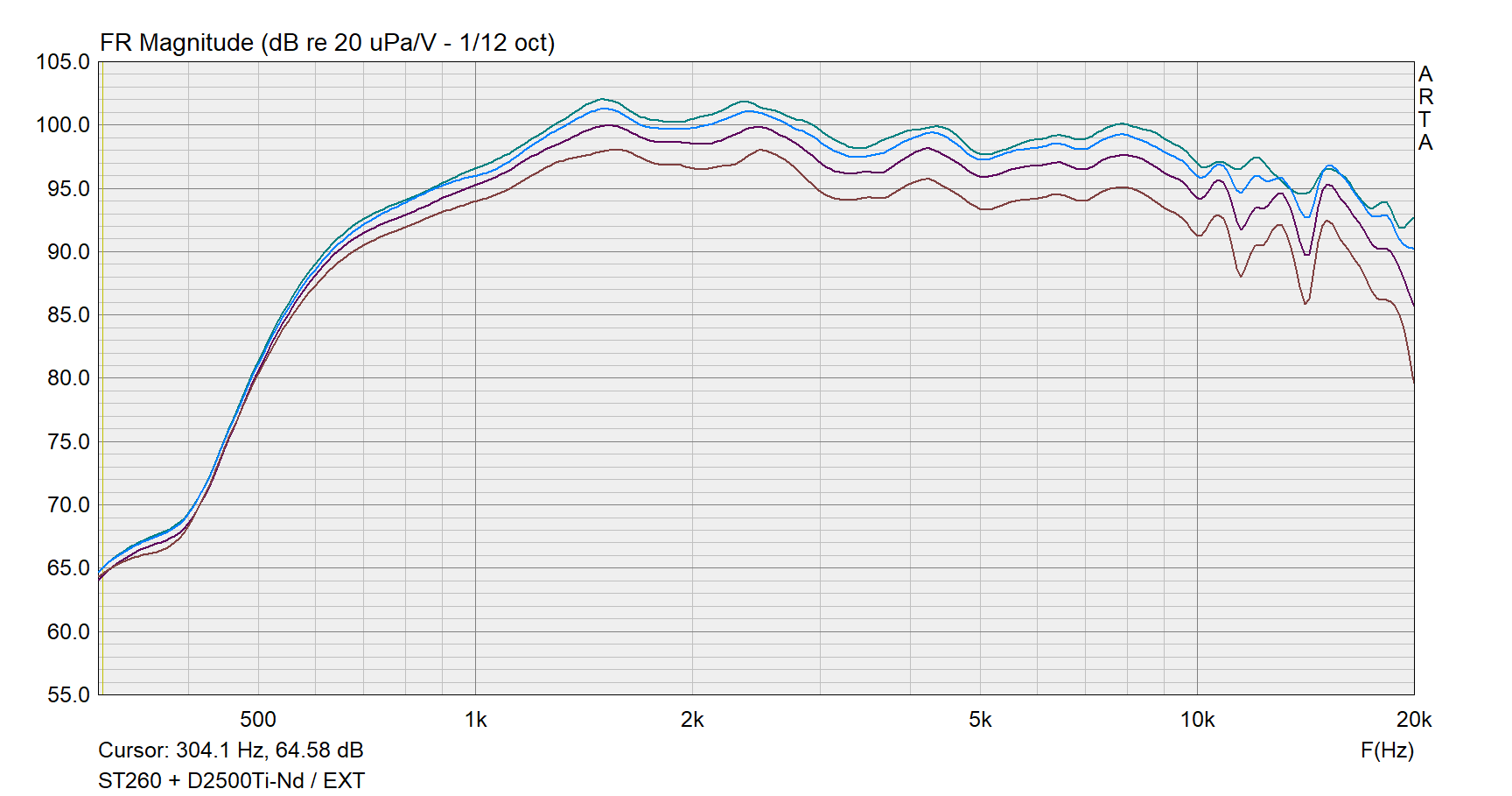

The direct ST260:
Via the extension:

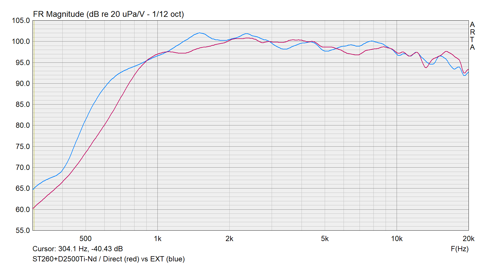

Comparison of the on-axis responses:
My conclusions from this one:
  • The extension added 9 dB of SPL around 600 Hz.
  • The extension adds FR disturbances caused by the throat reflection that need to be tackled in the filters (EQed)
  • In this case, starting at the phase plug exit leads to a more coherent HF response - less beaming in the top octave.

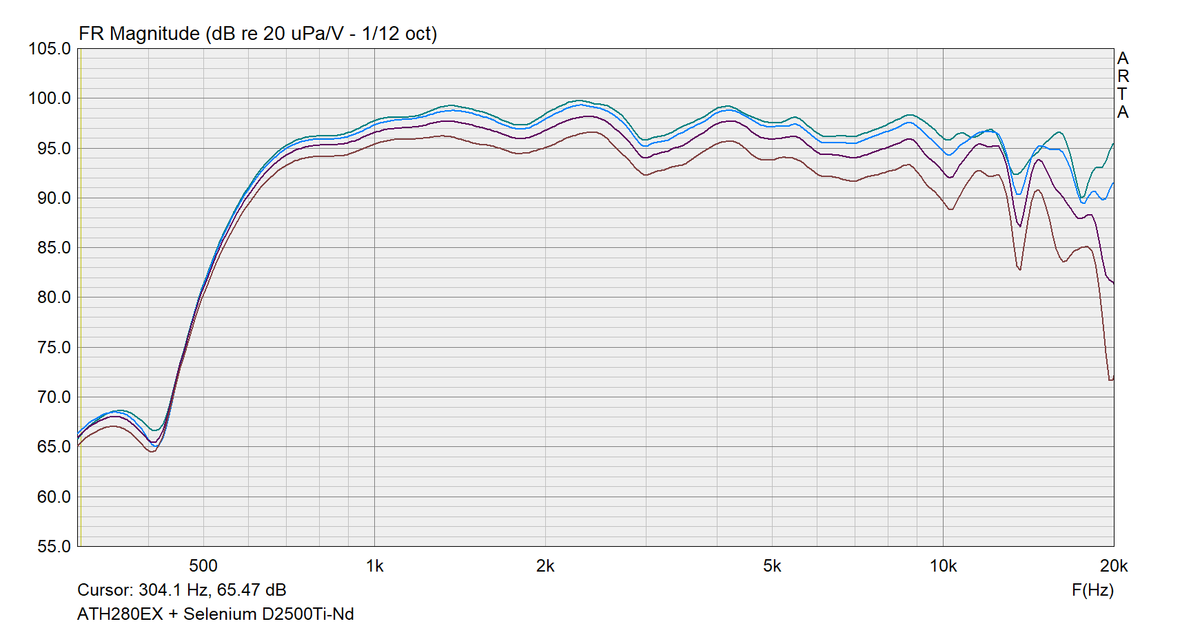

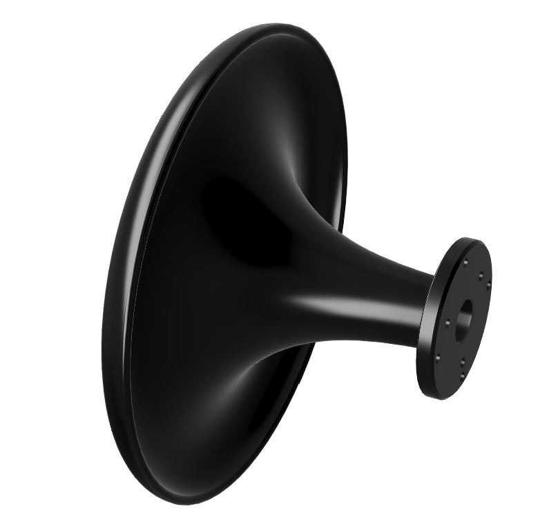

BTW, this is a comparison of the D2500 in the above device (with the extension, top) and in the ATH-280EX, presented earlier (bottom):
(Absolute SPLs are not directly comparable. I'm only not sure this was the very same driver...probably not :()
It seems it's always best to start at the phase plug exit. I'll also try to modify the ATH-280EX for this driver to be used this way, it should further clean it a bit.
