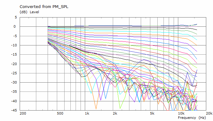

Yes, sure. Let me explain: Setting formal criteria makes it possible to easily try and identify if a measurable characteristic can be perceived. If I continue from my previous example, the PHL 3411: when crossing it at 1.25 kHz, its breakup resonance at 2.7 kHz should be down ~30+ dB after EQ-ing the response to flat. I cannot identify it when listening to music. This might be due to a lack of experience, that is, I would not even know how this breakup resonance sounds, or that it is not noticeable. This is why I am asking.
Joined 2004
It's possible that the PHL 3411 is good enough. I just say it's often a bit "tight" around the crossover and I think that if you showed us the measured data for both LF and HF it would be obvious. There are probably no rigorous quantities of what's "good enough". If you don't hear it, it's certainly good enough for you (and I believe the 3411 is usable this high).

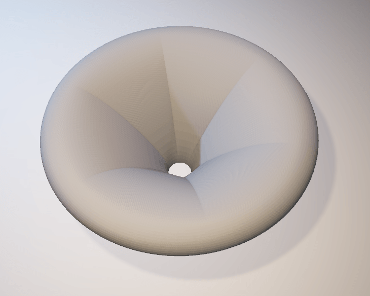

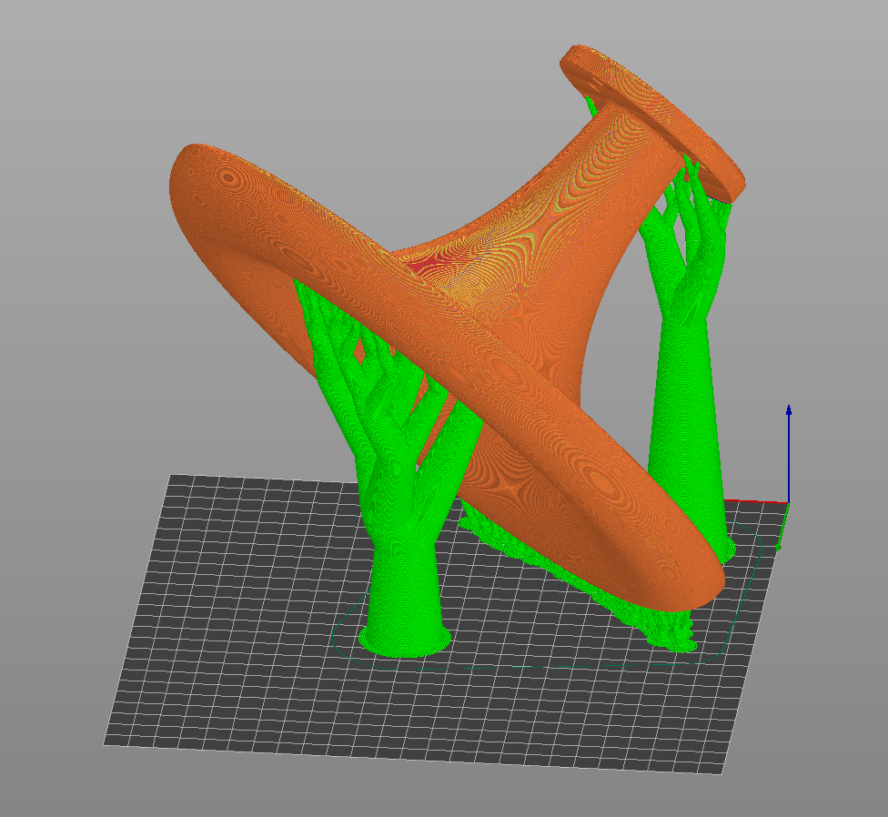

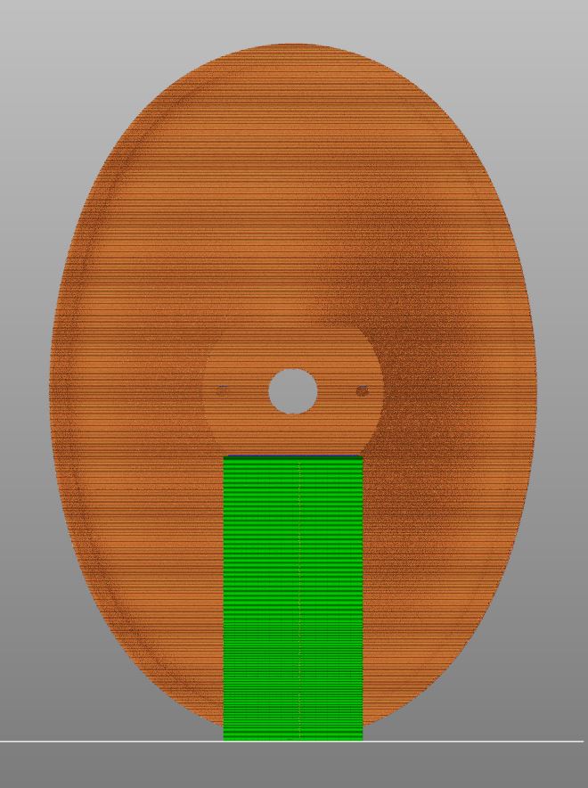

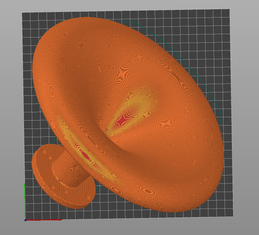

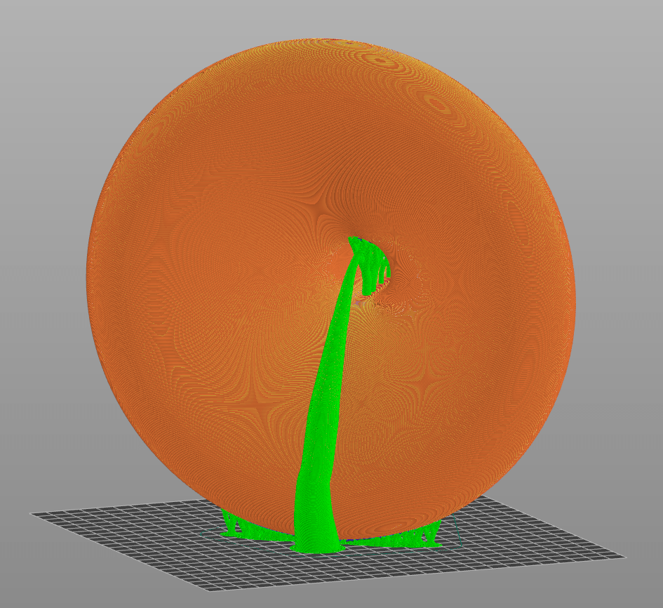

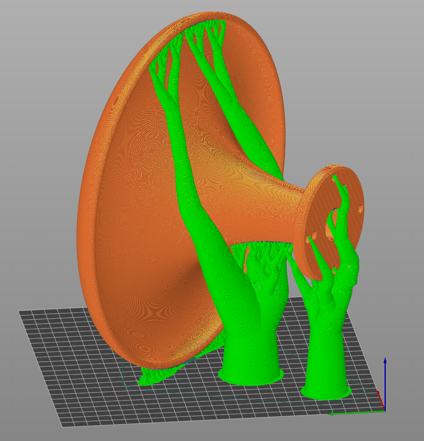

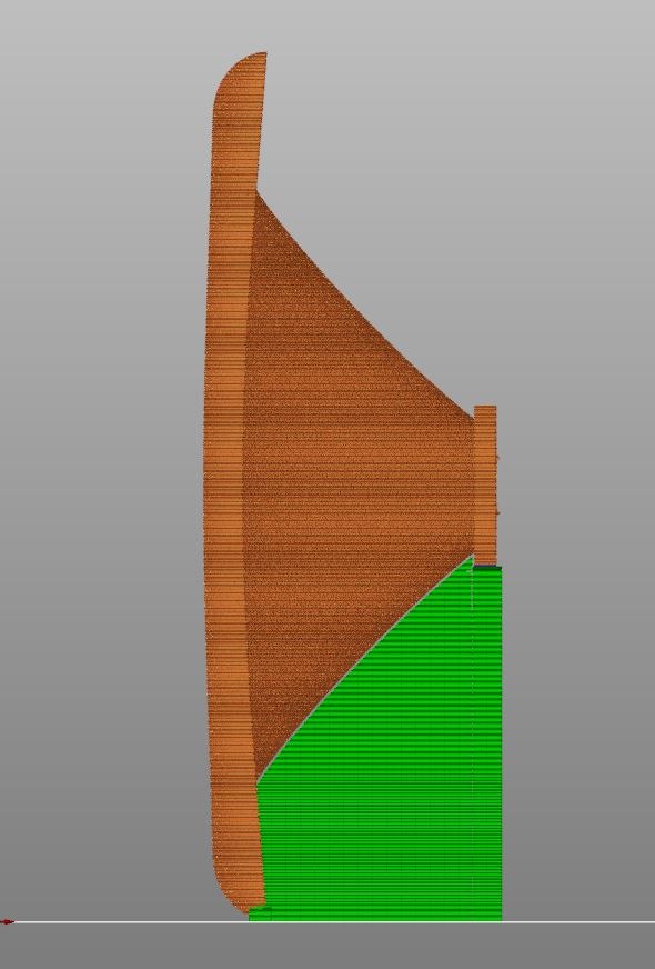

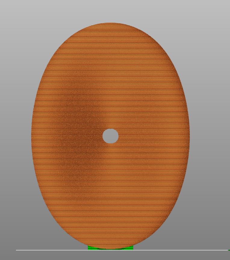

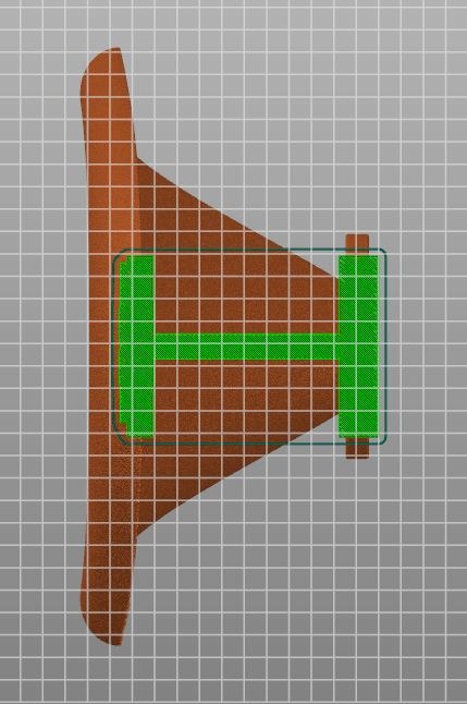

ATH-280EX sliced with organic supports on a 250x250mm bed. Maybe it's worth a try this way.
Reactions: 1 user
It's doable but you would need supports inside the throat -
View attachment 1222151 View attachment 1222152
But the 3D printers are getting better and better..
BTW, all the three variants would take about the same time. I like the first one as there are no supports on the front face.
I print a cap on the back of the throat that I later remove with a tiny saw.
I've found that there are infill patterns which are far more forgiving of overhangs. I need to look up the name of the infill. It looks like a jigsaw pattern.
Someone on Reddit showed something comparable to this infill, which allowed them to nearly print horizontal surfaces with little or no supports.
I use it for nearly everything now. Besides being forgiving, the complex pattern also sticks like crazy on the first layer, which basically eliminates nearly all print failures.

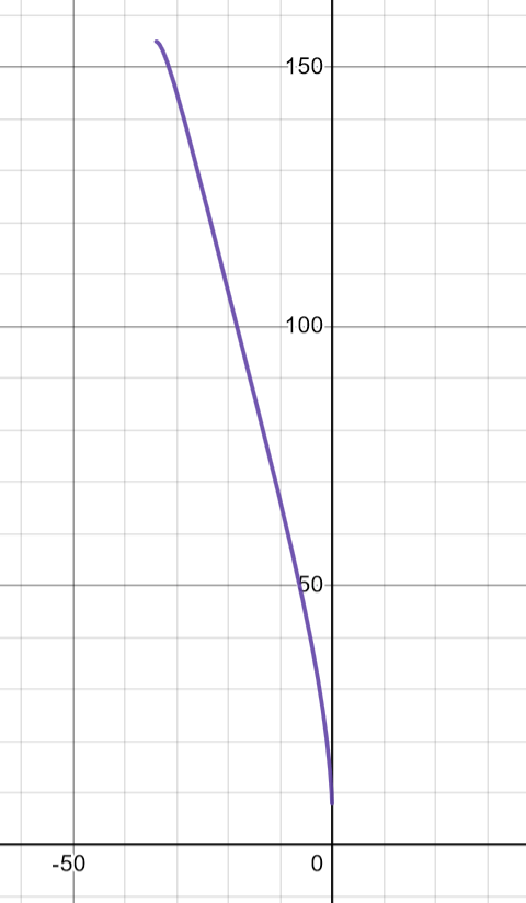

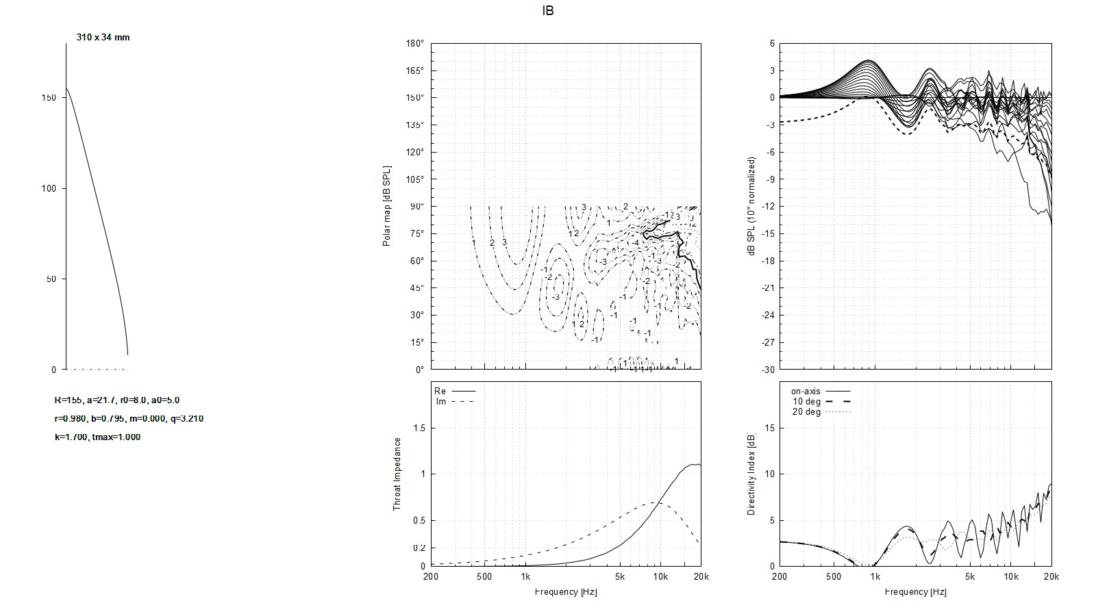

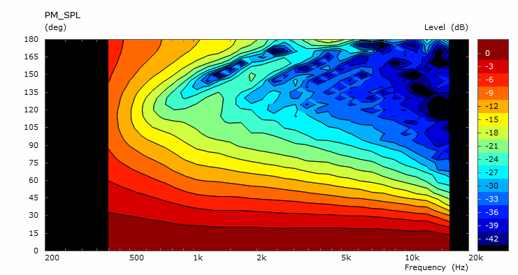

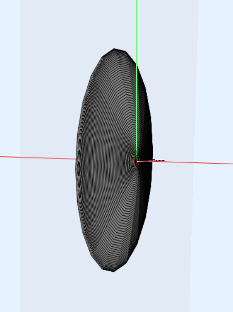

I'm trying to simulate an on-wall speaker with ATH using an R-OSSE profile.
I would expect this to give a very clean response and even dispersion. There will be hardly any reflection off the wall. However, this is the result:
This is the script:
Code:
R-OSSE = {
   R = 155        ; waveguide radius
  r0 = 8        ; throat radius
  a0 = 5        ; throat angle
  a = 21.7        ; nominal coverage angle
  k = 1.7        ; throat expansion factor
  r = 0.98        ; apex radius factor
  b = 0.795            ; bending factor
  m = 0        ; apex relative position
  q = 3.21        ; throat weighting factor
Mesh.LengthSegments = 60
Mesh.AngularSegments = 8
Mesh.SubdomainSlices =
Mesh.WallThickness = 5
Source.Shape = 1
ABEC.SimType = 1 ; 1= infinite baffle, 2= freestanding
ABEC.SimProfile = 0
ABEC.MeshFrequency = 43000
ABEC.NumFrequencies = 100
ABEC.Abscissa = 1
ABEC.f1 = 200
ABEC.f2 = 20000
ABEC.Polars:SPL = {
 MapAngleRange = 0,180,37
 NormAngle = 10
Output.ABECProject = 1
Output.STL = 0
Report = {
Title = IB
Width = 1600
Height = 900
GnuplotCode = rcirc-mono.gpl
MaxRadius = 180
MaxAnglePM = 180
Any idea why this doesn't work?
